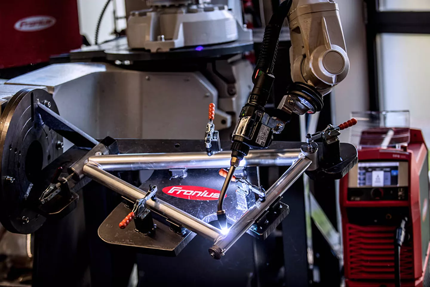

PMC mix drive application example: aluminum bicycle frame (watch video in video section)How much users of the PMC mix drive can benefit is shown using the example of a bicycle frame which is made from aluminum tubes with diameters of 40 to 50 mm and wall thicknesses of 2 to 3 mm. These components are to be joined through automated welding. The Fronius technicians have therefore fitted a welding with a TPS/i 500 and a Robacta Drive PullMig robot welding torch. Welding is performed using the filler metal AlSi (1.2 mm) under 100% Argon (12 l/min) and the pre-set standard settings of the PMC mix drive.The results convince even the most critical of observers. The weld seam is spatter-free and displays the typical weave pattern of a TIG welded joint. However, the robot, at 30 cm of weld seam per minute, is almost twice as productive as a skilled manual TIG welder. As well as the higher welding speed, the ease of handling of the entire TPS/i system, the long service lives of the wearing parts, the robustness of the process and the high reproducibility of the weld also contribute to the excellent cost-effectiveness of the new process variants.
