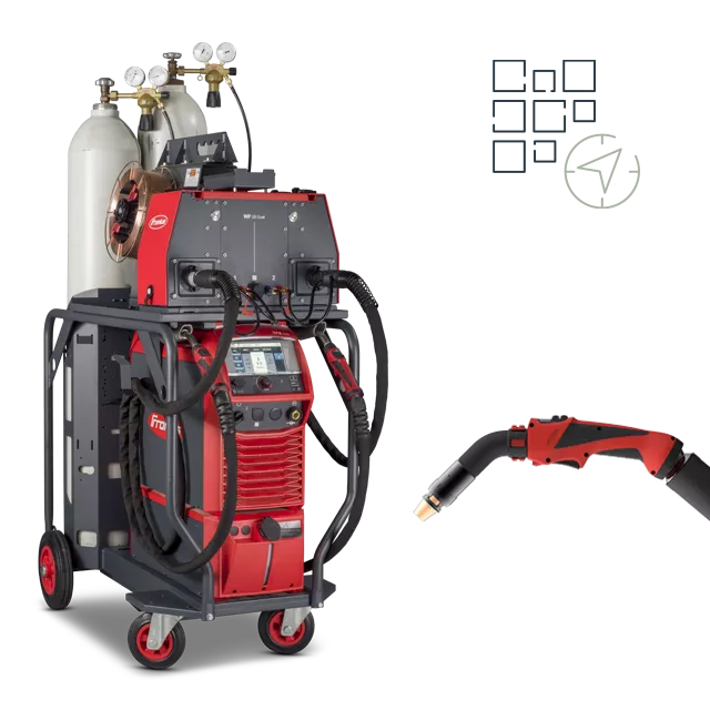

Ready for the future - maximum modularity with the TPS/i Thanks to its modular design and the ease with which the system can be extended, the TPS/i is ideal for a wide range of manual applications.

WF 25i Dual Wire Feeder
Wire change at the touch of a button. The Dual Wire Feeder WF25i Dual as an extension for the TPS/i series.

Trolleys and accessories
TU CAR 4 PRO
2
MIG/MAG welding torches for manual welding applications
Hosepack lengths of up to 16 meters and torch bodies in different lengths and angles simplify everyday working life and give welders the flexibility they need.
