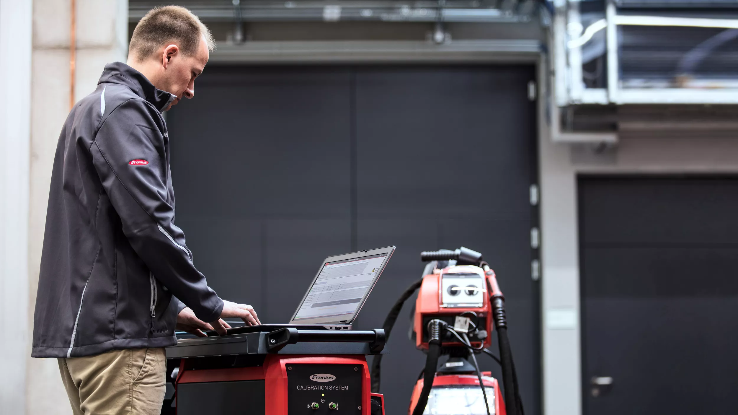

Calibration: guaranteed quality
In order to achieve long-term high-quality and consistent welding results using the welding system, regular calibration is required. In some cases, companies are also subject to standards such as EN 1090 and are therefore legally obligated to carry out regular calibration work.
To do this, the welding system is connected to a calibration station. The calibration software measures voltage, amperage, and wire speed. If the actual values on the machine differ from the set values in the standard and this deviation exceeds the tolerance range, the service engineer can perform a readjustment. In terms of quality assurance and product liability, production can recommence without any problems.
