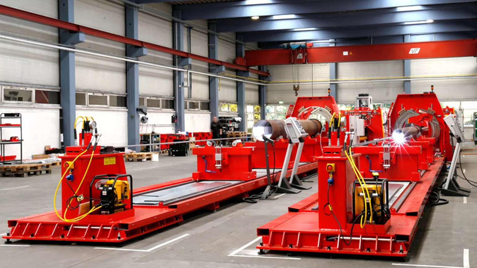

Fronius has been supplying high-quality cladding systems for decades and has become a technology leader in the oil and gas industry. An overlay welding system of the latest generation is the High-Performance Pipe Cladding System, launched in 2018, which allows welding speeds up to 170 cm/min, depending on different values. Its speed is four times faster than the previous Fronius Pipe Cladding system. However, some technicians believe the deposition rate is the major value when selecting a cladding system. Why this is not the case and why the deposition rate is not the only important factor when choosing a cladding system is explained by the internationally renowned cladding expert Alipour Kaveh.

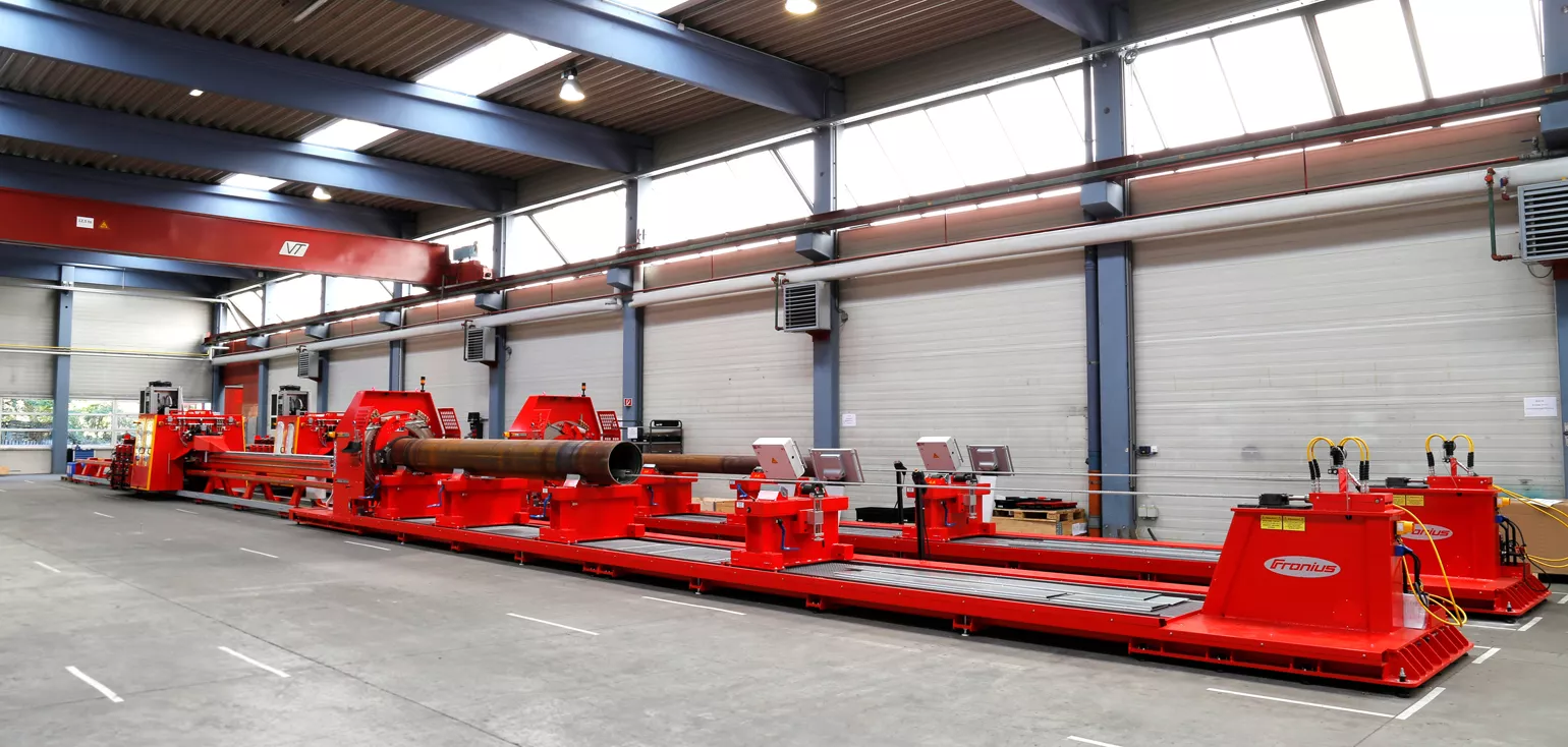

High-Performance Pipe Cladding Cell, front view.

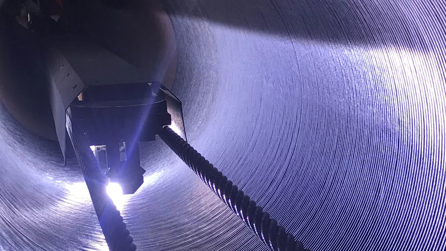

Alipour Kaveh: “Yes, you are right. Fronius Welding Automation developed and manufactured the High-Performance cladding system based on the concept of the heat input formula to increase the deposition rate along with increasing the welding speed, current, voltage and maintaining sufficient heat input during the cladding process with a special gas mixture and a unique shape of the tungsten electrode. The company developed a cladding procedure with this concept as per the requirement of API 5LD to achieve minimum clad thickness in two layers (3.4 mm) and increasing deposition rate more than three times with two torches and twin wire.”
Oil & Gas Innovation: “And the welding speed…?”
Alipour Kaveh: “The welding speed increased from 40 Cm/min to 170 Cm/min (4.25X), heat input in the first layer is 315 J/mm, Hardness of HAZ is equal to the Hardness of base metal, Fe content is less than 5% on 1.5 mm below minimum overlay thickness for Alloy 625. After the cladding process, the mechanical properties of the backing material remain unchanged.”
