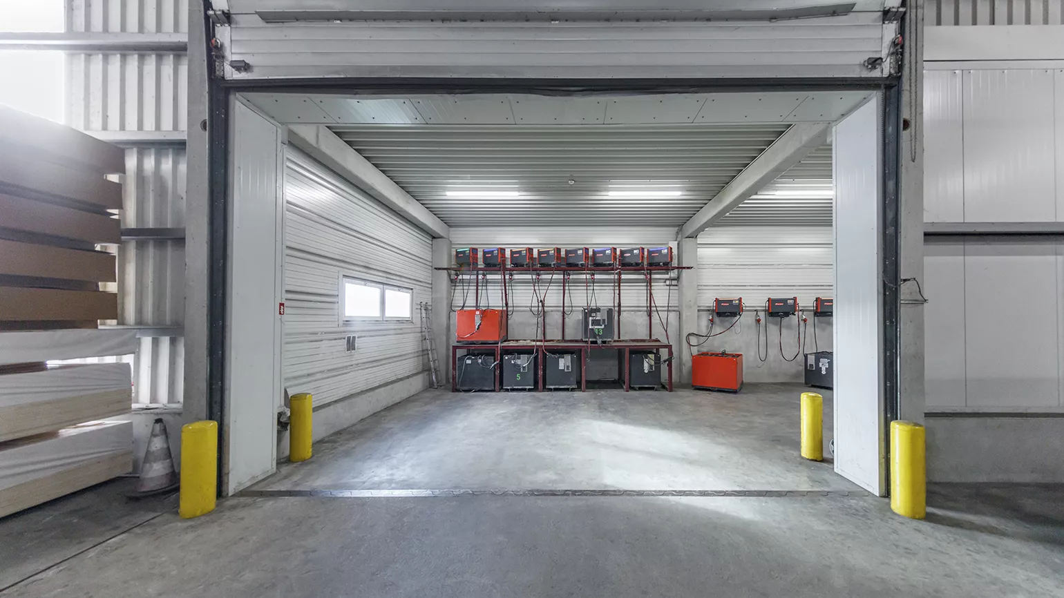

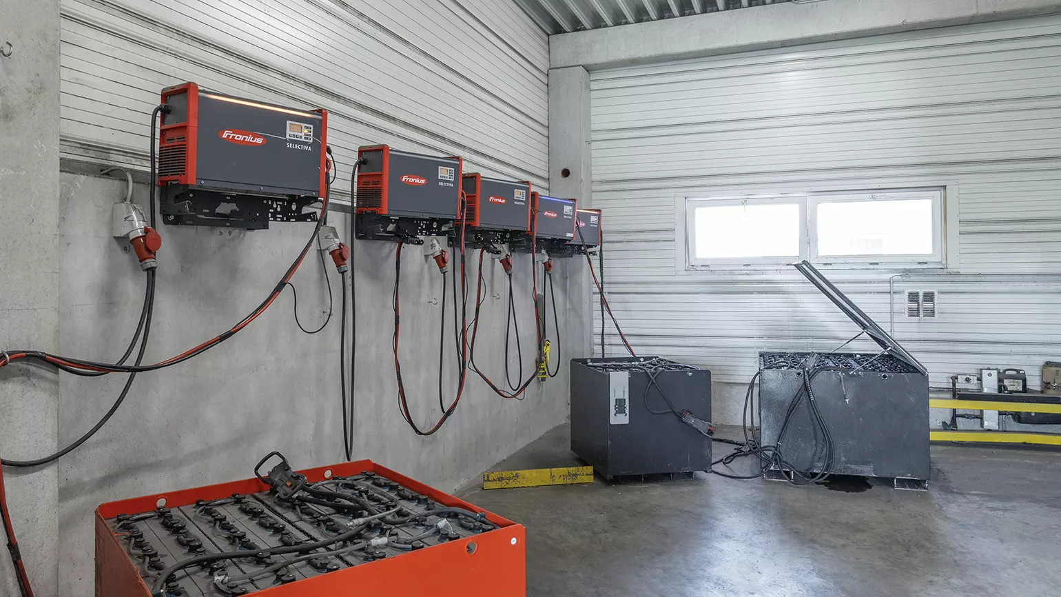

The situation is somewhat different at the central warehouse in Drensteinfurt. Due to long operating times and high utilisation, many of the vehicles require back-up batteries. There are roughly 31 batteries for 16 forklift trucks, which are replaced as required. The charging stations at the Behrens Group are fully equipped with battery charging technology from Austrian specialist Fronius: a total of 101 Selectiva 8120 and two Selectiva 8160 battery chargers supply the timber wholesaler’s forklift truck fleet with energy. “They are a key component of our intralogistics,” emphasises Jedamzik.
The Fronius charging technology allows the Behrens Group to charge forklift trucks at different times and thus avoid load peaks.

In the past, the company had used different high frequency (HF) battery chargers from other manufacturers, which sometimes led to major problems. “We had heavy frequency interference in our grid,” recalls Jedamzik. “This was due to load peaks and harmonics, which occurred when we had connected several forklift trucks to the devices for charging at the same time. The high power consumption at the beginning of the charging phase meant that our IT system crashed regularly and we were always having to call on our technicians to perform special tasks.”
The result was significant limitations regarding operating procedures and unnecessary costs - a situation that the fleet manager did not wish to and was no longer able to longer accept.
Jedamzik discovered the extremely cost-effective and stable Fronius charging technology, which offered a good technical solution and decided to test it out. As early as the testing phase with the first Selectiva devices, the interference was reduced significantly. The in-house developed Ri charging process is responsible for this, which the Fronius battery chargers are equipped with. Compared to conventional processes, this enables steady distribution of the energy demand throughout the entire charging period. The devices also have a special calendar function, which can be used to set charging to start at a defined time. “Fronius charging technology allows the customer to charge forklift trucks at different times and avoid dreaded current peaks, even when several vehicles are connected at the same time in the evening,” explains Matthias Leibold, technical support expert at Fronius Perfect Charging. This solution impressed across the board, and the entire Behrens Group has switched to Fronius charging technology.
