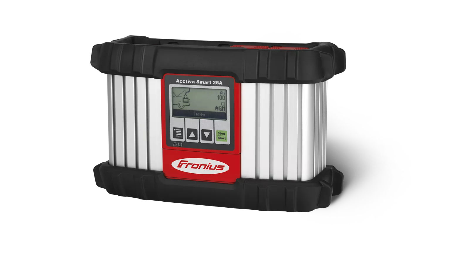

Acctiva Smart 25A
The professional battery charging system for all workshop requirements
The Acctiva Smart 25A professional battery charging system from Fronius is suitable for all batteries (STD, CA, AGM, EFB, Start/Stop, GEL) and applications in the professional 6, 12 and 24V DC range and is ideal for use with motorcycles, cars, HGVs, emergency vehicles, buses, agricultural vehicles and construction machinery.
The charger is characterized by easy handling in mobile use and a large graphic display with animated application steps for easy operation. A special refresh mode for deeply discharged batteries and the software update capability via an optional USB interface make this charger indispensable in your workshop.
