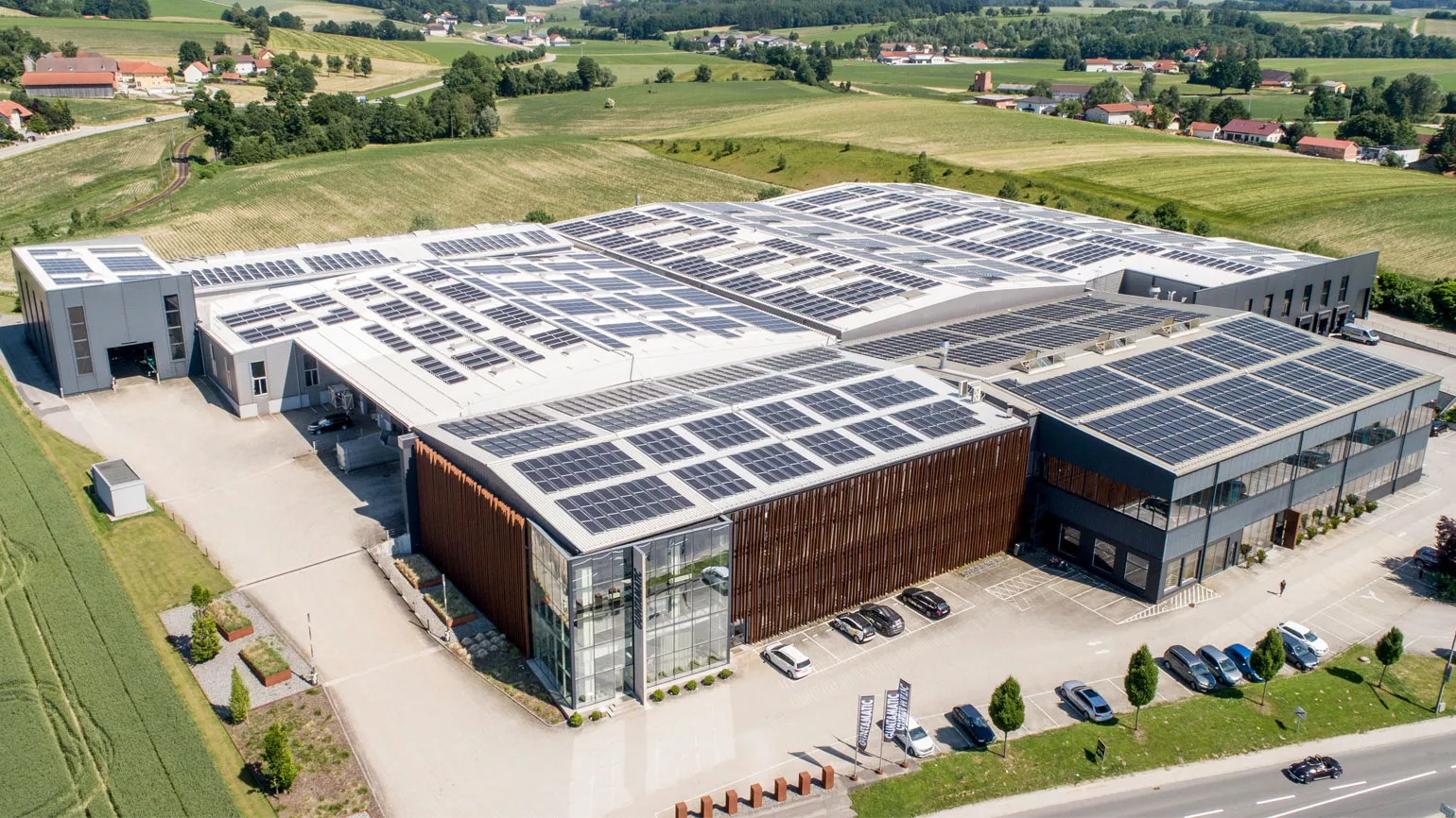

Moving beyond welding technology, Fronius also supports Guntamatic in the area of sustainability. “In light of our corporate philosophy, we place great importance on improving sustainability in the use of energy at our production site. It’s about CO2-neutral production, and, naturally in this context, our attention once again fell on Fronius.”
“The question here was who belonged to the leading suppliers in the area of solar energy, and we are delighted that we are now able to operate our 20,000 m2 photovoltaic system with Fronius inverters.”
