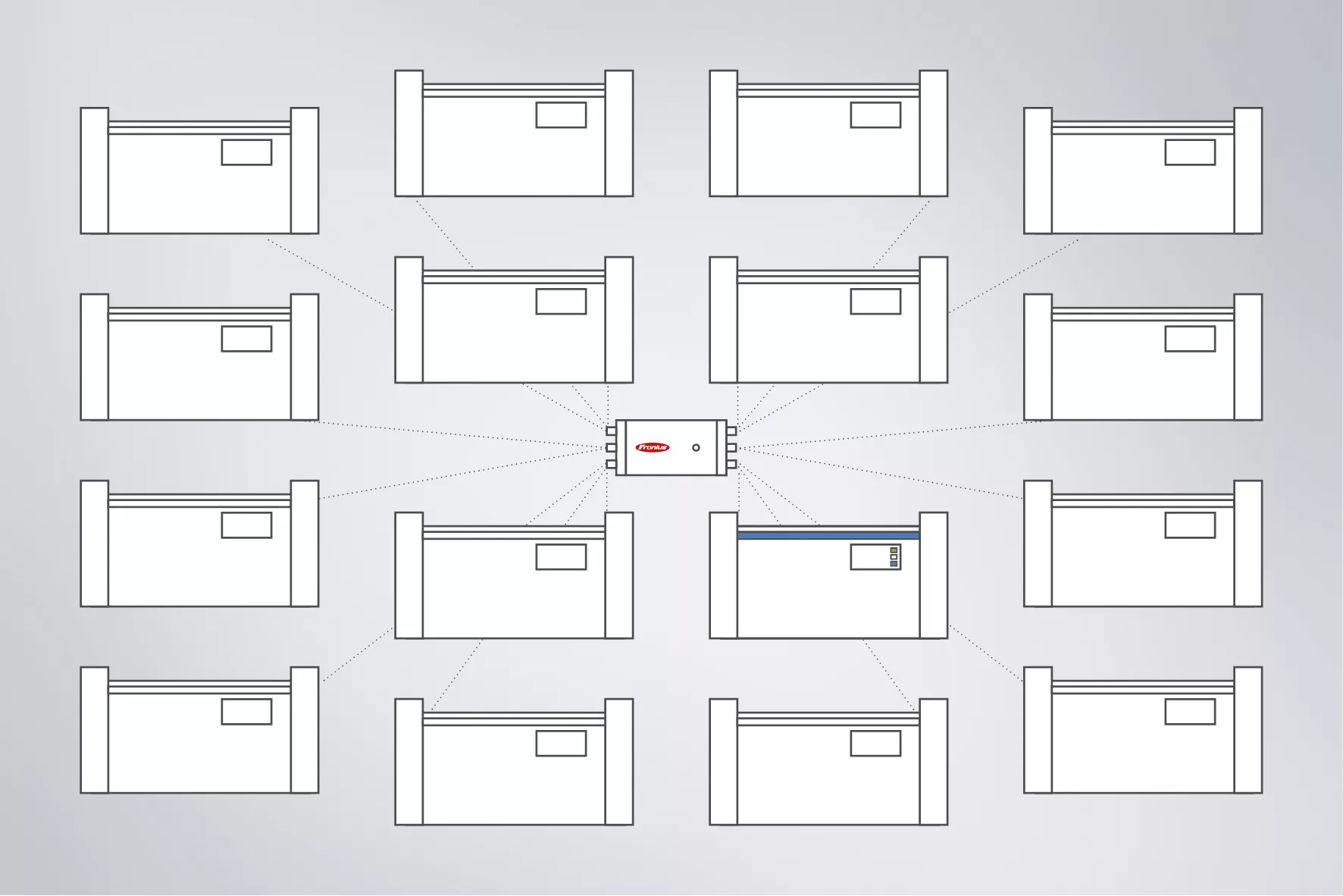

With the “Cool Battery Guide Easy” and “Cool Battery Guide Premium” information and management systems, Fronius has also developed two solutions for optimum utilisation of the battery pool and an extended battery life. A control unit shows the user which battery has been fully-charged for the longest and is therefore the coolest. This can also be indicated by LED strips on the individual battery charging systems, ensuring that all batteries are used equally as often and have enough time to cool down. In addition, the “Cool Battery Guide Premium” enables employees to identify individual batteries and battery charging systems. The system automatically records the relevant data, analyses the charging cycles and logs errors, making battery charging even safer, more reliable and more efficient. Using this data, the user is able to determine potential savings that can be achieved by optimising utilisation of the battery and battery pool.
