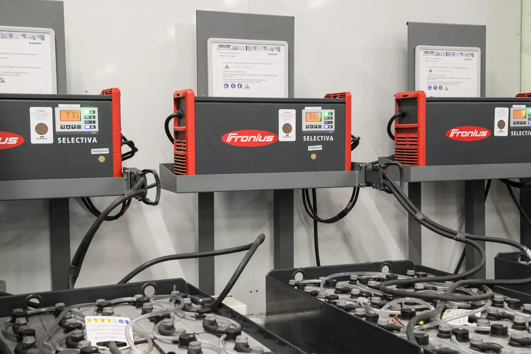

Many of the new battery charging systems equipped with numerous safety features are already in use (Image: Fronius)

Fronius, the Austrian know-how leader in charging traction batteries for electrically powered forklift trucks, has been a developer and supplier of battery charging systems with the highest safety standards for many years. The Selectiva range boasts four power categories and housing variants to provide a complete product portfolio for 2 to 80 V traction batteries. Fronius battery charging systems guarantee maximum efficiency in terms of energy costs and battery life. 100% safety during charging of the battery, ease of use and flexible installation options ensure trouble-free charging processes. All systems are equipped with a voltage-free charging plug and de-energised leads as standard for a spark-free connection. Mains voltage monitoring switches the battery charging system off if the tolerance limits are exceeded. If the temperature of the charger is too high, for example due to high ambient temperatures or insufficient cooling, the thermal overload protection prevents damage to the battery charging system. The safety cut-out detects incorrect charging processes, for example if the charging time predicted by the battery charging system is exceeded or due to faulty battery cells. The Fronius devices are electronic and minimise the risk of oxyhydrogen explosions.

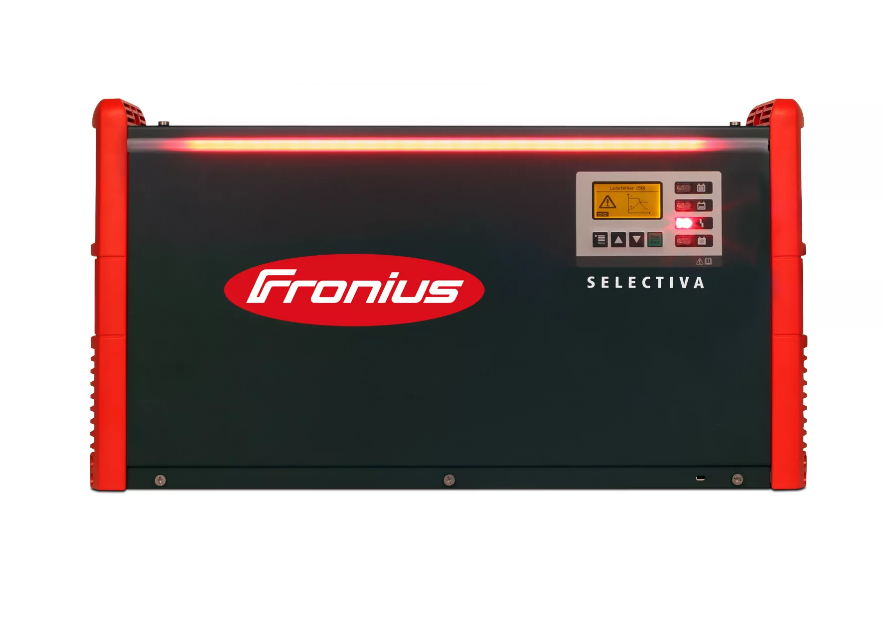

Fronius engineers also turned their attention to various other safety improvements. Additional functions, such as the adjustable start of charging, further reduce peak loads. Even so-called “Monday morning syndrome” can be avoided using a programmable, time-controlled equalising charge that ensures the battery is fully-charged over the weekend and after Bank Holidays. Faults, warnings or even information can be indicated during the charging process by illuminated LED strips or flashing LED indicators. To improve safety, explanatory texts and a service call-out telephone number appear whenever the charger displays an error message.
Yet another safety feature is the optional USB interface, which, in addition to data backup, enables a system update and various analyses of the charging process to be carried out. And it doesn’t end there – reverse polarity protection that prevents incorrect polarity due to the reversal of the plus and minus poles, an intelligent ventilation system that prevents contamination and thus short-circuiting of the battery charging system due to dust particles and a delayed charge end complete the safety functions for the Fronius battery charging systems.

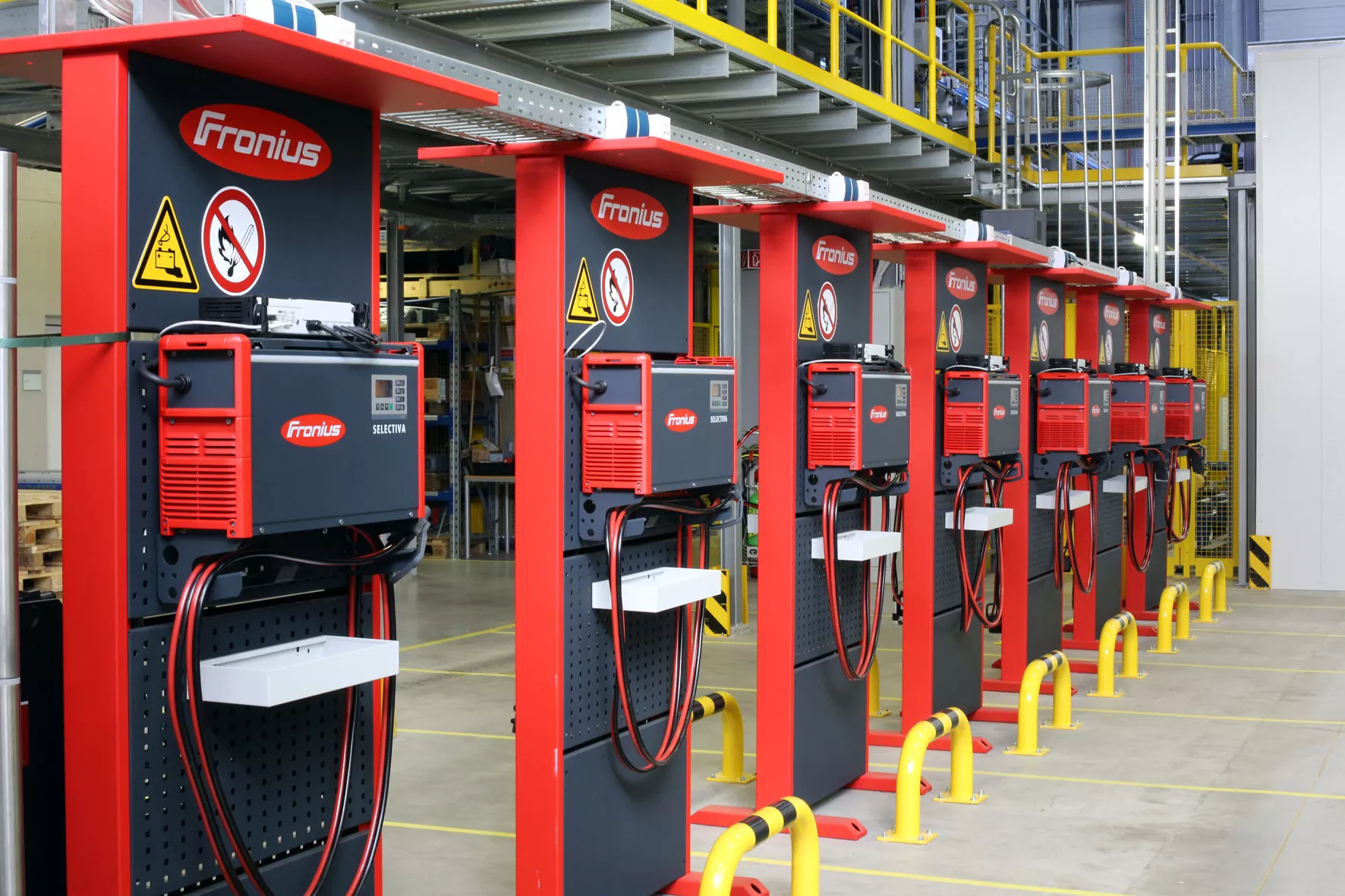

For those who want an absolute guarantee that their charging stations or charging systems comply with all the relevant regulations, Fronius offers complete solutions for the charging of traction batteries for forklift trucks; from analysis, planning and installation to system operation. Fronius supplies battery charging systems that are compliant with standards, have various modules and are available in different designs as required. The modules – fitted with mandatory warning notices – can accommodate one or more battery charging systems. Where space permits, both sides of the modules can be used, saving space. When planning battery charging rooms and installing the systems, Fronius always ensures that the safety clearances to flammable objects, and particularly to hazardous areas with a fire or explosion risk, are observed and that the correct markings are applied to the floor and to the wall. The specially developed safety module comprises a first-aid box, a fire extinguisher, an eyewash kit and a printed copy of the safety rules. The safety module can be tailored to satisfy the regulations laid down by individual companies.
