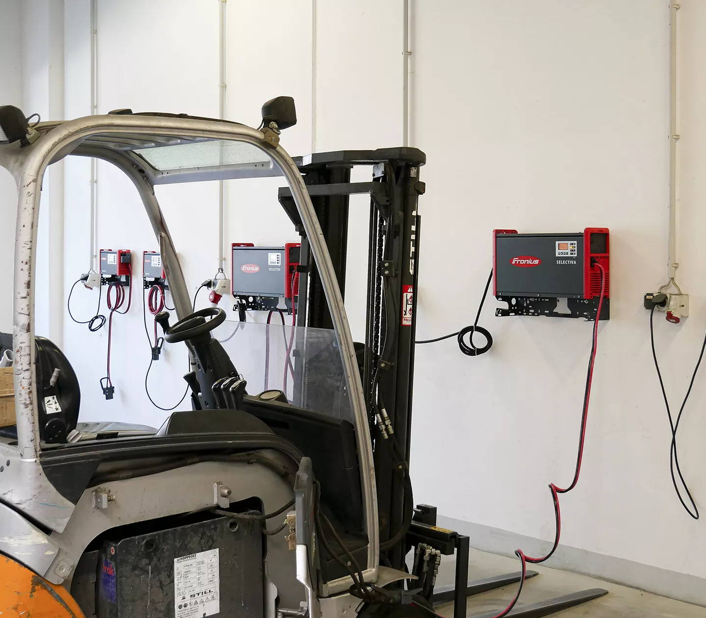

The existing battery charging technology for the electric forklift trucks was a real thorn in the side of the S:FLEX managers. The trucks were being operated with outdated 50-Hertz transformer technology, which was causing high energy losses during charging and damaged the expensive traction batteries in the long term. “During this process, a considerable proportion of the energy used is converted into heat,” explains Logistics Manager Heico Dretke. “This increases power consumption and operating costs, and reduces the capacity and performance of the batteries.” More frequent opportunity charging and battery changes are the result. “We wanted a more modern technology that would eliminate these disadvantages.”

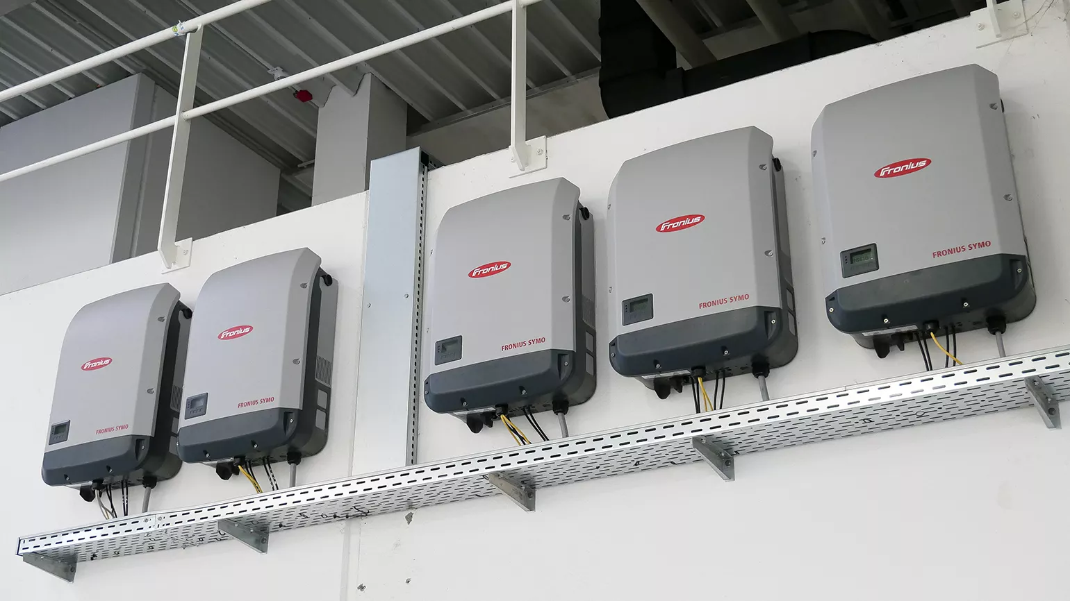

Since May 2020, five three-phase Fronius Symo inverters have been converting the energy from the solar collectors on the roof of the S:FLEX site into usable alternating current. Their sophisticated design with the unique SnapINverter technology simplifies installation and maintenance immensely. In addition, the devices are equipped with extensive communication functions that enable dynamic feed-in management and clear consumption visualisation. The inverters are connected to the Internet, and numerous data can be easily accessed via a computer or smartphone with Fronius Solar.web. “This makes the entire system extremely transparent and easy for us to control,” says Logistics Manager Dretke.

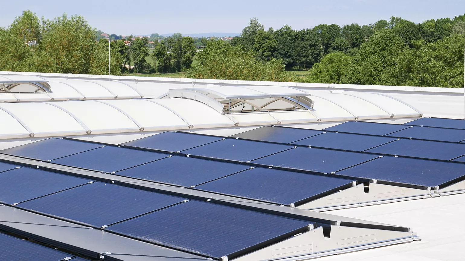

The photovoltaic system generates around 100 kilowatts of power at peak times. A large part of this is fed directly to the Fronius Selectiva battery chargers via the electricity supply network on site. Six of these are available to forklift drivers in different power categories, depending on whether the forklift trucks have larger or smaller traction batteries. With their innovative Ri charging process, they flexibly charge the different types of batteries – and do so in a particularly gentle and energy-efficient manner: “The charging process adjusts itself individually to the age, capacity and condition of each battery, thus reducing harmful overcharging to a minimum,” says Fronius expert Horn. The result is significantly lower energy consumption and a longer battery service life.

S:FLEX is highly satisfied with the overall package from Fronius. “The battery chargers are easy to use. All our staff need to do is plug in the charging plug; no further adjustments on the device are necessary,” explains Dretke. Surplus energy from the photovoltaic system is fed into the public grid, and thanks to the Fronius system’s extensive analysis functions, S:FLEX is always up to date with all production and consumption data. “This combination of photovoltaic and battery charging technology is certainly unique on the market,” enthuses Müller-Maerz. “With Fronius, we have been able to significantly reduce our electricity requirements and operating costs, while at the same time making our intralogistics more sustainable.” The Austrian company is also a reliable partner when it comes to service requirements. “We are very happy to receive everything from a single source and to always know who to turn to when we need it,” sums up the Managing Director. “It makes the working relationship easier and much more pleasant.”
