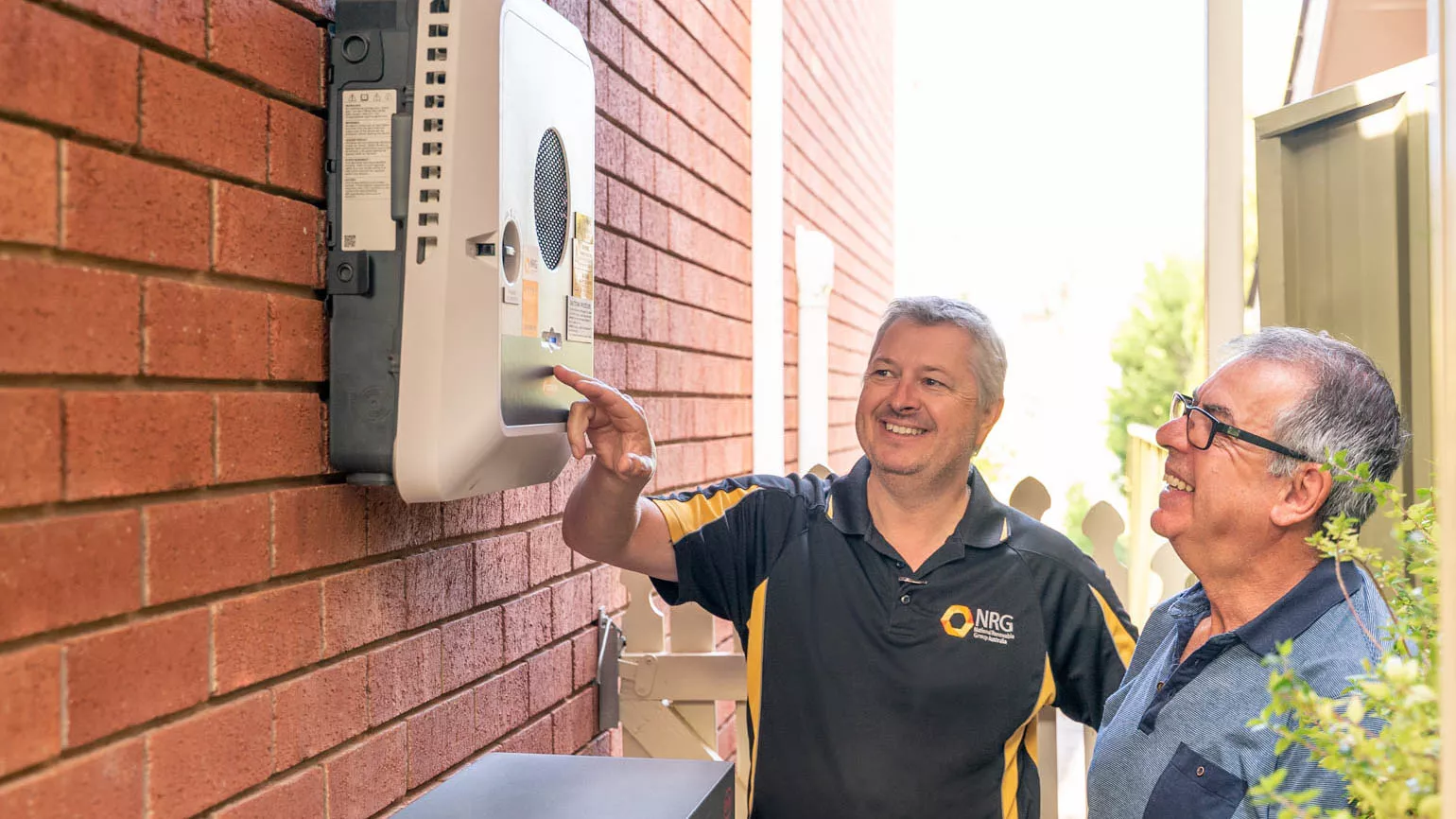

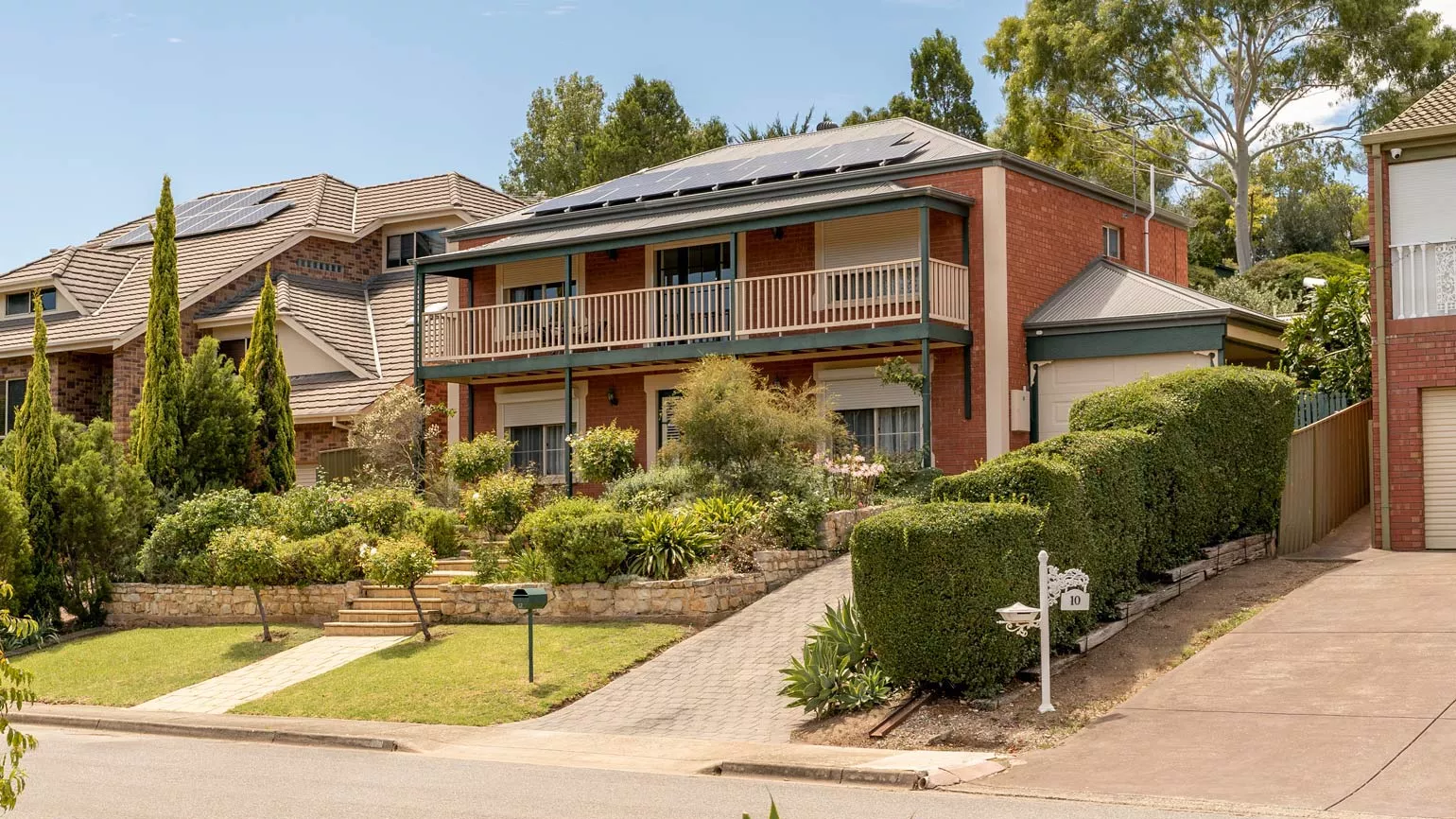

Rino lives in the south of Australia with his family. When it came to choosing a PV system, he was seeking independence and energy security, as well as wanting to do something for our planet. In addition, Rino needs to always be able to keep an eye on his system, to maximize his self-consumption, and minimize the amount of electricity he has to buy from the grid.
To meet these needs, Eddy May from FSP NRG Solar advised Rino to opt for a storage solution with the Fronius Primo GEN24 Plus and the BYD Battery-Box Premium
Maximum independence thanks to Full Backup and expandable storage system
Energy security is particularly important to Rino. Thanks to the Primo GEN24 Plus and the BYD Battery-Box Premium, he and his family are not dependent on the grid as they have reached almost 100% energy autonomy
The single-phase hybrid-inverter offers flexible backup power options. Depending on individual needs, the integrated basic backup power supply or the enhanced backup power solution is available. The latter, i.e., a Full Backup solution, was selected for Rino’s PV system. This works in combination with his storage system and supplies both single and three-phase loads throughout the entire home.

The installer from NRG Solar specifically opted for a 6 kW hybrid inverter, as the peak power of the PV generator is not reached in the majority of cases and he can oversize the GEN24 Plus up to 150% with the SuperFlex Design. This makes optimum use of the inverter power.

As FSPs, Eddy May and his colleagues benefit from the close link to Fronius. They are able to guarantee their customers the most professional advice and the best service by participating in regular training sessions on Fronius products
Solar.web, the Fronius monitoring platform, made it very easy for Eddy to explain the advantages of a PV system with solar storage system to Rino. The practical Solar.web app allows the installer to convey the potential savings of PV to their customer using existing systems as examples, and thereby gain the customer’s trust.

Rino feels well informed and looked after – Solar.web allows him to keep an eye on all the energy flows in his system at all times. Should servicing or repair be needed, the app indicates this and Rino knows that Eddy, as an FSP, will be at his side with the best service on the market.
Thanks to the BYD battery, he is able to use almost 90% of his PV energy himself on sunny days. What is more, the consumption of his air con system is in perfect harmony with the PV generation, allowing maximum self-consumption rates to be achieved.
