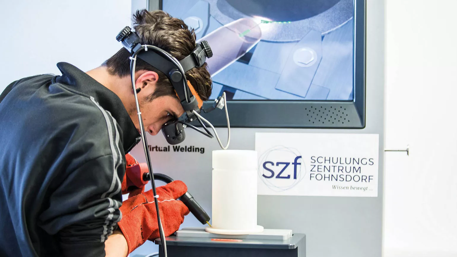

The Virtual Welding system allows users to learn and practise the use of various welding processes in a virtual reality (VR) environment. The currently available processes are manual arc welding, gas metal arc welding (MIG/MAG ) and, a recent addition, tungsten inert gas welding (TIG). Single-V butt welds, fillet welds, square butt welds, pipe joints and overlay welding can all be practised in various positions using plastic workpieces attached to the stand-up terminal. A welding torch is used to create a seam that is displayed in real time on the simulator’s touchscreen display and the 3D glasses worn by the user.

“Ghost”, the virtual trainer, is a huge asset when learning how to handle the torch. It shows the path the torch should take and indicates the correct speed, angle and distance between torch and workpiece, giving direct, visual feedback when the student starts to drift away from one of the set values. At the more advanced levels, welding is unguided, in other words the Ghost does not show the correct torch path. However, even here it offers support in the form of a playback function in which users can see not only their weld, but also review the complete welding operation. Feedback is provided by displaying the torch path taken by the user and the recommended one at the same time so they can be directly compared.
The one-on-one training facility and the ability to carry out “virtual practising” has transformed welding training in Fohnsdorf. Instead of imparting the basic skills and practising torch guidance using real devices from the very beginning, the students can first learn from simulation, resulting in savings in resources and costs as consumables are not required. The risk of injury is also reduced, as students are trained in how to handle the torch before being confronted by high levels of heat and a dazzling arc. “Each new task is first practised in a virtual environment before being tried out in earnest,” explains Zuber. Virtual welding helps save time, as there is no need for any pre- or post-processing of workpieces during the initial stages of learning a new process. The Fohnsdorf Training Centre uses the time saved to intensify the training, for instance to carry out more exercises and weld more demanding workpieces.
