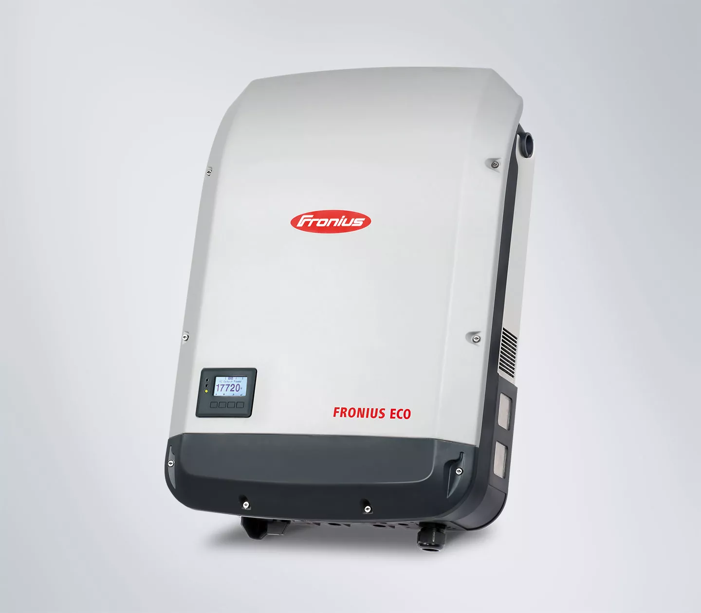

The solutions provider Fronius is launching the latest addition to the SnapINverter range in May 20151. Available in the 25.0 and 27.0 kVA power categories, the Fronius Eco string inverter delivers maximum yields, especially for large-scale PV projects into the megawatt range.
Thanks to the exceptionally high IP 66 protection class, the device can be installed in unsheltered indoor and outdoor locations.
“The Fronius Eco is the ideal project inverter. It is easy to service, extremely cost-effective and offers the high quality associated with Fronius,” explains Martin Hackl, head of the Solar Energy Division at Fronius International GmbH.
The compact design ensures maximum average power density and maximum yields
Its lightweight design (weighing just 35.7 kg) and tried and tested SnapINverter mounting technology make for quick and easy installation. With the highest average power density in its power category, the Fronius Eco is sure to impress.
The new MPP tracking algorithm of the Dynamic Peak Manager also plays an important role in maximising yield. It automatically checks the characteristic curve at regular intervals, ensuring that the inverter finds the global maximum and constantly operates at the point of maximum output, even in partial shading.
Unique advantages for commercial projects
The efficiency level of 98.3 percent is unique in the project area. Another highlight is the ability to connect up to six strings directly to the inverter, meaning that the system operator no longer requires additional DC or combiner boxes. The integrated fuse holder provides all-pole fuse protection for all six strings, and optional overvoltage protection is available for the DC side.
Thanks to the exceptionally high IP 66 protection class, the device can be installed in unsheltered indoor and outdoor locations. The Fronius Eco even manages to deliver maximum yields under extreme climate conditions. Due to the SnapINverter technology2, the lowest servicing costs can be expected. The optimised display navigation simplifies servicing, while the Setup wizard saves time and money.
