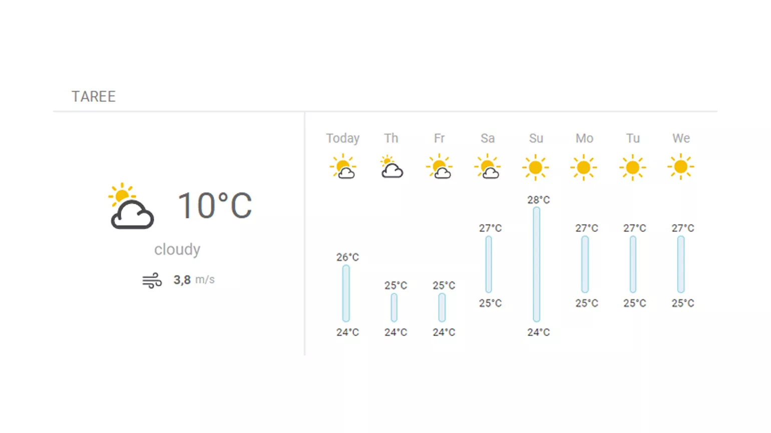

Thomas: I find the weather widget particularly fascinating, as it can show me a rough estimate of my PV yields for the following day. This enables me to switch on electrical appliances that use a lot of power in a more targeted manner and therefore save money. For example, it often doesn’t matter whether I do my laundry today or tomorrow. So, if the sun is going to shine tomorrow, I’d rather use my own solar power for it.
