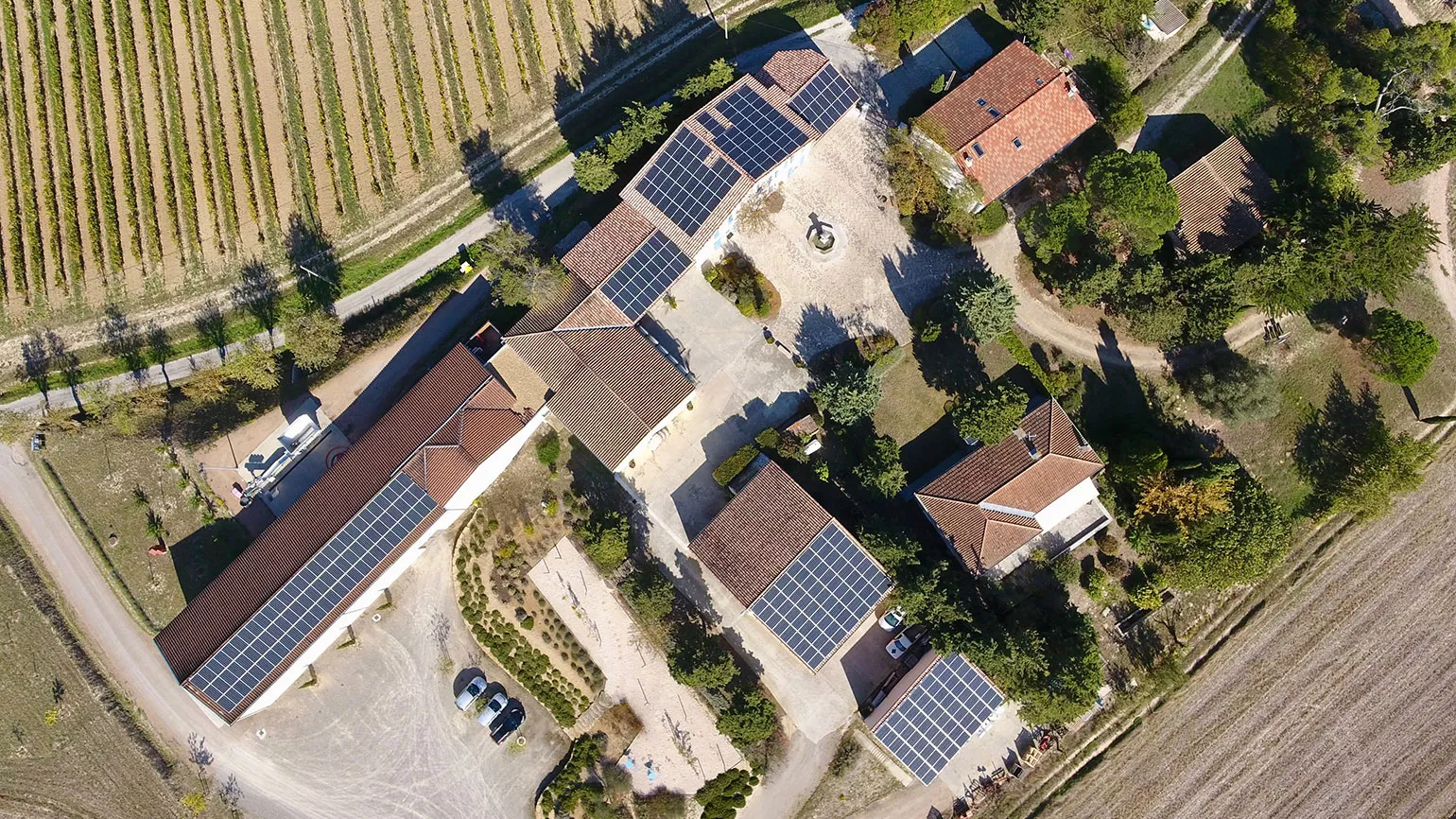

The owners of the “La Louvière” vineyard in the south of France use photovoltaic electricity to cool their wine and keep it at the perfect temperature. With outdoor temperatures rising to +40°C in the summer, the energy needs of this agricultural enterprise are well above average. A 100 kWp roof-mounted photovoltaic system allows them to generate the majority of their power needs themselves.
A PV system despite challenging roof orientations
Fronius System Partner Jean-Marc Panizza installed the PV system on seven different roofs at the vineyard, oriented towards three points of the compass. Despite this unusual configuration however, the Superflex Design of the Fronius Symo inverter means that optimum yields are still generated.
The SuperFlex Design allows for flexibility in system planning
The three different roof orientations of the PV system at the vineyard demanded a high level of flexibility in terms of the inverter. The two MPP trackers allow far greater flexibility in how the Fronius Symo inverters are used. The Dynamic Peak Manager means that, even in partially shaded conditions, as is often the case with this type of system, there is no loss of yield. The Dynamic Peak Manager is a shading-tolerant MPP tracking algorithm that does away with the need for a power optimiser in many cases.
Installer Jean-Marc Panizza says about the installation conditions: "The roof-situation at the winery was quite challenging. Here we have 7 different roofs in 3 orientations. We used the Fronius Symo inverter to fix that problem. Thanks to its Superflex design such an installation is possible and the system owner still earns the highest yields. The Fronius technology made is possible, that I could do the installation alone. This helped me to save on installation costs.” More information on the Fronius Symo inverters

  • System size: approx. 100 kWp
  • Fronius products: 8 Fronius Symo inverters
  • Special feature: Installation on 7 different roofs, 3 different points of the compass, 3 different types of roof structure
