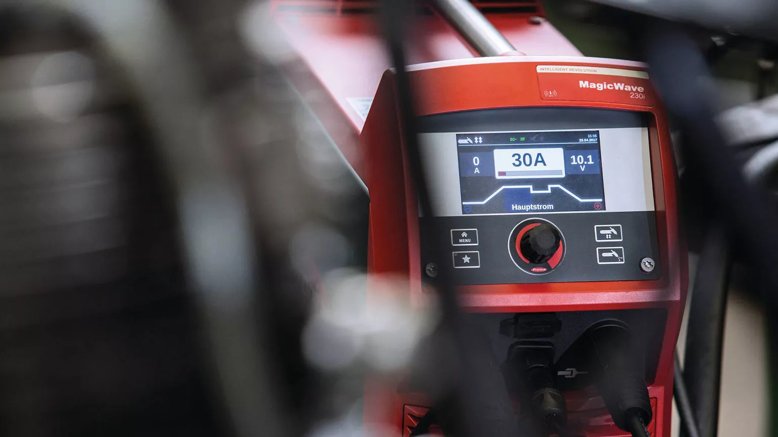

MagicWave
The first Fronius power source that can connect to other devices via Bluetooth, WLAN and NFC technology.
