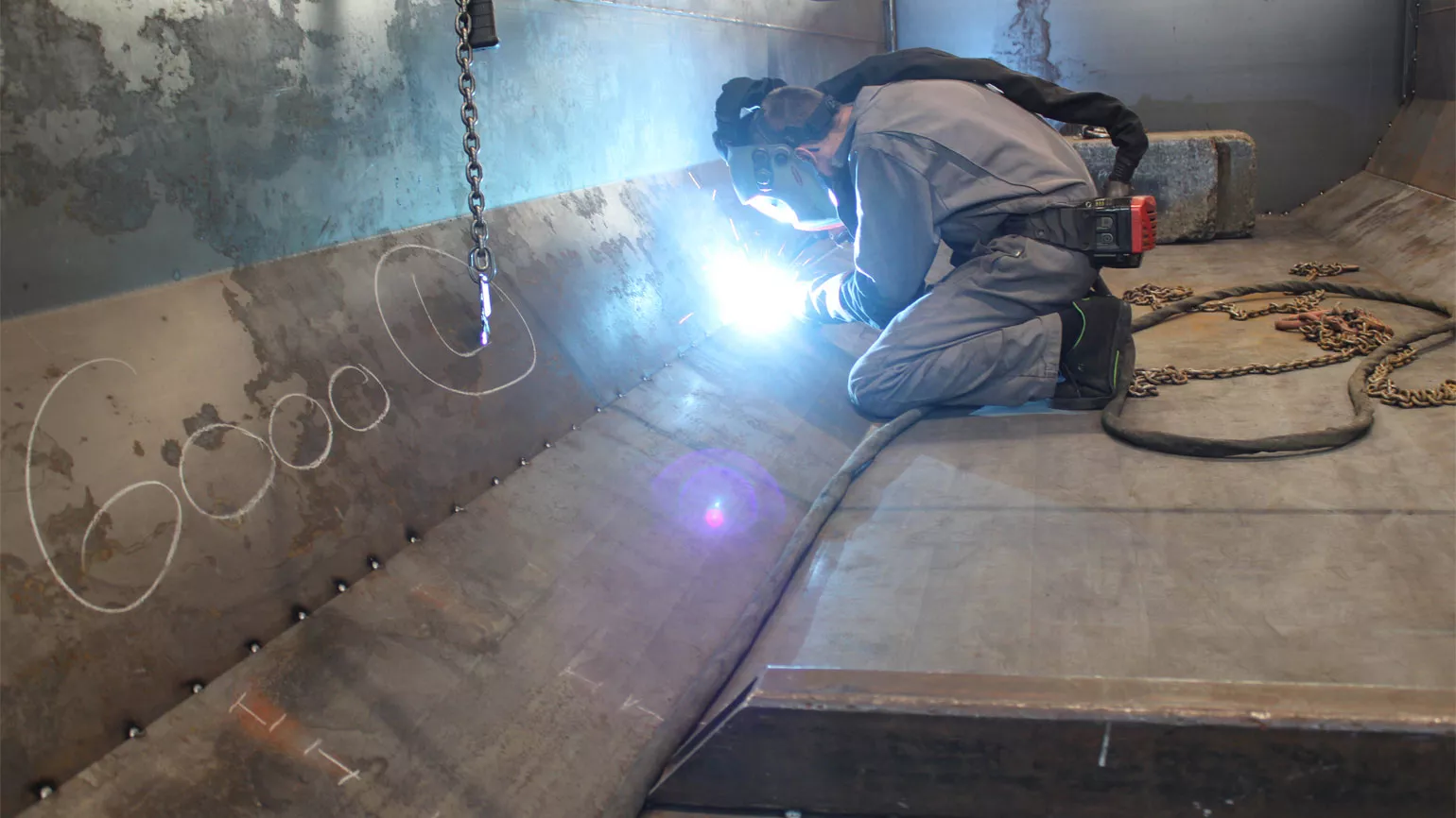

Focus on MAG manual welding – frequent out-of-position welding
The vast majority of welds at Moser AG are welded manually using the GMAW process. In addition to considerable welding speeds, this process delivers high deposition rates, while relatively little energy per unit length is input into the dumper parts to be welded.
For series production parts or repetitive processes, such as welding the subframes of the dumper bodies, a gantry system with a welding robot is used in Steffisburg. The gantry system makes it possible to turn the entire dumper so it is in the appropriate welding position.
 “The characteristics of the weld are provided by the WPS. For the thicknesses of the fillet welds, we generally adhere to the A dimension, i.e., the thickness of the thinnest sheet element multiplied by 0.7,” explains Stefan Rolli.
To withstand the high loads in day-to-day use on construction sites, many welds are welded with a root pass and up to two final runs. In addition to fillet welds, butt welds – with and without an air gap – are also very frequently used. One task that the welders at Moser AG are regularly confronted with is out-of-position welding: from “classic” vertical-up seams on the pipe and sheet metal to overhead welds.

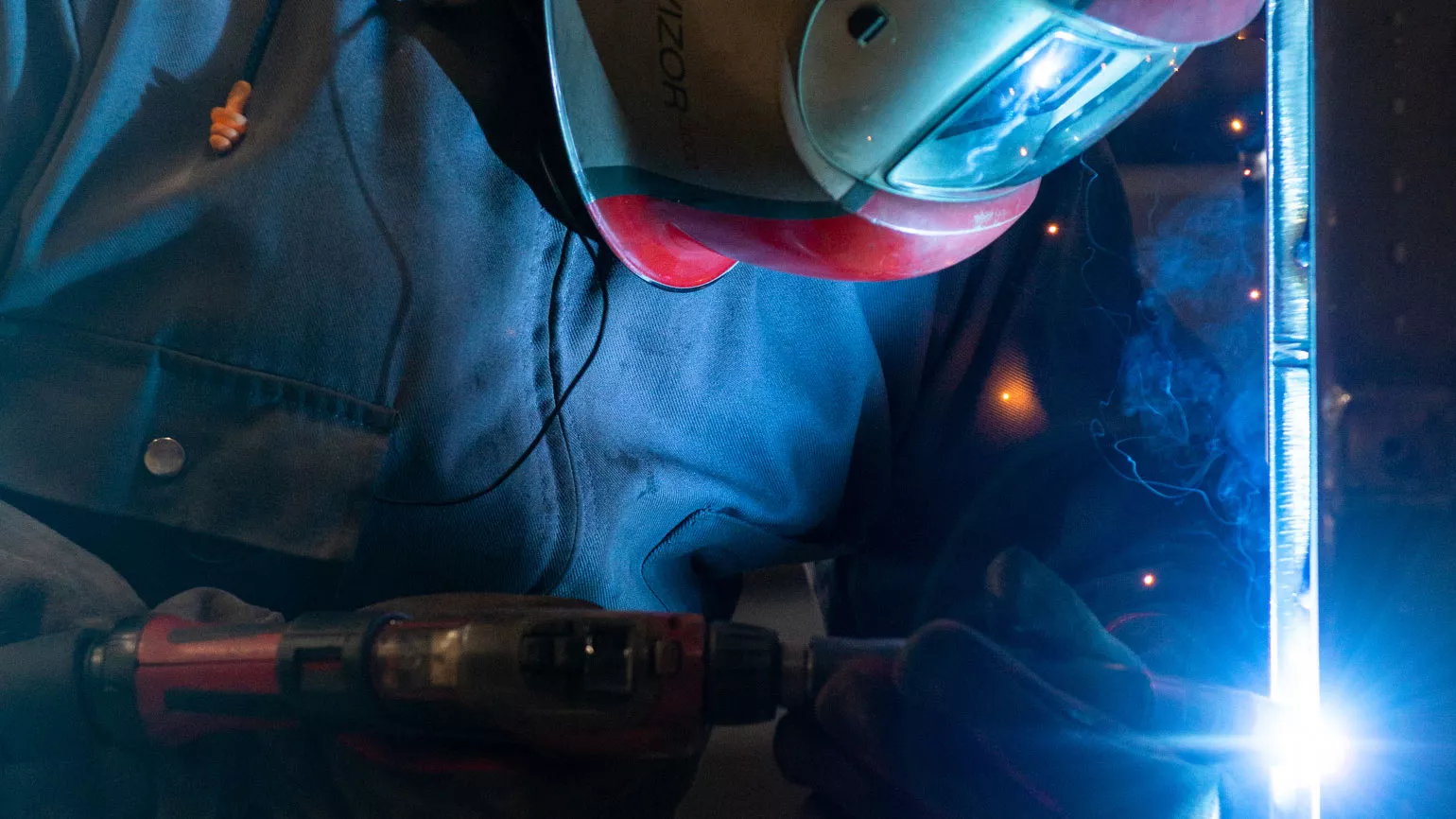

Up to 40 percent faster welding of vertical-up seams
The welding specialists at Moser AG use the PMC Mix characteristic, among others, because it permits the welding of vertical-up seams without the usual oscillating motion. Overall, up to 40 percent faster welding speeds are possible with the PMC Mix process for vertical-up seams. The technical basis for this characteristic is the process change between a pulsed and dip transfer arc, i.e., the cyclical change between a hot and a cold supporting process phase. The heat input into the material is reduced by this process.
Steel Root is another characteristic that is often used by the welding specialists at Moser AG. This characteristic excels at bridging gaps of 2 to 3 millimeters in size when welding dumper parts. A soft and stable arc is a typical feature of the Steel Root characteristic. The detachment of relatively large droplets creates a viscous weld pool, which can be used to weld larger gaps with ease.
The PMC Dynamic welding characteristic is used at Moser for horizontal fillet welds. It delivers a relatively aggressive arc with high pressure and concentrated focus. Your advantage: High welding speeds with low energy input enable low-distortion welding results and save valuable resources such as gas, filler metal and working hours.
