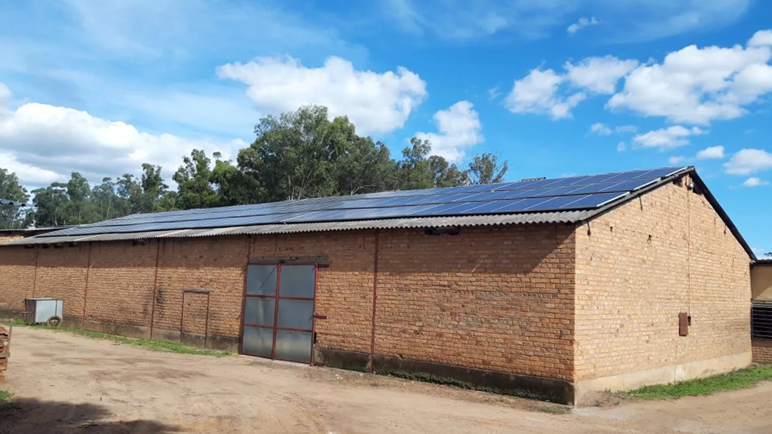

To counteract regular power outages, the owners of a tobacco farm in Zimbabwe have been using a diesel generator for several years.
Mass Kirk, owner of the tobacco company says: „In addition to the high fuel costs, the frequent diesel shortages were one of the reasons why we upgraded our diesel generator with the addition of a PV system. Since solar power is much cheaper and can also be planned over the long term, we will shortly be expanding our PV system to 80 kWp.“
The company thus saves an average of 100 litres of diesel per day.
PV-Genset system pays off within a few years
Muhammed Seedat, Technical Consultant at Fronius, explains: „During the day, the owners of the tobacco factory are able to cover a large proportion of their energy requirements with solar power, both in the high and the low season. If less tobacco is produced, the farm feeds more energy into the grid. The owner thereby has an additional source of income and becomes a „power farmer“. He uses less diesel and saves thousands of euros annually. Thanks to these savings, the system will have paid for itself within a few years.“

About the system:
Type of system: Fronius PV-Genset Easy
System size:
Currently 45 kWp PV system
Can be expanded with additional 35 kWp
150 kVA Genset
Components used:  3 x Symo 15.0-3-M in combination with a Fronius PV System Controller
Annual yield:  Approx. 80,000 kWh
Savings:  100 l daily diesel savings
