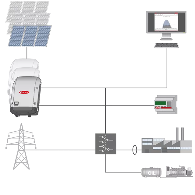

How a solar diesel hybrid system works
Photovoltaic modules Modules can be mounted on large roofs or in open spaces and generate solar power when exposed to the sun. This electricity must be converted from direct current to alternating current before it can be used. The inverter is responsible for this.
1
Inverter The inverter is the control centre of every photovoltaic system. It converts the generated direct current into alternating current and provides the self-contained network (MicroGrid) with as much solar power as possible.
2
PV system controller The Fronius PV System Controller measures all energy flows in the PV/diesel system, enabling it to control the photovoltaic power in the most optimum manner.
3
Diesel generator The diesel generator is the primary energy source for solar/diesel hybrid systems. The more solar power can be generated, the lower the fuel costs.
4
Loads The loads are supplied with a mix of solar energy and fossil energy through the combination of a diesel generator and photovoltaic system.
5
Current sensors The current sensors are connected to the PV system controller and measure the power in the system.
6
Backup feedback contact The feedback contact (grid supply) facilitates the operation of the photovoltaic system – optimally adapted to any energy fed into the grid or parallel generator events.
7
Grid A connection to the grid can be available at least temporarily.
8
1
2
Inverter
3
4
Diesel generator
5
Loads
6
Current sensors
7
8
Grid
