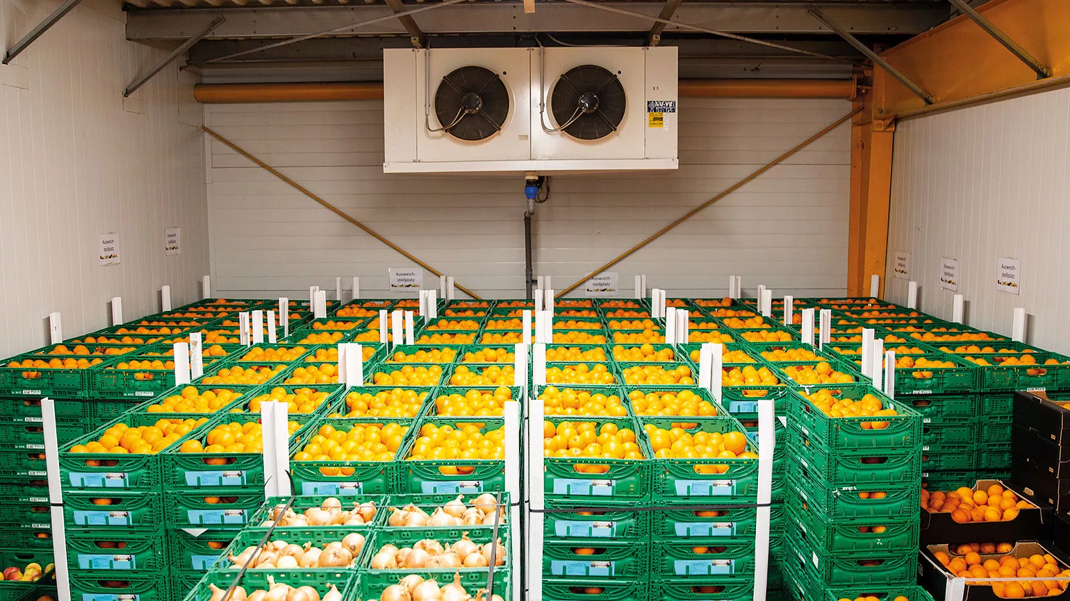

Mr Pichler from Biohandel in Austria was tired of handing over tens of thousands of euros to the energy supplier every year. Its main business area – trading in organic fruit and vegetables – requires an enormous energy capacity for cooling the goods. With the installation of a PV system on his own warehouse, Mr Pichler saves 10,000 euros a year in energy costs.
The system pays for itself extremely quickly: the system will have already covered its costs after five years. Everything after that is profit.
Rooftop photovoltaic system for companies
“We have the greatest need for electricity when it is warm outside - normally when the sun is shining. Especially in summer, the difference in temperature between outside and inside can be as high as 35°C. That costs a lot of money. When we expanded our warehouses a year ago, our installer gave us the idea of using the roof surfaces for a PV system,” says Gerhard Pichler about the origins of the PV system.

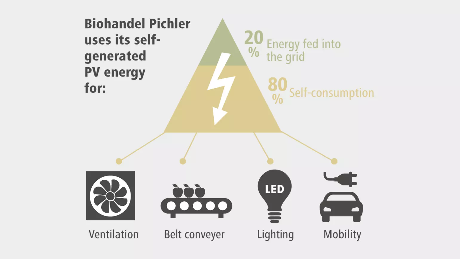

The photovoltaic system was implemented in such a way that the highest possible proportion of the energy consumption of Biohandel can be covered by the PV output. Over 100,000 kWh of green electricity is produced annually by the PV system, of which the company can use an average of 80% itself. The largest loads in this case are the cooling systems.
According to Mr Pichler, „We can cover the largest part of our energy costs with the PV system. After only one year of use, we have already seen that we have generated a higher yield than originally anticipated. If we look at the investment costs, these will have already paid for themselves after five years.“

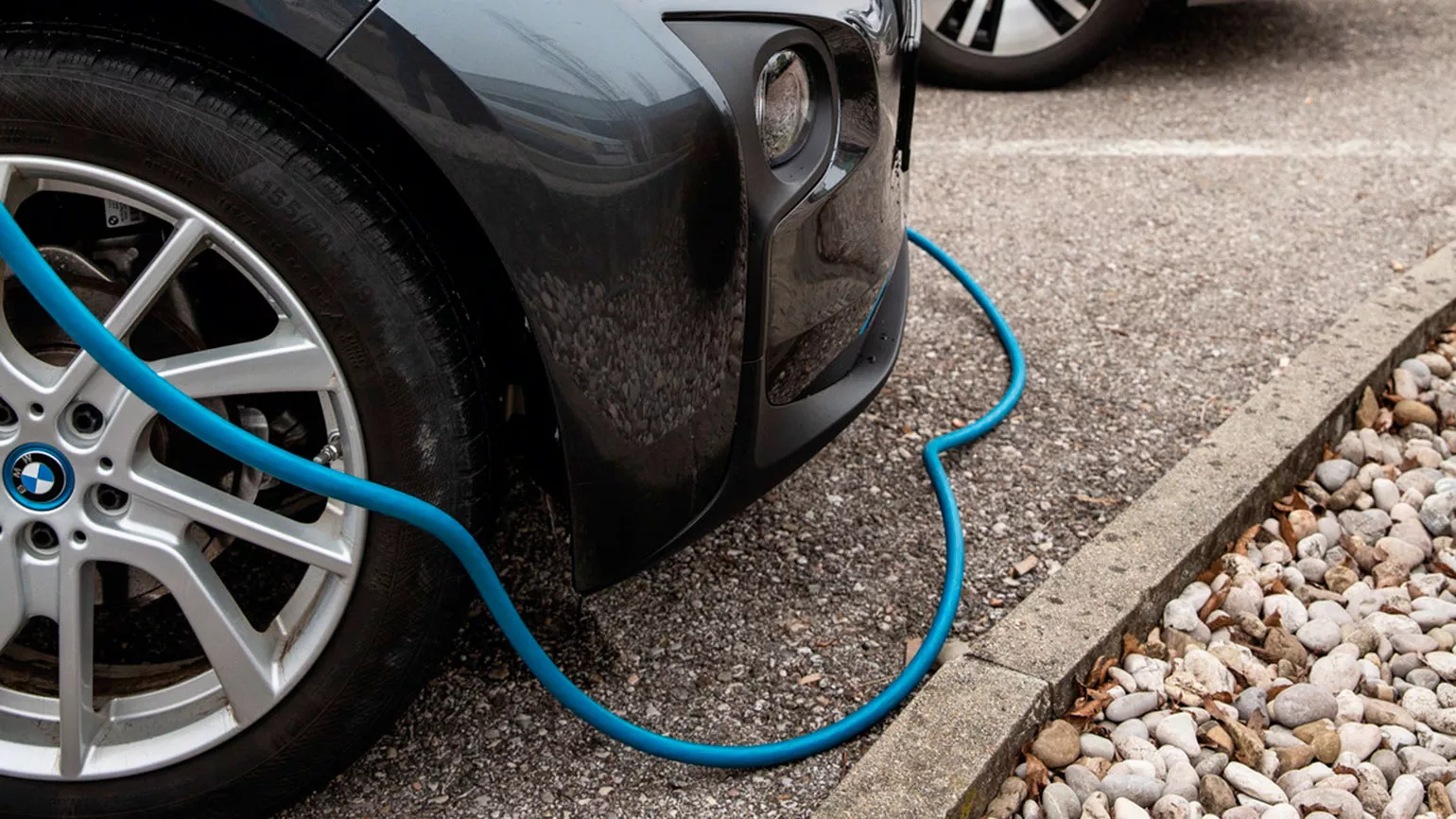

Charging company vehicles with solar power
Although they account for only a small proportion of the total energy requirements, the company’s four electric cars also use the solar energy for charging. This enables the company to profit from the energy that it does not directly consume at source.
On sunny days, Biohandel’s PV system produces more energy than it can use itself. With this surplus, the employees can drive almost 3,200 electric kilometres. For Biohandel, it therefore makes sense to invest in further electric vehicles. This would allow the company to use even more of the PV power it produces itself and further increase the degree of self-consumption.
Biohandel Pichler enjoys the following advantages by charging its e-cars with its own electricity:
  • They use as much of their own electricity as possible and save money
  • They feed less electricity into the grid
  • They charge their vehicles during the day when electricity production is high
  • They are not affected by rising fuel prices
  • They have created an incentive system for employees
  • They have improved their CO2 balance

Annual energy demand of the company  Approx. 200,000 kWh
Size of installation 100 kWp
Annual PV yield Approx. 100,000 kWh
Self-consumption rate 80%
Degree of self-sufficiency 40%
Loads Cooling system, packaging machines, conveyor belts, lighting
