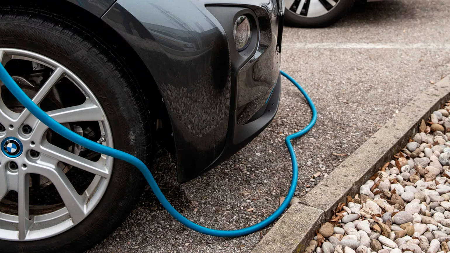

Three of the company cars are electric vehicles from different manufacturers. They are charged using the Keba wallboxes installed on the premises. Naturally, the electricity comes from the company’s roof-mounted PV system.
“Switching to electric cars is worth it in many respects. For one, in Austria we don’t pay any benefit in kind. Secondly, we can charge the vehicles with our self-generated energy, increasing our rate of self-consumption. And thirdly, they’re a really fun way to get around,” adds Gerhard Pichler.
