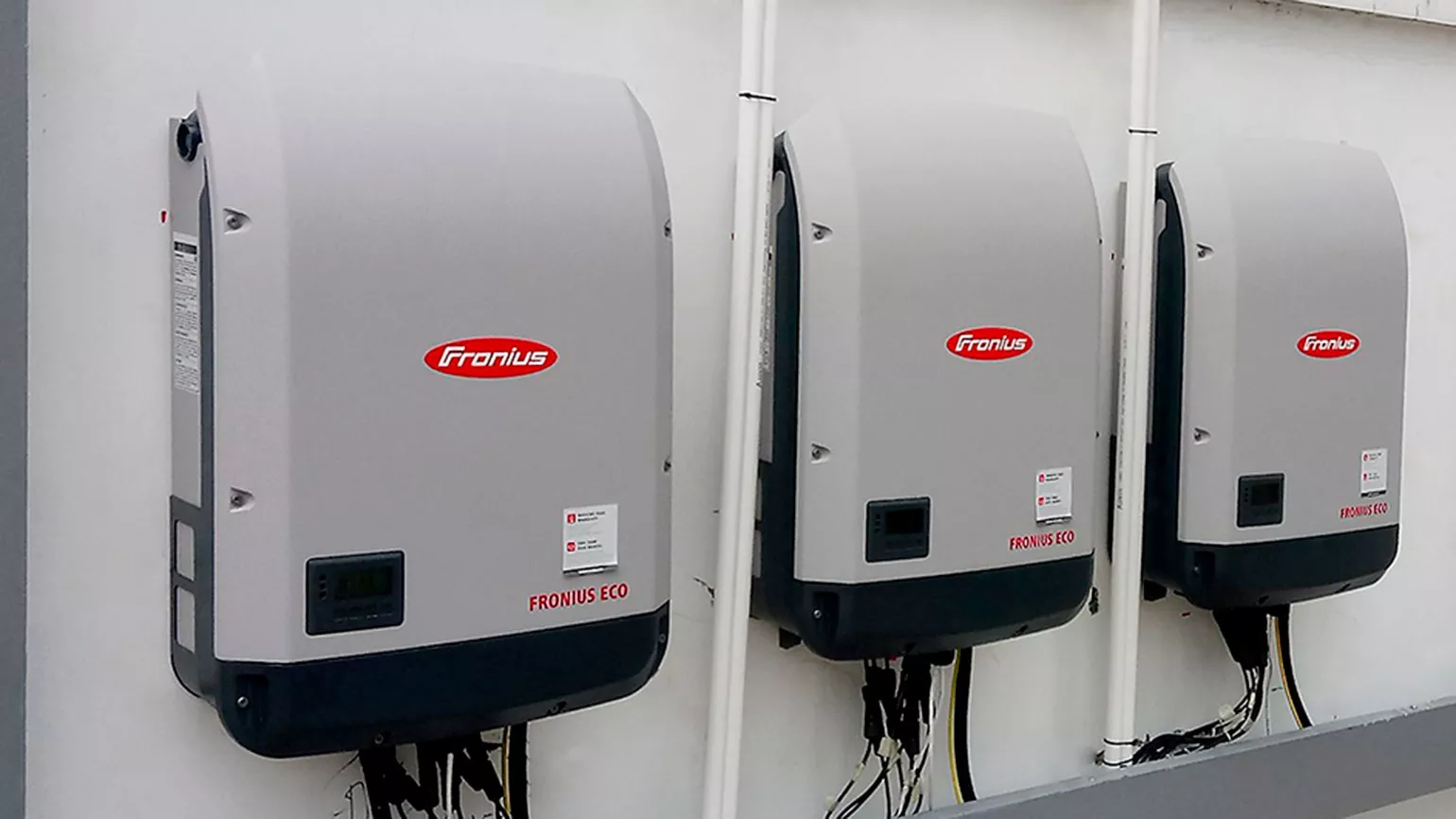

The region is characterised by a hot and humid climate. These circumstances also influence the sensitive electronical parts of inverters. Unlike models from other manufacturers, Fronius inverters are equipped with Active Cooling Technology.
An increase of 10°C cuts the life of power electronics in half!
Advantages of Active Cooling
Less costs: active cooling is usually maintenance free.
Low weight: inverters with active cooling have a lower weight.
Longer life span: longer life span of power electronics due to lower temperatures of inverter components.
More yield: inverters have a better derating behaviour as the cooling effect is much stronger. The yield improves.
Flexibility: inverters with active cooling can even be mounted flat (on a roof). Inverters with passive cooling can be mounted 90° vertically only.

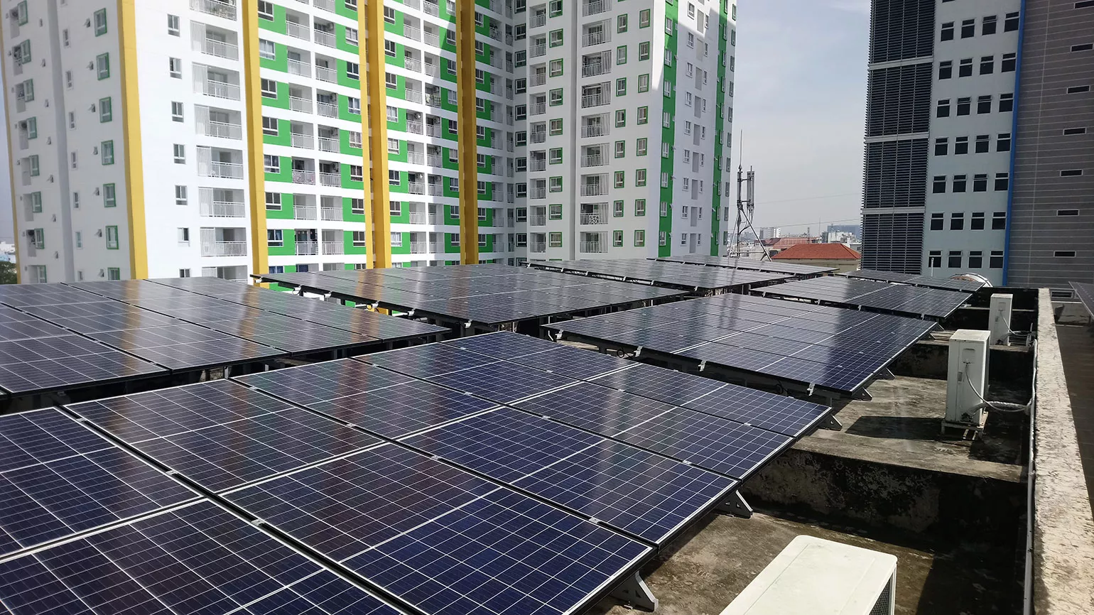

Size of installation 76.6 kWp
Inverter 3 Fronius Eco 27.0-3-S
Special features Extremely high ambient temperature, humid climate
