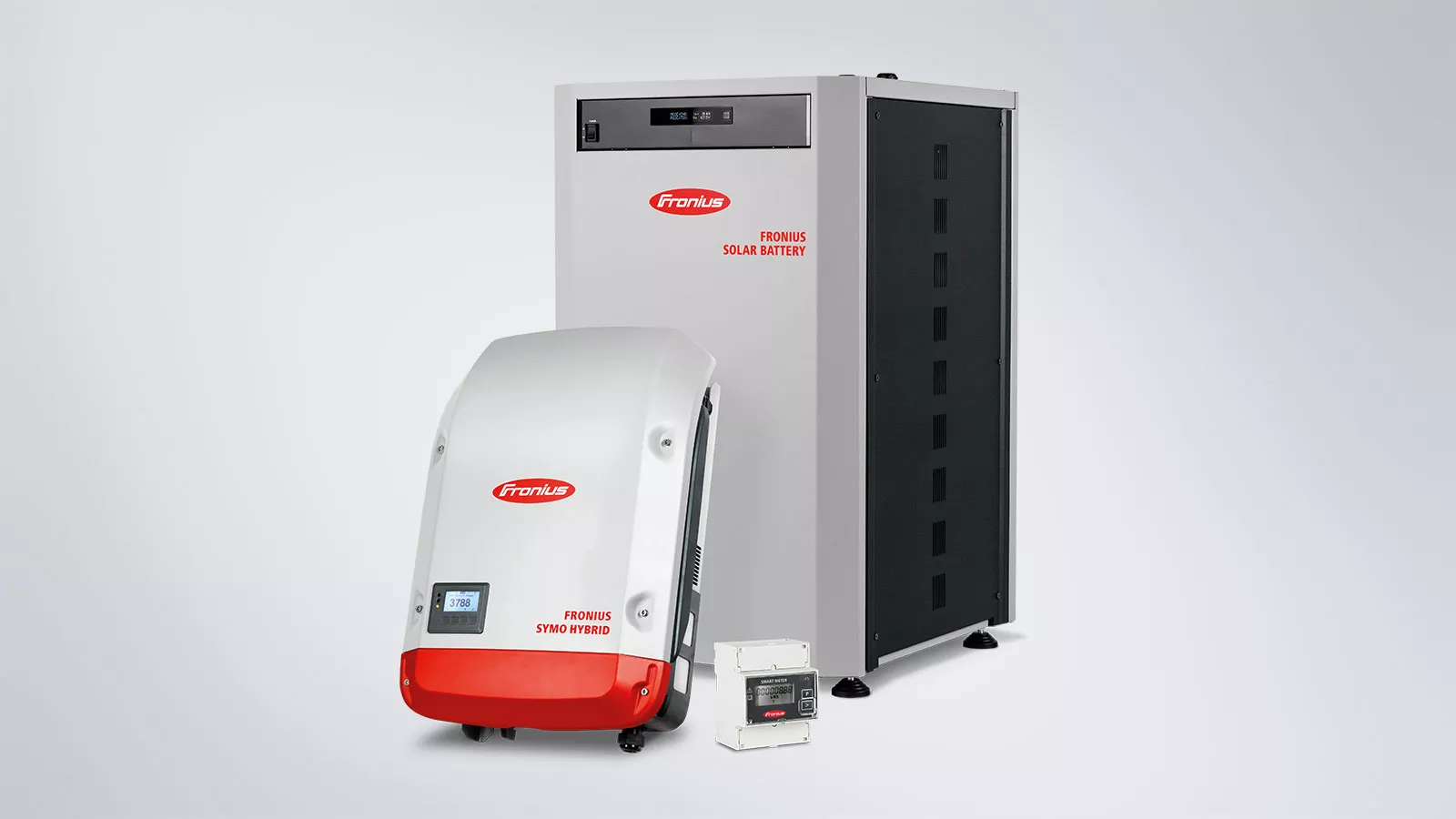

Operators of photovoltaic systems can achieve more independence from the public grid with the Fronius Energy Package. This consists of inverter, battery and the bi-directional Fronius Smart Meter, which clearly displays energy usage in Fronius Solar.Web. To remain autonomous during consumption peaks or in winter when there are very few solar hours, users can add an ÖkoFEN pellet stove to the Fronius package. With its integrated Stirling generator, this provides the additional energy required. In this way, private operators have the option of supplying their household almost exclusively with self-generated solar and pellet power.
