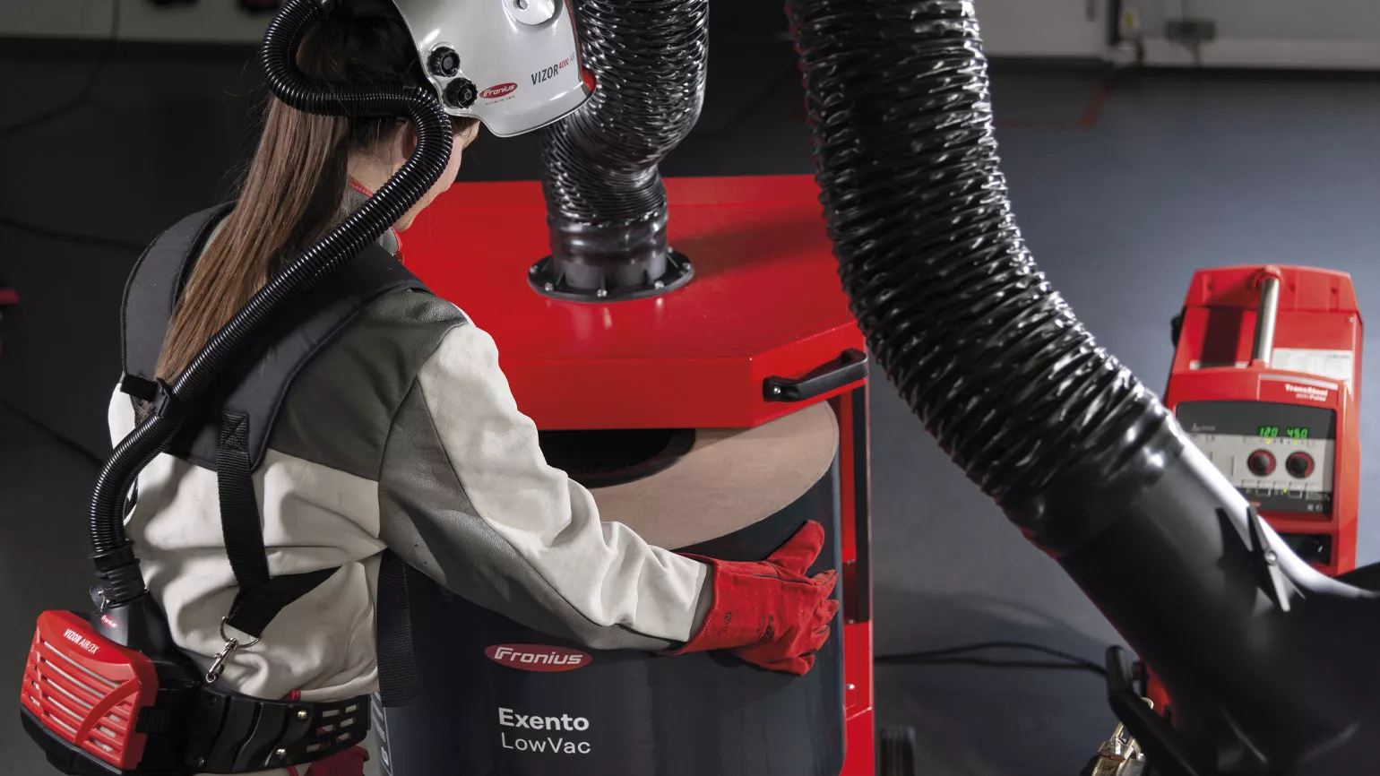

Exento LowVac – versatility in action
Whether MIG/MAG, TIG, or MMA welding: this compact, mobile, low vacuum extraction system is suitable for all common welding processes. Exento LowVac is the right choice for wherever fume extraction torches cannot be used. Its highlight is the 360-degree rotatable extraction hood with throttle valve with optional LED lighting. Equally remarkable is the large, standard 25 m² filter area of the disposable filter, which can be upgraded to 42 m² if required. The robust and stable design makes the Exento LowVac the perfect companion when frequent workplace changes are needed. Thanks to the high capacity and the long service life of the filter, the system is also extremely cost effective.
