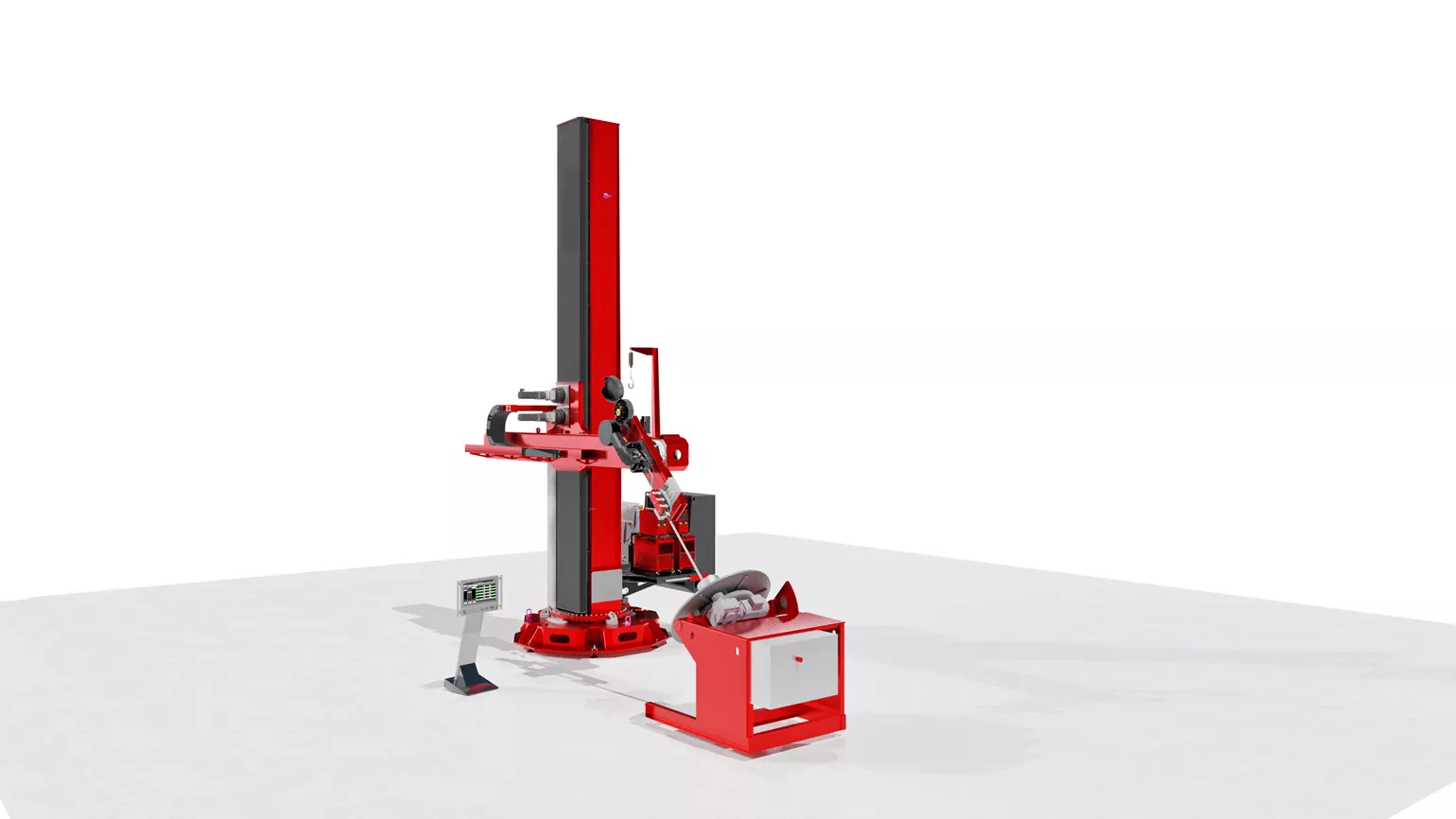

System Overview – Compact Cladding Cell (CCC)
Inner overlay welding torch
  • TIG HD welding torch (from 25 mm bore diameter)
  • TWIN wire option
1
SpeedClad 2.0
  • Speedclad welding torch system for top overlay welding performance
2
Ring groove welding torch
  • SpeedClad welding torch system for top overlay welding performance
3
Wirefeeder
  • 4-roller drive
  • Wire speed monitoring
  • TWIN wire option
4
PowerLiner
  • Roller-guided wirefeeding hose for perfect wirefeeding
5
Ergonomics
  • Wirespool holder at operator height for easy changing of the wire spools
6
Stand
  • Highly precise welding torch positioning due to the use of servo motors and precision guides
  • Optimized cable guide management
7
Power source set
  • TransTig 5000 Job and TransTig 2200 Job – fully digital for optimum welding results
  • High performance cooler for SpeedClad
8
Rotary table
  • Servo drive with precision gearing for maximum positioning accuracy
  • Slip ring option for pre-heating unit
9

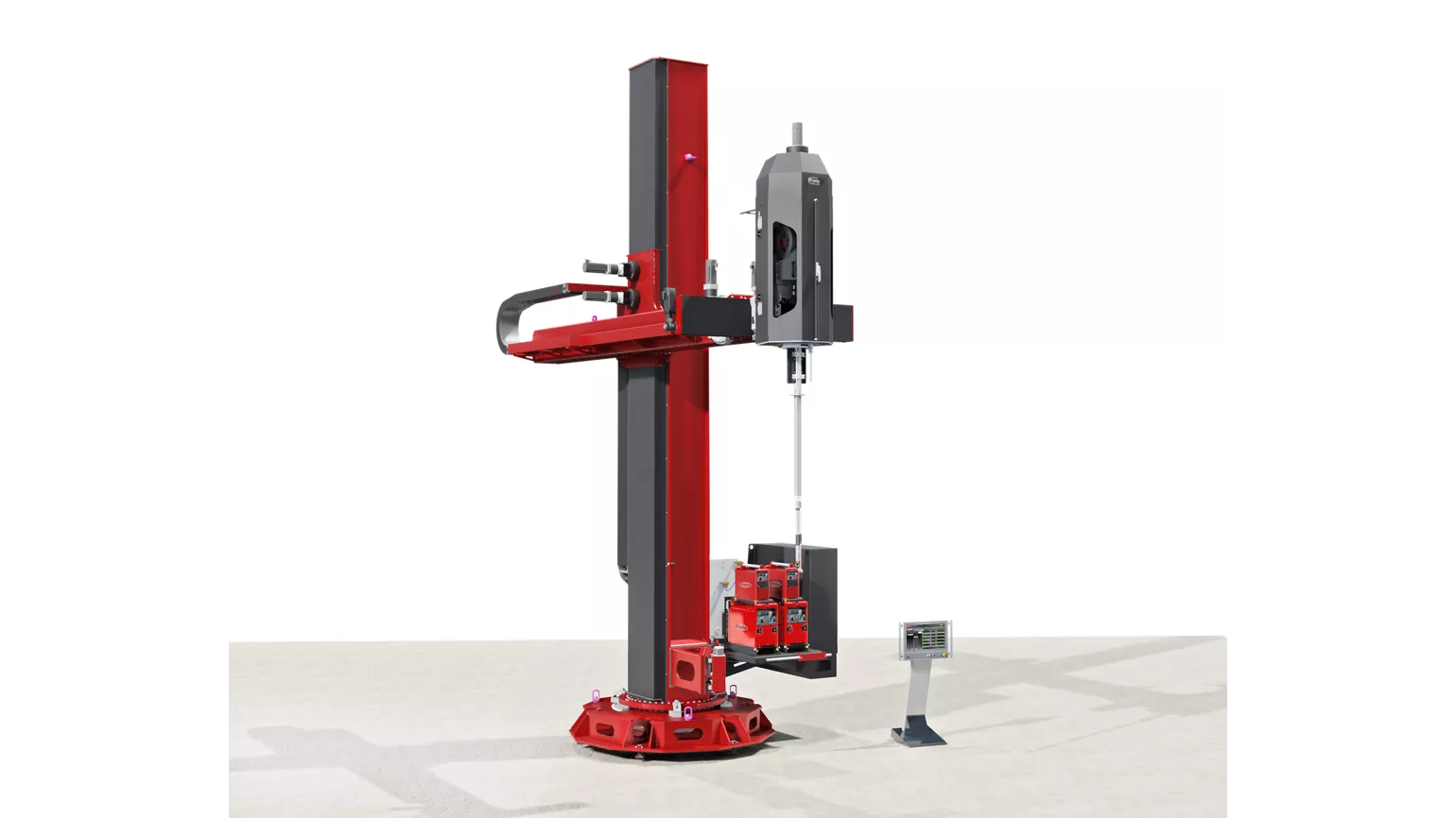

Applications
Bore to bore
Bore to bore advanced
Flange with bore
Straight/conical bore
Multi diameter
Ring groove
Cylindrical bore

System overview ETR-S HMI-T21
Column & boom
- Highly precise welding torch positioning due to the use of servo motors, absolute encoders and precision guides
- Vertical axis with travel distance of 3 to 5 m available
- selwing ring unit for 340° rotation
1
ETR head
- TWIN wirefeeder
- Motorized rotating and tilting
- Integrated oscillating unit
- Collision setup (electro-pneumatic)
- Welding torch holder with clamp fasteners for new generation TTHW welding torches incl. SpeedClad 2.0
2
HMI-T21 system controls
- 21” touch screen user interface
- CNC platform, STEP data import
- Autom. component position detection
- Real-time process visualization
3
Welding equipment
 - TransTig 5000 Job welding current source
- TransTig 2200 Job hot wire power source
- Power sources on telescopic extension devices for easy maintenance
- High performance cooler for SpeedClad 2.0
4

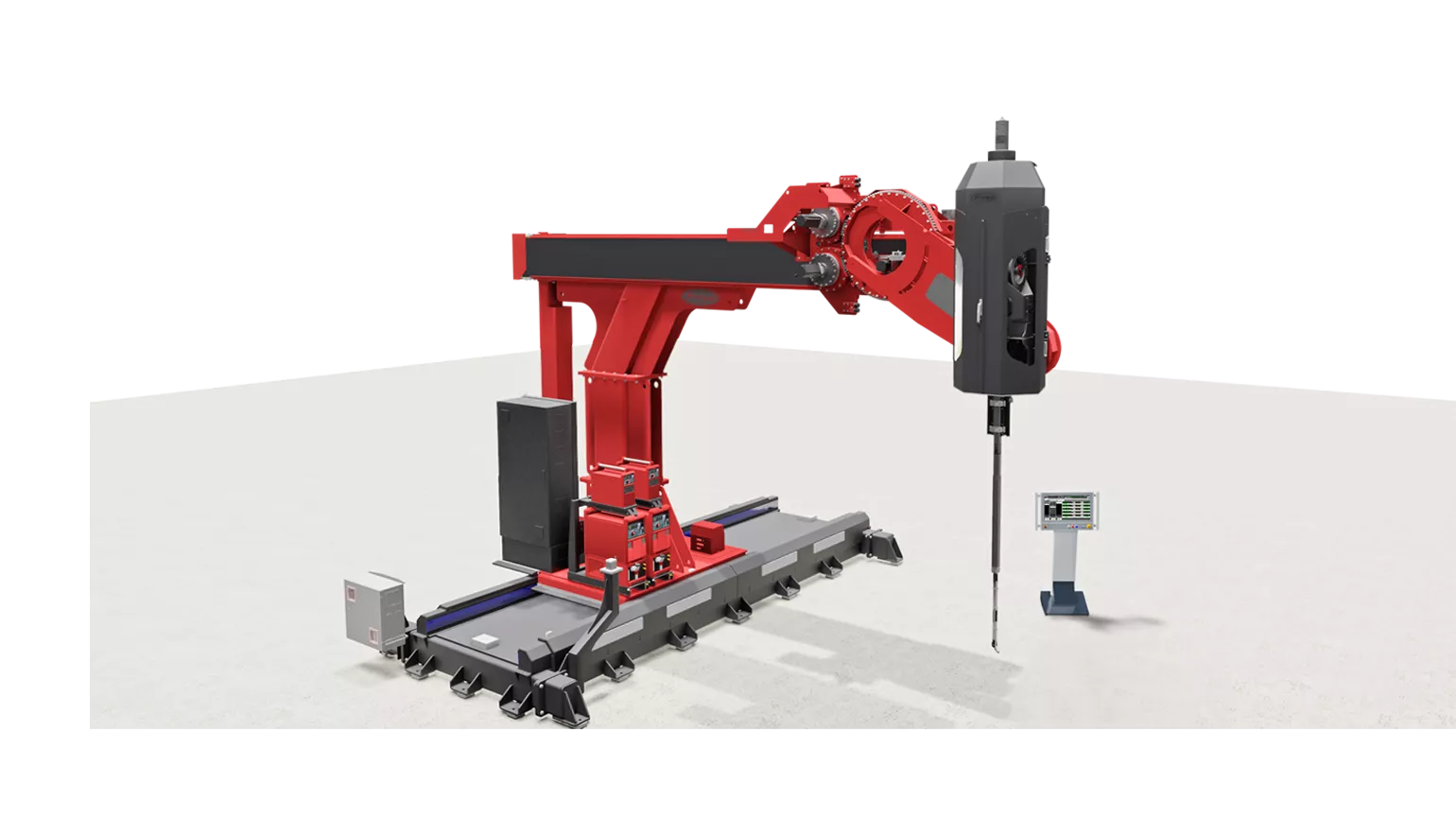

ETR Ultimate Advantages
High-end cladding system
  • Expanded working area due to motorized track
  • Complex component shapes
  • Multi station operation (fully automated)
  • Synchronized movement axes
  • SpeedClad 2.0 compatible HMI-T21 system controller
System Overview ETR Ultimate
Column & boom
/ Servo motors, encoder, precision guides
/ Assembled on motorized track (“track motion”)
1
ETR head
/ Twin wirefeeder
/ Integrated oscillating unit
/ Collision detection (electro-pneumatic)
/ Welding torch holder with clamp fasteners for new generation TTHW welding torches & SpeedClad 2.0
2
Welding equipment
TransTig 5000 Job
/ TransTig 2200 Job
/ Telescopic extension devices for welding current sources to allow for easier maintenance
/ High performance cooler for SpeedClad 2.0
3
Track motion
/ Motorized track
/ Platform for column & boom and welding equipment
4
21” touch screen
Automatic component position detection
/ Real-time process visualization
5
1
Column & boom
2
ETR head
/ Twin wirefeeder
3
Welding equipment
TransTig 5000 Job
/ TransTig 2200 Job
4
Track motion
/ Motorized track
5
21” touch screen

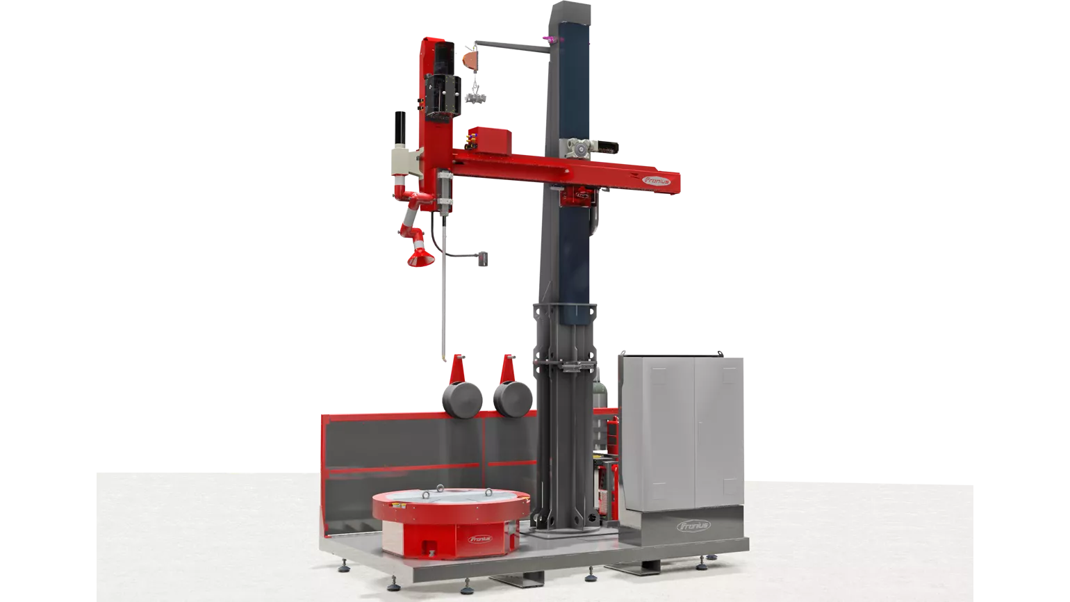

Conventional Cladding System Advantages
New control and drive technology for an even more precise cladding process
Motorized tiltable welding torch axis (up to 90°) to comply with the optimum weld layer
SpeedClad 2.0 compatible – up to three times better cladding performance in comparison with conventional TIG HD welding processes
HMI-T21 system controls – the new generation of control with an expanded scope of functions
System Overview Conventional Cladding System
Column & boom
  • Highly precise welding torch positioning due to the use of servo motors, absolute encoders and precision guides
  • selwing ring unit for 270° rotation
1
Welding equipment
  • TransTig 5000 Job welding current source
  • TransTig 2200 Job hot wire power source
  • Power sources on telescopic extension devices for easy maintenance
  • High performance cooler for SpeedClad 2.0
2
Welding head
  • Motorized tilting of the welding torch axis 0 - 90°
  • AVC/oscillating axes
  • Welding torch holder with clamp fasteners for new generation TTHW welding torches incl. SpeedClad 2.0
3
  • 21” touch screen user interface
  • STEP data import
  • Real-time process visualization
4
1
Column & boom
2
Welding equipment
3
Welding head
4
  • STEP data import
