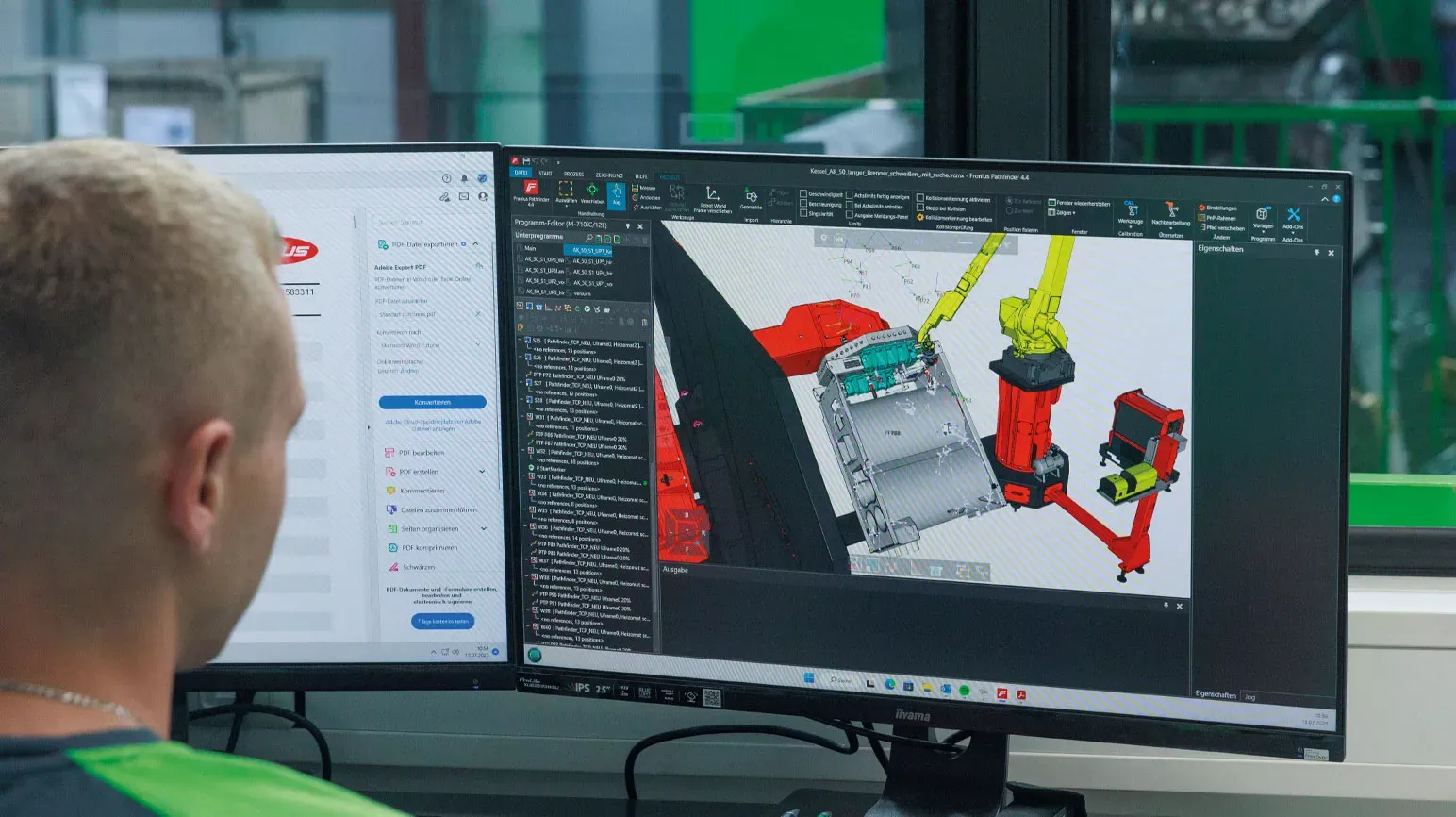

Optimal Welding Sequence with Fronius Pathfinder
The biggest plus when programming offline with Pathfinder is that all the welding sequences can be created away from the robot systems. Ongoing welding work no longer has to be stopped for programming. Simulators help detect potential errors in advance and optimize the welding sequences. For example, collisions, violations of axis boundaries, or singularities are recorded and visualized. Significant time savings are achieved in the copying, linking, grouping, and mirroring of welds. Welding simulations can be carried out in real time or at an infinitely variable speed with simultaneous cycle time determination (welding speed, gas pre-flow times, end-crater filling, etc.) If the welding robot were to be taught exclusively in the system, the amount of effort involved could be up to ten times greater.
