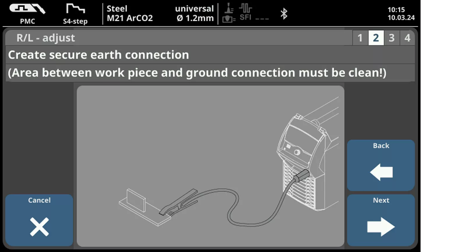

Over 70 manual welding workstations at Knoll are equipped with the advanced welding machine. It is easy to operate thanks to a customizable 7-inch touch display, penetration and arc length stabilizers and the fact that it can be expanded with task-specific software packages known as Welding Packages. Examples of this include LSC (Low Spatter Control), PMC (Pulse Multi Control), and CMT (Cold Metal Transfer). Welders can log in with their own NFC card and access their personal authorizations and settings.
The menu navigation is available in over 30 languages. Considering that Knoll is using more and more welding professionals from other countries due to the increasing shortage of skilled workers in Germany, “native speaker welding machines” are extremely helpful. Not only is the welding machine’s display multilingual, it also uses clear language. Detailed descriptions and graphical animations provide welding specialists with a step by step guide, for example, in resistance alignment.
The TPS-320i variant used with integrated wirefeeder is ideally suited for welding tasks to be carried out manually. This device’s particularly simple wire threading process, which takes just a few steps, is a huge plus and makes everyday life easier for welders.
All Parameters at a Glance
The welding machine is operated with a central rotary push-button combined with a touchscreen. The quick change function that allows users to switch between properties, processes and functions is particularly practical. If you touch the respective prompt on the status bar of the display, you can immediately access the available parameters.
On the central display of the TPS 320i, the specialists can see all the relevant control variables and adjust them one by one. Innovative animations support the welding specialists when entering parameters. For example, there is a graphical representation of how a-dimensions change as arc length corrections are made, depending on whether a positive or negative correction is entered. The “synergic function,” which automatically detects how settings and corrections affect other relevant parameters, is responsible for this.
