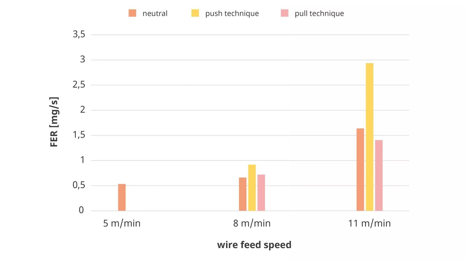

FER when welding surfacing beads
In principle, it can be stated that welding fume emissions are lowest at 5 m/min wire speed and in the neutral welding torch position, where it is apparent that emissions are lower at a wire speed of 11 m/min than at 8 m/min. With the pull torch guidance technique, the emissions are very slightly lower at all wire speeds than with the push technique.
If welders optimize the arc using arc length correction (with a neutral torch position in the test), the welding fume emissions can be significantly reduced at all wire speeds. In contrast to non-optimized arcs, welding fume emissions are slightly lower at 8 m/min with 0.9 mg/s than at 11 m/min with 1.1 mg/s, see Figure 1.

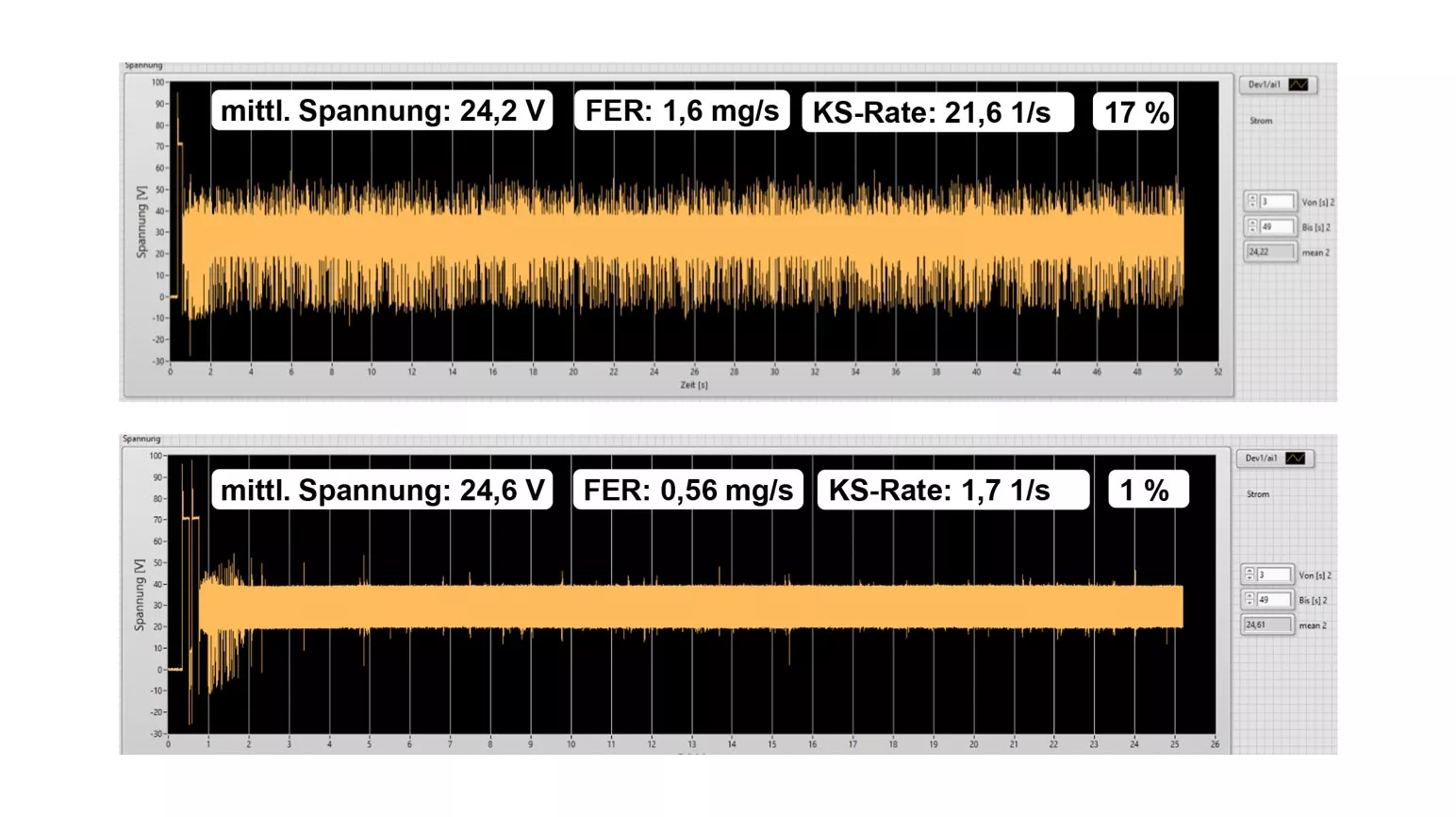

Comparison of the voltage curves with a wire speed of 5 m/min
Clearly, the welding fume emission rate correlates with the number of short circuits. A high number leads to a significantly higher FER. The study considers this to be due to material transfer. Short-circuit phenomena cause process disruptions that result in metal vapor and metal spatter. If you want to keep emissions to a minimum, it is advisable to use a process setting that brings arc length and short-circuit reduction down to a common denominator – that is, does not keep the arc too long or too short. With a slightly increased medium voltage, both short-circuit phenomena and emissions are reduced (Figure 2).

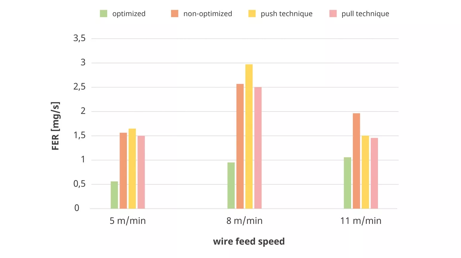

FER when welding fillet welds
Pulse welding with wire speeds of 5 m/min and 8 m/min results in significantly lower emission rates, 0.55 mg/s and 0.7 mg/s respectively, than with a wire speed of 11 m/s. Here, the emissions amount to 1.7 mg/s, more than three times that generated at a wire speed of 5 m/min. Similar to the surfacing beads, the reason for this is the lower number of short-circuit phenomena; here too the pull torch guidance technique also leads to lower emissions – with a considerably lower emission rate with a wire speed of 11 m/min (see Figure 3). In this case, the emissions are even lower than with a neutral welding torch position.
Overall, the welding fume emissions are at a lower level than with the surfacing beads. The lowest value of each of the wire speeds is comparable to the emissions of the optimized processes (see Figure 1, green bars) with which the surfacing beads were welded.
At a wire speed of 8 m/min, the welding fume emission rates for the push and pull welding torch position are very similar in absolute values – as was also the case with the surfacing beads. By contrast, the push welding process at 11 m/min reveals a significantly higher FER at around 2.8 mg/s.

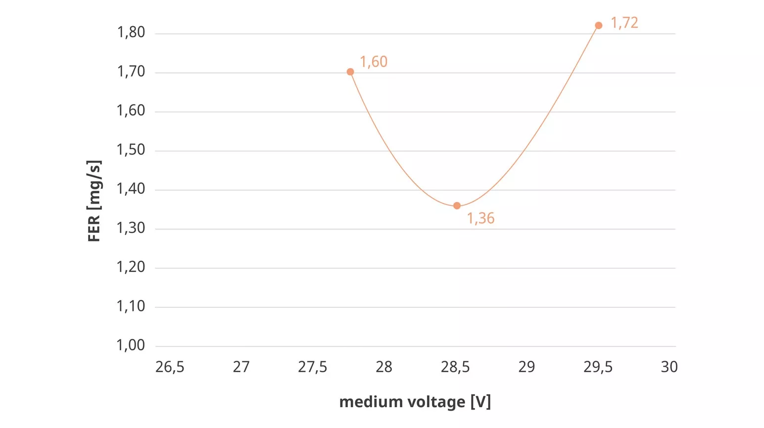

In the FEF test, the relationship between emission rate and medium voltage at 11 m/min wire speed was studied more closely: With three measured values, there was a minimum at 1.36 mg/s (optimized with arc length correction -1.5 V). This is the operating point at which short-circuit phenomena occur sporadically, but the arc is not unnecessarily long. The process without arc length correction generates more emissions (1.72 mg/s) due to the longer arc and higher process performance. As the number of short-circuit phenomena increases with decreasing medium voltage (arc length correction -2.5 V), the welding fume emissions (1.6 mg/s) also increase, see Figure 4.
