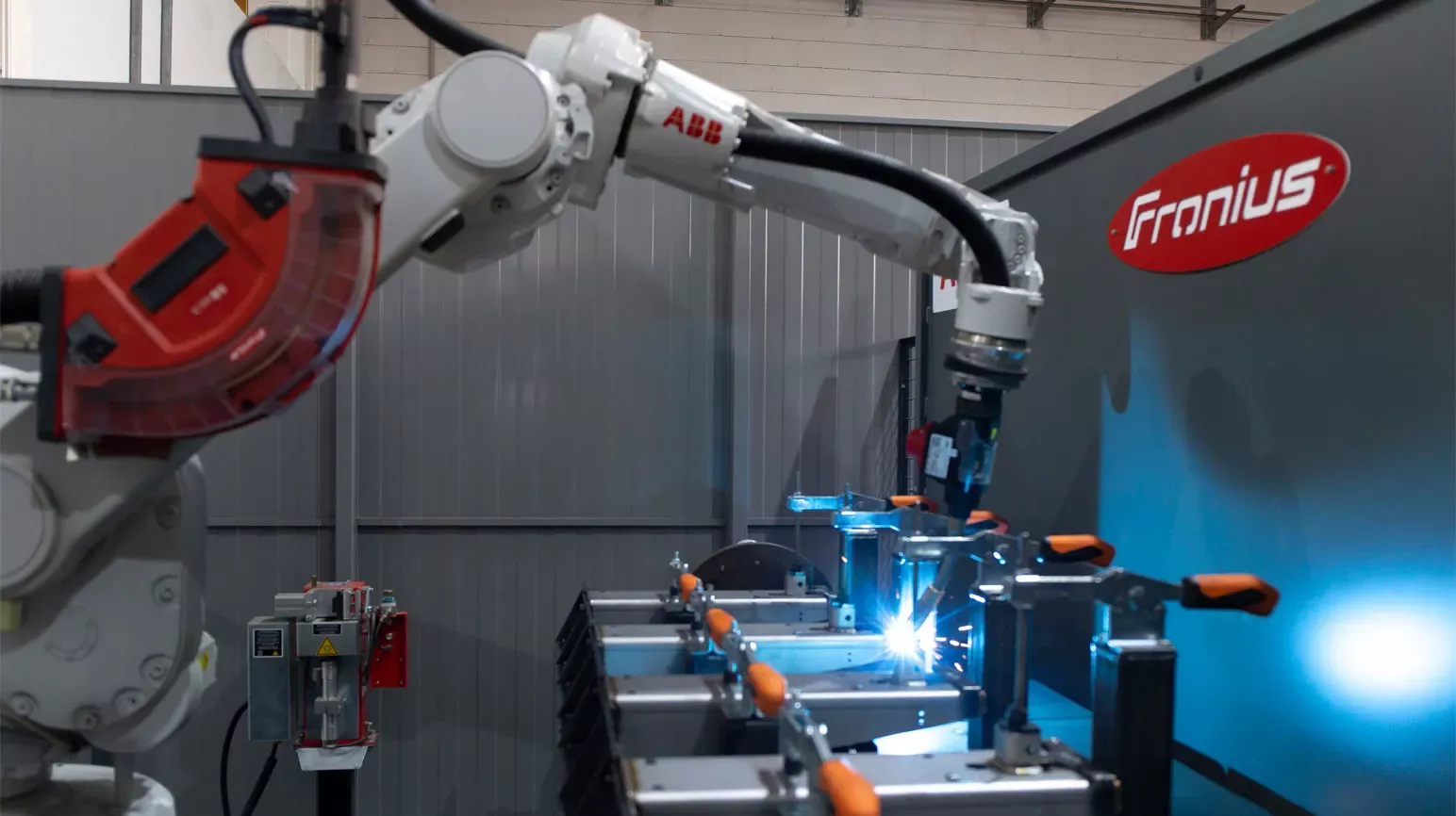

One specific challenge for Viñolas is welding beams for swimming pool roofs from austenitic chrome-nickel steels 304 and 316. The welding solution consists of a robotic welding cell equipped with a TPS 400i CMT welding machine, a hollow arm welding robot, and a H reverser, which has two vertical turntables on a horizontal axis on both sides. Custom-made clamping devices are mounted between the turntables, each of which can accommodate four of the stainless steel beams.
Once one side of the H reverser is loaded with four steel beams, they are turned into the welding cell and joined in a single cycle. Meanwhile, on the other side, the finished welded components can be removed and four new ones positioned, saving valuable cycle time. As soon as the teaching of the system is complete, the sequence program together with axial movements is specified and the weld quality is ensured. The component handling itself can be carried out by trained operators who do not have to be experienced welding specialists—a particular advantage in times of skills shortages.
