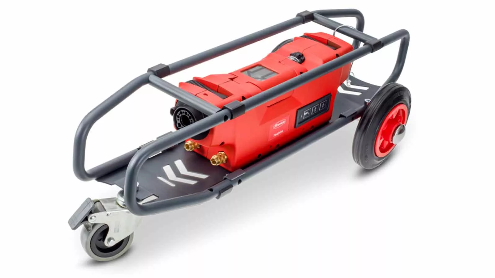

FlexDrive WF 25i FlexDrive for TPS/i and iWave
Extends your radius of action

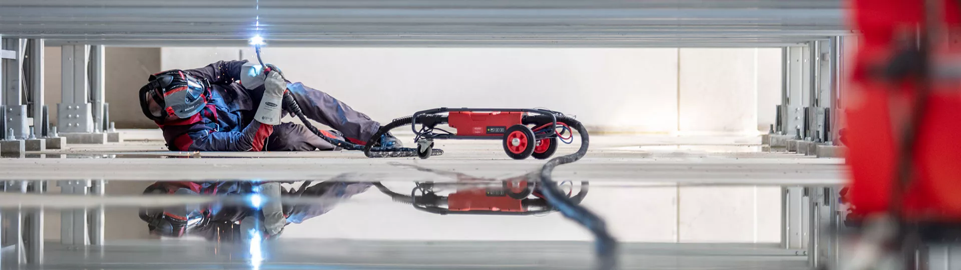

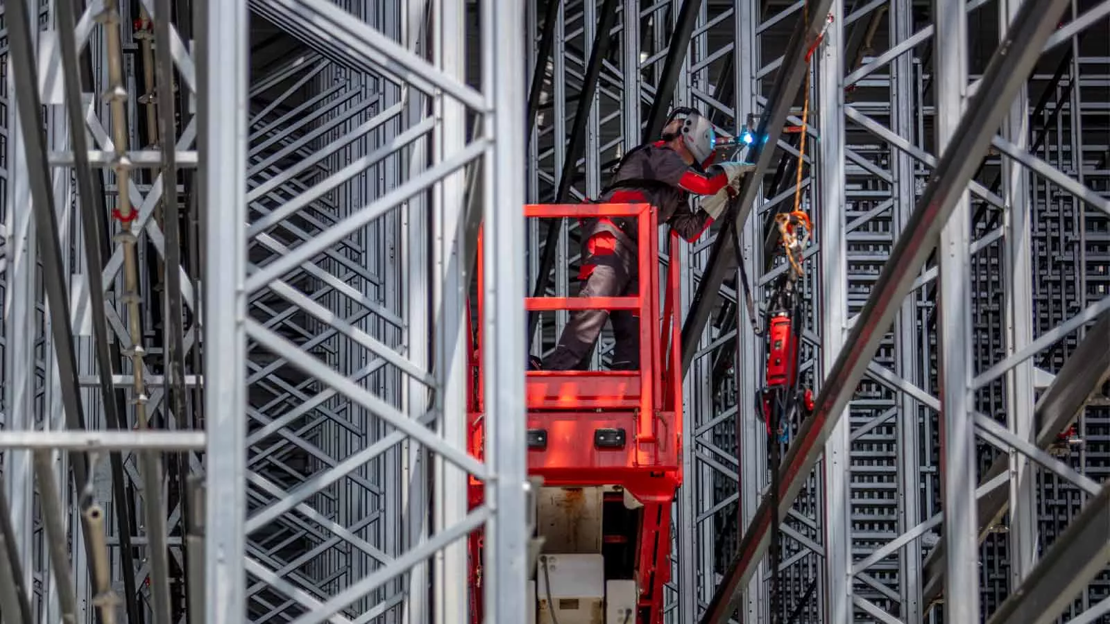

Do you need to bridge larger distances between the welding system and weld location easily and without fuss? Not a problem with the FlexDrive WF 25i – a small and portable intermediate drive between the wirefeeder and welding torch.
The FlexDrive demonstrates its strengths most impressively in situations where it is difficult to get the welding system and wirefeeder right to where they are needed, such as on shipyards or in the construction of bridges, tanks and containers, and rolling stock.
Your advantages
  • Extended radius of action: up to 25 m distance between main wirefeeder and welding point
  • Flexible and compact: just 4.4 kg (excluding cage and wheels)
  • Compatible with all Push manual welding torches of the TPS/i generation (Standard, UpDown, or JobMaster version)
  • The cage, which is made of a tubular construction, allows the FlexDrive to be suspended or hung in the most suitable position
  • The synchronized motors of the FlexDrive and the main wirefeeder guarantee an optimal wirefeed
Technical data
   WF 25i FlexDrive
Watercooled  320 A 100% duty cycle
Gascooled  260 A 100% duty cycle
Wire diameter 0,9–1,6 mm
Wire feed speed 1–25 m/min
Protecion class  IP20
Certification CE (CSA planned)
Needed Software Version 3.2.0
Size
 404x104x128 mm (drive unit)
736x156x149 mm (incl. cage)
736x303,5x235 mm (incl. cage & wheels)
Weight 4,4 kg (drive unit)
8,1 kg (incl. cage)
10,4 kg (incl. cage & wheels)
