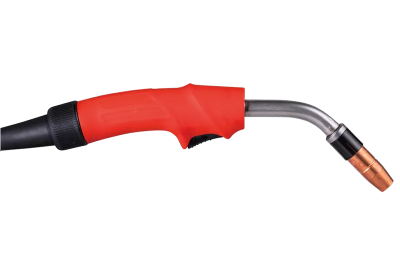

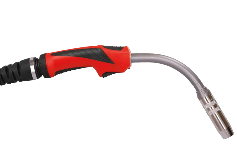

For fatigue-free working: The MTG welding torch product range consists of gas-cooled MIG/MAG manual welding torches. They are designed to provide the required working comfort and to make day-to-day work significantly easier for welding specialists thanks to an ergonomic grip, a ball joint, and optimum weight distribution. For top performance and more gentle welding!
MTG welding torch
MTG 2500S
Welding current (ArCO2)
  • MIG/MAG 40/100% D.C.: 230/170 A
  • Wire diameter: 0.8–1.2 mm
  • Hosepack length: 3.5/4.5 m
MTG 2100S
  • MIG/MAG 40/100% D.C.: 190/140 A
MTG 250i
Welding current (ArCO2) Control variants
  • MIG/MAG 40/100% D.C.: 250/170 A
  • Standard
  • Up/Down
  • JobMaster
MTG 320i
  • MIG/MAG 40/100% D.C.: 320/210 A
  • Wire diameter: 0.8–1.6 mm
  • Standard
  • Up/Down
  • JobMaster
MTG 400i
  • MIG/MAG 40/100% D.C.: 400/260 A
  • Standard
  • Up/Down
  • JobMaster
MTG 550i
  • MIG/MAG 30/100% D.C.: 520/360 A
  • Wire diameter: 1.2–1.6 mm
  • Standard
  • Up/Down
  • JobMaster

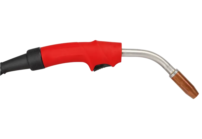

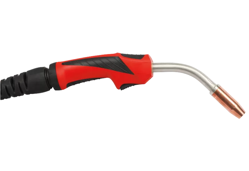

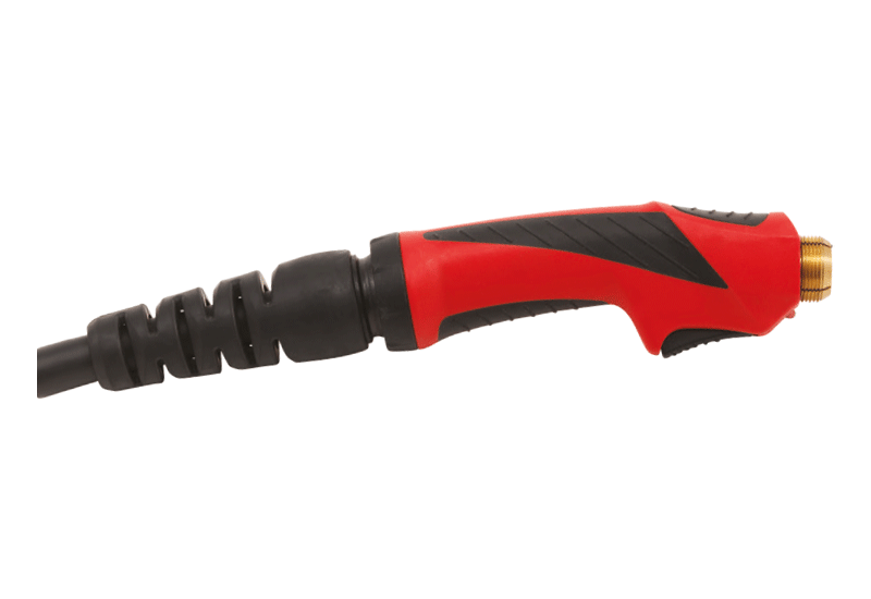

MHP - Multilock welding torch
MHP 250i G ML
  • Hosepack length: 3.35/4.35 m
  • Standard
  • Up/Down
  • JobMaster
MHP 400i G ML
  • Standard
  • Up/Down
  • JobMaster
MHP 550i G ML
  • Standard
  • Up/Down
  • JobMaster

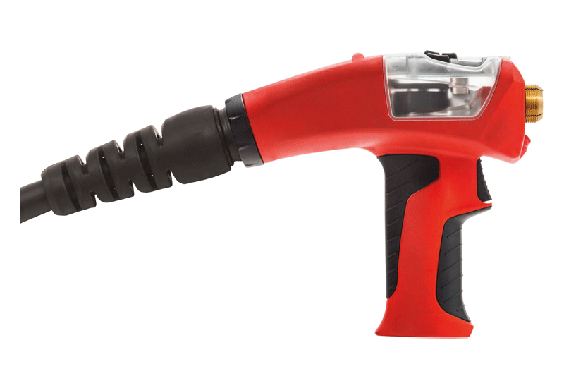

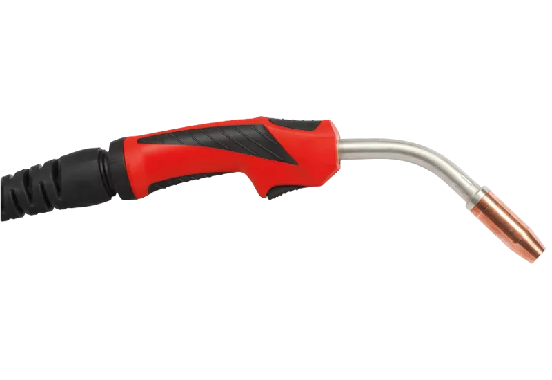

PullMig
Small, lightweight, and powerful
The motor unit located directly on the PullMig welding torch ensures particularly stable and safe wirefeed and ensures maximum stability during welding. The welding torch is therefore particularly well suited to aluminum applications, for use with thin wires, or for use with long hosepacks of up to 15 m.
MHP 280i PullMig G
  • MIG/MAG 40/100% D.C.: 280/170 A
  • Hosepack length: 5.85/7.85/9.85 m
  • Standard
  • Up/Down
  • JobMaster
MHP 280i PullMig G CMT
  • MIG/MAG 40% D.C.: 280 A
  • CMT 40% D.C.: 180 A
  • Hosepack length: 3.85/5.85/7.85 m
  • Standard
  • Up/Down
  • JobMaster

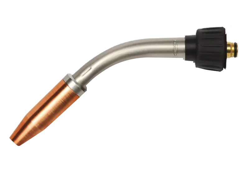

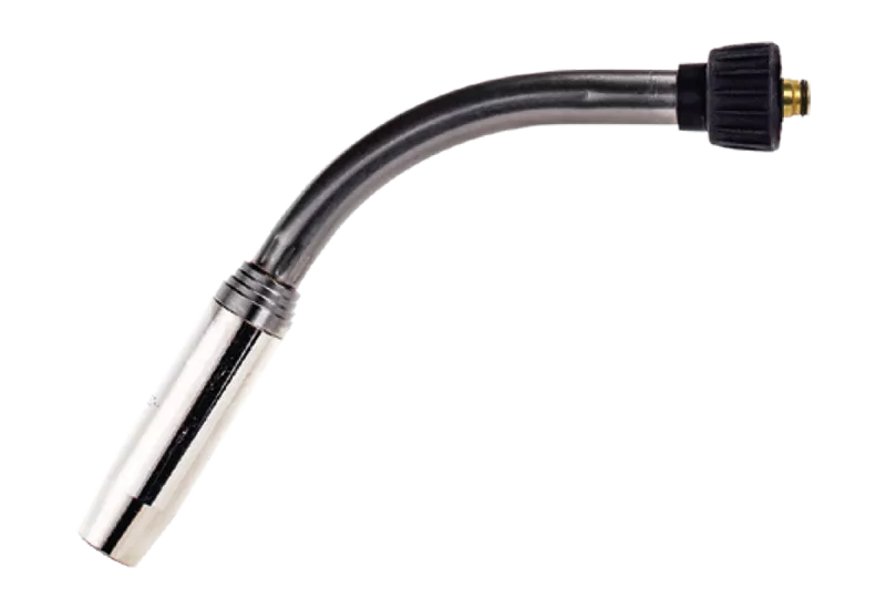

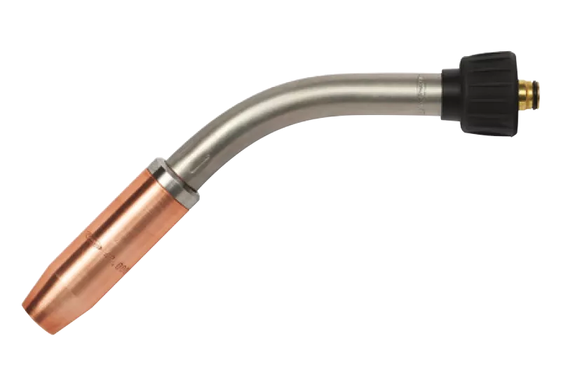

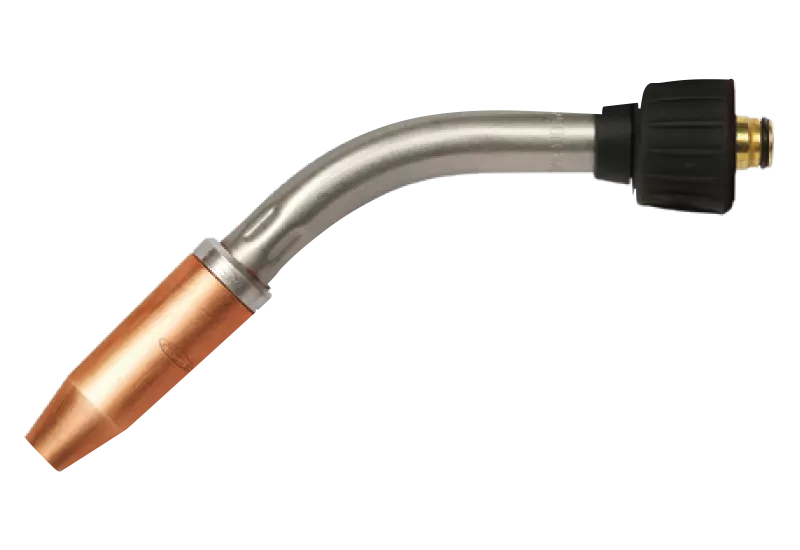

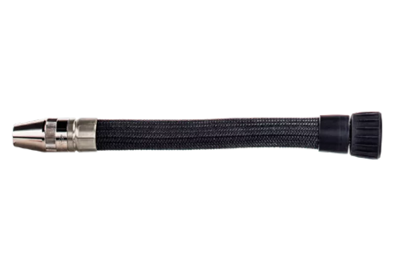

MTB - Multilock torch body
MTB 200i G flex
  • MIG/MAG 40/100% D.C.: 200/160 A
MTB 250i G
MTB 320i G
MTB 330i G
  • MIG/MAG 40/100% D.C.: 330/220 A
MTB 360i G flex
  • MIG/MAG 40/100% D.C.: 360/240 A
MTB 400i G
MTB 550i G
