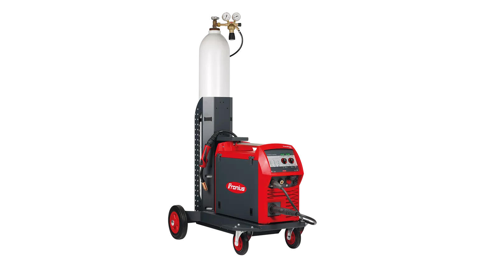

TransSteel Compact
No matter what the welding task - MIG/MAG, TIG and electrode welding with just one device.
Whether a construction site or a workshop, from agricultural enterprises to metalworking companies – for assembly, repair, and maintenance work, the TransSteel Multiprocess series masters the MIG/MAG, TIG, and electrode welding processes to professional levels.
The TransSteel 3500 Compact is the most powerful Multiprocess welding system in the TransSteel series. Irrespective of the welding process, the welder has a total of 350A with 40% duty cycle at their disposal. Optional water cooling is also available for this power range.

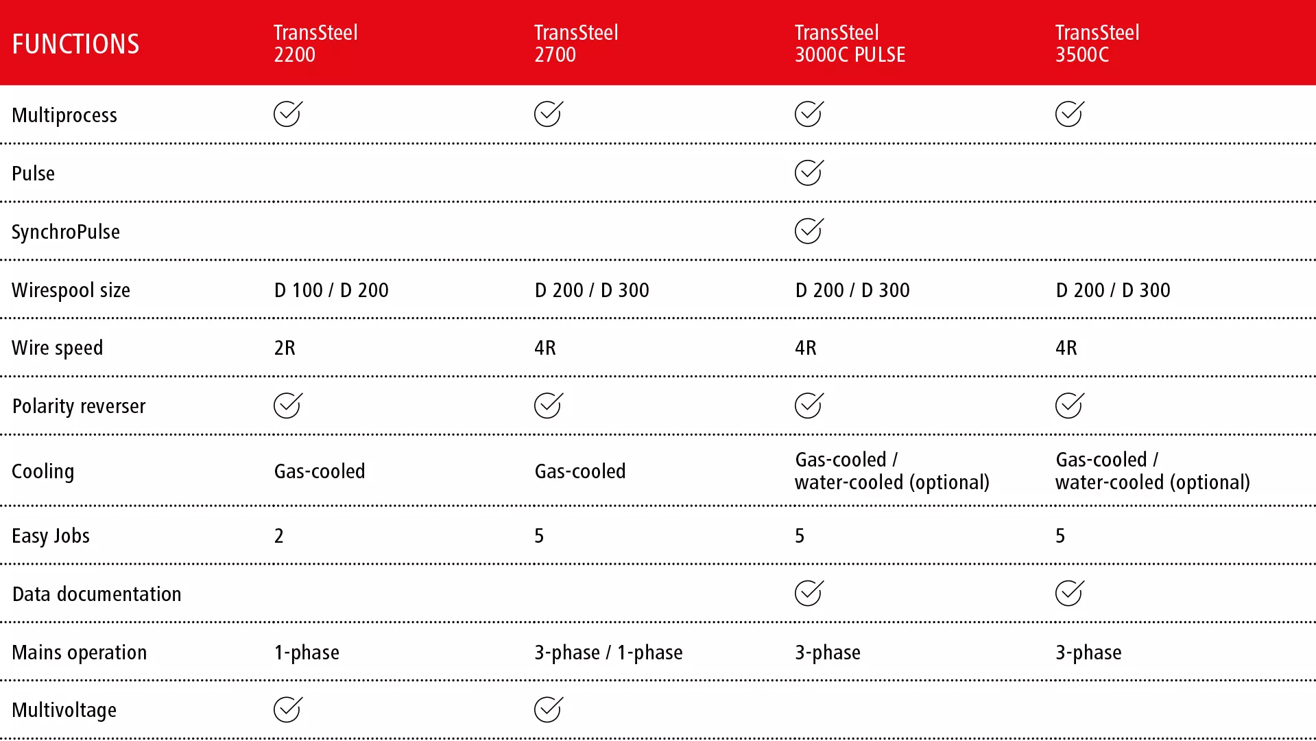

The TransSteel multiprocess series
No compromises. TransSteel Multiprocess.
One device - for all manual welding applications
Combining MIG/MAG, TIG, and electrode welding in one device means you no longer have to purchase any other power sources. There is absolutely no difference in the welding performance of the respective process compared with a dedicated device.
118 characteristics*
/ Steel, CrNi, AlMg, AlSi, Metal Cored, Rutil FCW, Basic FCW, self-shielded wires
/ 0.8 – 1.2 mm wire diameter
/ Eight different gas mixtures

* Maximum number of characteristics (TransSteel 3000 C Pulse), will vary depending on the version.

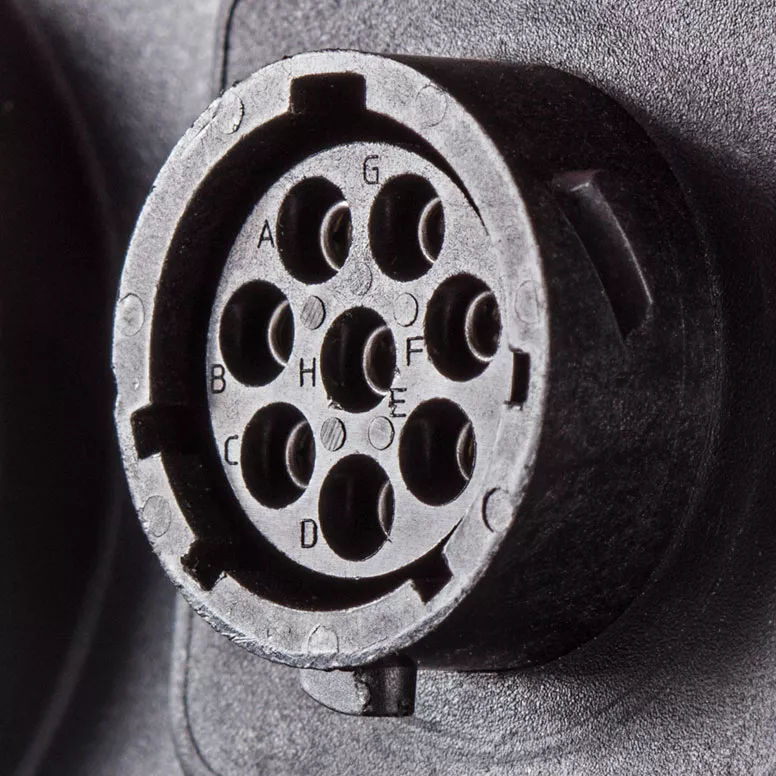

TIG Multi-Connector
Additional functions for multiprocess
The TransSteel is a genuine multiprocess power source, so also offers a connection for TIG welding torches with additional functions – the TIG Multi Connector (TMC). This enables Up/Down welding torches to be used for TIG welding as well.
FSC
Fronius System Connector
The Fronius System Connector (FSC) is the central connector for all media and enables a variety of different welding torches to be connected.
