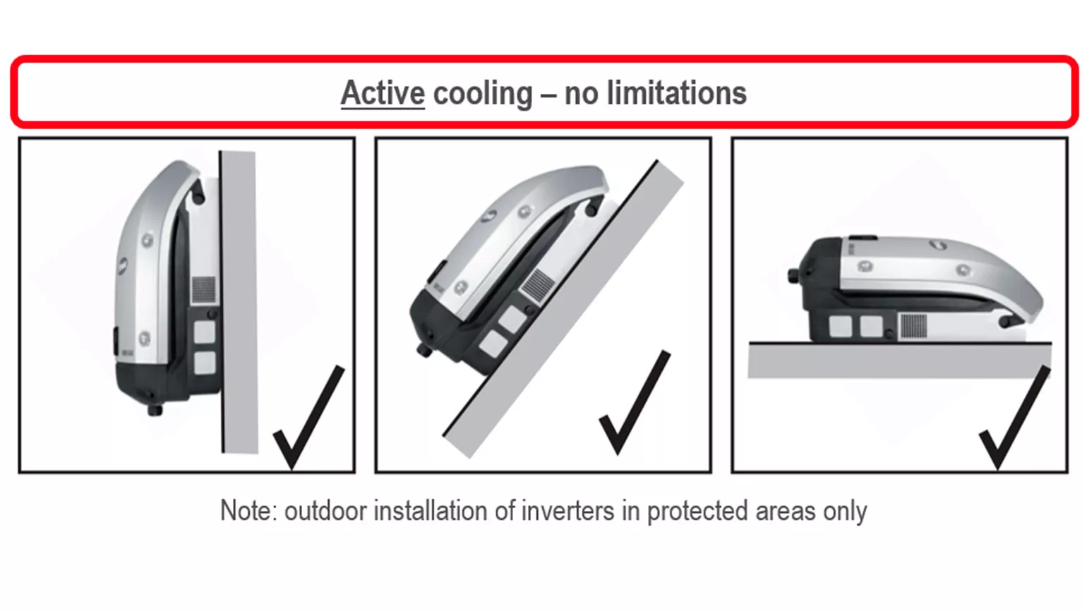

More flexibility
Inverters with active cooling are incredibly flexible as far as installation is concerned. They can even be installed horizontally. Installation angles of between 0° and 90° are also possible.  Inverters with passive cooling can only be installed vertically on a wall.

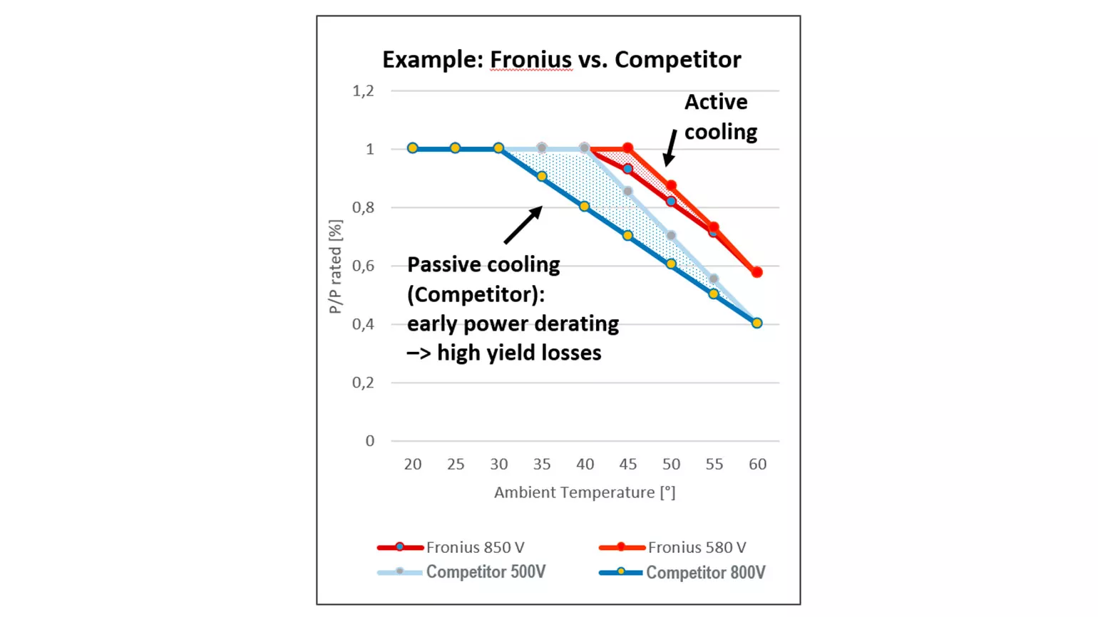

Higher yield
The power derating behaviour of an inverter with Active Cooling Technology has considerable advantages over devices with other ventilation systems. The significantly cooler temperature inside the housing means that Fronius inverters display optimum derating behaviour, which has a direct positive influence on the yield. Particularly in warmer regions, devices with active cooling produce considerably higher yields and reduce the payback time of the investment.
