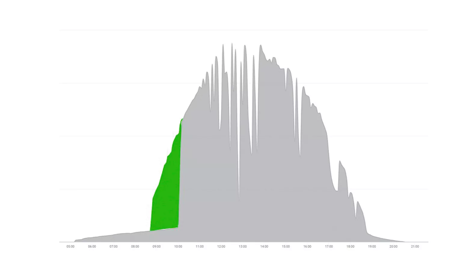

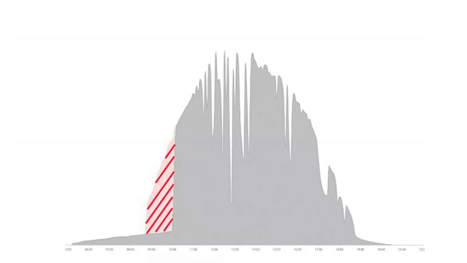

Higher yield despite shading of PV systems in practice
  • Photovoltaic system size: 3.3 kWp
  • Orientation: South-west
  • Tilt angle: 19.5°
  • Shadow: Partially shaded
On a sunny day, the yield of this system complete with the Fronius Dynamic Peak Manager is 7% higher than it is for systems without shade management.

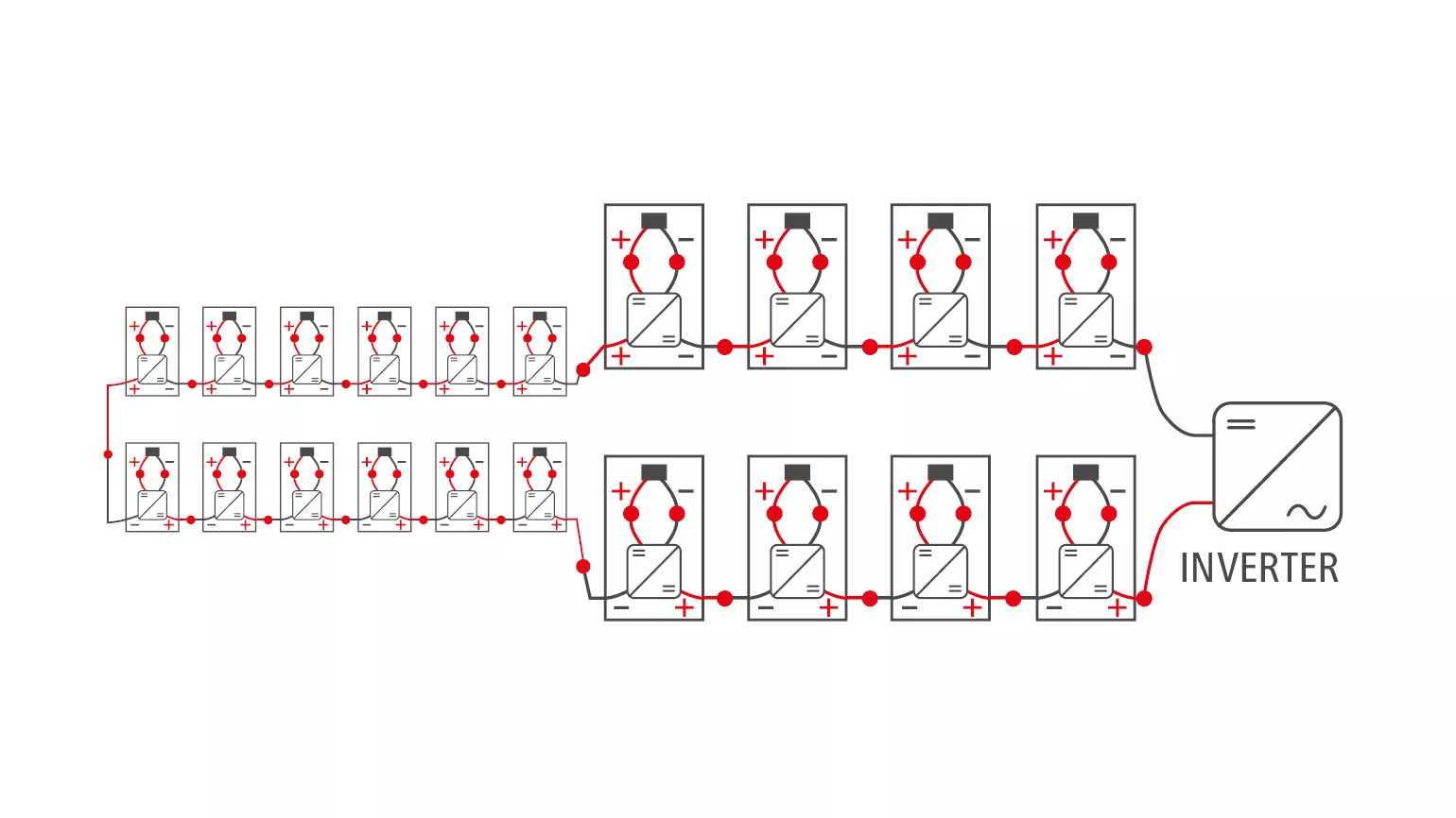

Power optimisers in the case of shading of PV systems
DC power optimisers adjust the voltage of shaded PV modules by boosting or decreasing it. The component requires energy to do this.
The more shade there is, the higher the consumption of the optimiser, and the lower the efficiency. This means, especially in partial shading situations, that power optimisers often cannot compensate for the shade, so they do not generate a higher yield.
Another disadvantage of DC-optimised systems is the large number of components on the roof.
Each power optimiser sits directly behind the PV module on the roof and is therefore continuously exposed to heat, cold, rain and snow. This is bad for the sensitive power electronics and can have repercussions for servicing and the fire risk.
The number of defects in DC plug connections, which represent the main source of photovoltaic system problems, is tripled in DC-optimised systems.
