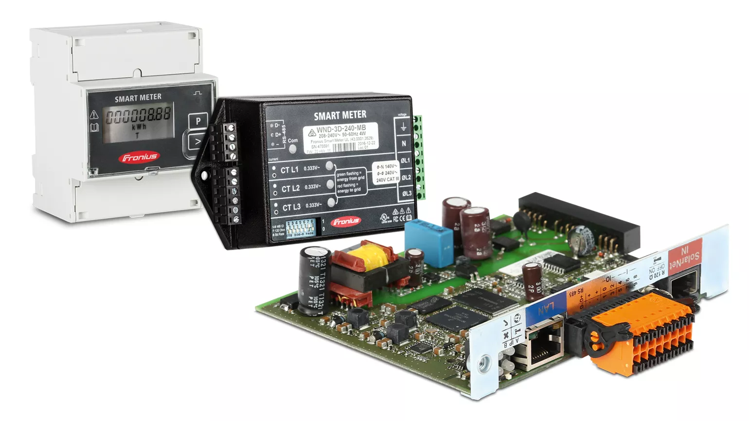

The Fronius Datamanager 2.0 is the device that transmits data generated by your inverter to the internet, such as PV values. The amount of data that is consumed whilst doing so has significantly increased for Datamanager firmware versions above 3.16.
If you are using a metered connection such as a 3G or 4G router, this increase in data usage is more likely to affect you, and could increase your bill significantly. In order to select a suitable internet connection, you need to calculate the data volume. The following information is used to calculate the data volume per month when operating the Fronius Datamanager 2.0
Hourly upload Up to firmware
version 3.17
From firmware
version 3.17 upwards
Total 8 MB 650 MB
+ for each additional Fronius inverter 5 MB
+ for each additional Fronius Smart Meter 7 MB
