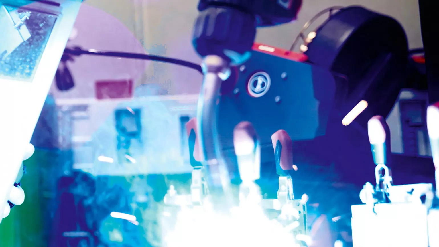

As a technician for Fronius Technical Support Austria, the Magna Group is one of my core customers. At the end of 2017, I was tasked with assisting a robot integrator. The production line for a new vehicle range was being installed. As part of this, production tolerances which could lead to a lack of fusion and in turn, greater resource expenses, needed to be addressed. All potential error sources had already been investigated when they asked me to take an outside look at the issue. I soon realized that the limits were really being tested in all areas, even in relation to our extremely tolerant arc – there was nothing more to give.
How did Fronius help solve this?
In such cases, you have to simply accept minimal deviations in the component position. These tolerances are also allowed for in the design. Nonetheless, the Magna Group is always striving to improve its production systems in all areas. So now it’s about ensuring that the robot reliably finds the edge of the upper sheet of the lap joint – despite the deviation. As I used to work in R&D at Fronius, I knew that we had carried out successful trials in the past, which used the touch signal of the intelligent TPS/i power source to search for the edge. At the time, we wondered whether the whole thing could be positioned somehow as a product for the welding market – but it wasn’t pursued. I then talked to my R&D colleagues and quickly installed a prototype at Magna.
The WireSense product is not very tangible – how can we best picture this prototype?
Magna put me in touch with the technician of the robot integrator, to whose system our wire sensor was to be connected. We then met in Magna’s production facility near Graz where we were able to complete the project work together in just one day. Basically, we integrated a specific repertoire of TPS/i signals into the robot controller. In doing so, I told the technician the time points at which the robot should activate teach mode and when the touch signal is expected. Everything else is a fairly simple, technical process.
From then on it was possible: if we stared a search operation towards the upper sheet and the touch signal was then output from the TPS/i, the edge had been detected.
