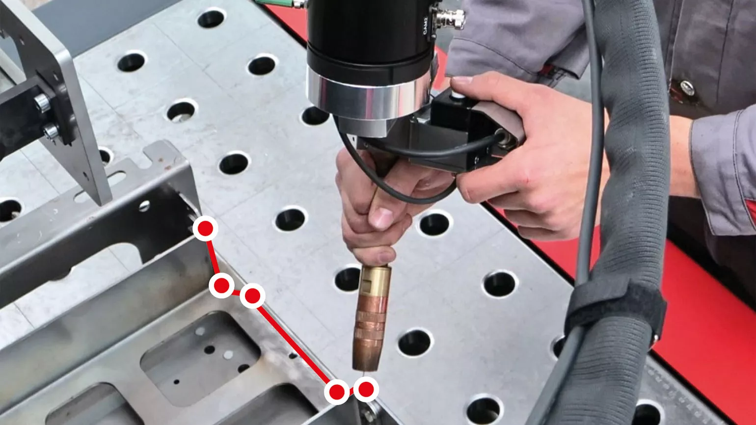

Specify the welding path at the touch of a button
The welding torch is manually guided to the starting points, position points, and end points on the component and these are confirmed by pressing a button. The software uses this information to calculate the welding contours and welding sequence, while the required welding parameters can also be selected quickly using predefined characteristics. Motion commands such as “pendulum parameters” or “weld job” can be inserted by means of dragging and dropping on the touchscreen of the Cobot control.
Before starting the welding process, the operator can simulate the welding sequence once again to detect and correct possible interference contours. Once the CWC-S is fully programmed, it welds component after component with consistent quality and at a regular speed.
