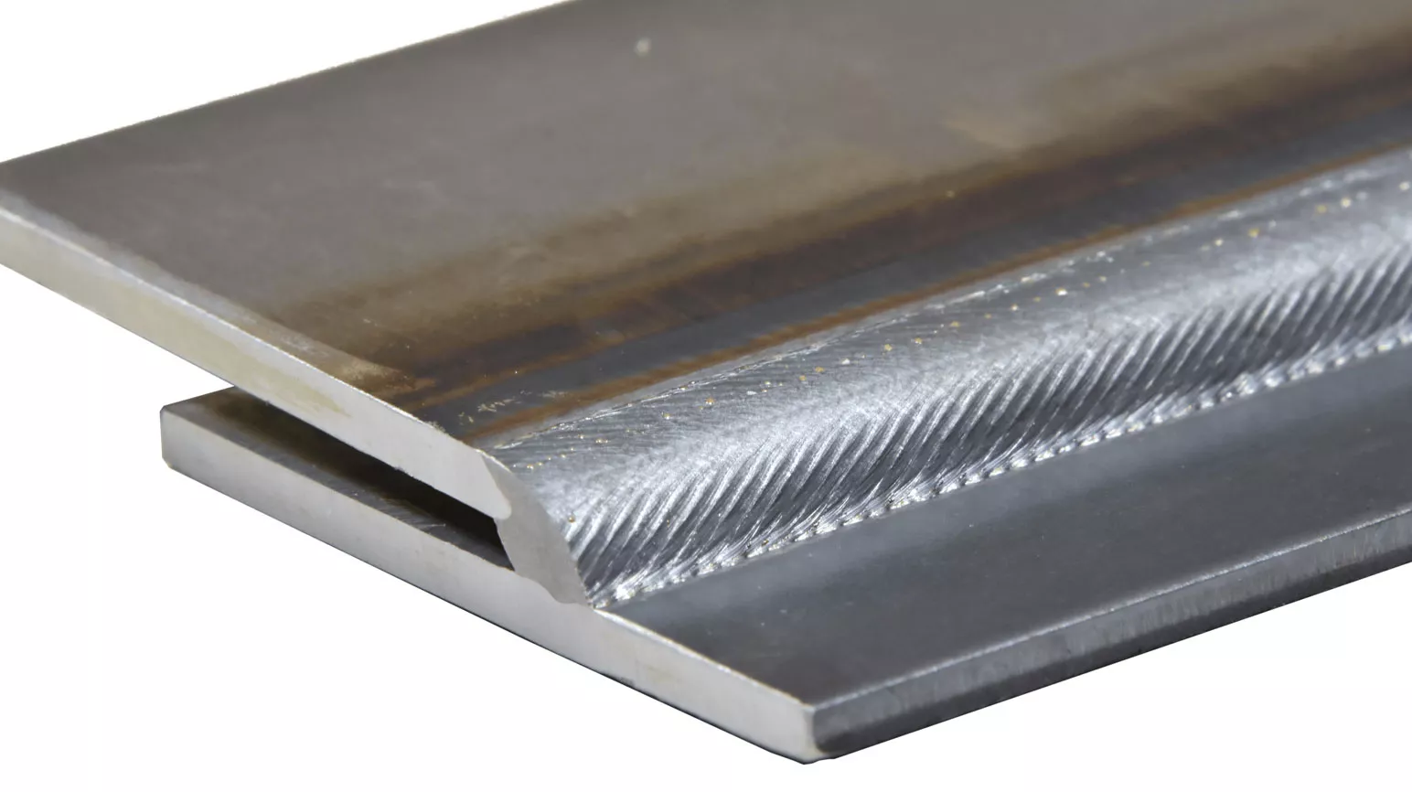

Reliably bridging air gaps
With WireSense the wire electrode becomes a height sensor, allowing air gaps to be determined on lap joints using the precisely measured sheet edge height. To achieve perfect results it is possible to specify in advance which jobs stored on the Fronius welding system should be called up for different air gap sizes. This allows the robot to always respond appropriately and weld with the welding parameters that are ideal for the air gap dimension in question, preventing welding errors and time-consuming rework.
