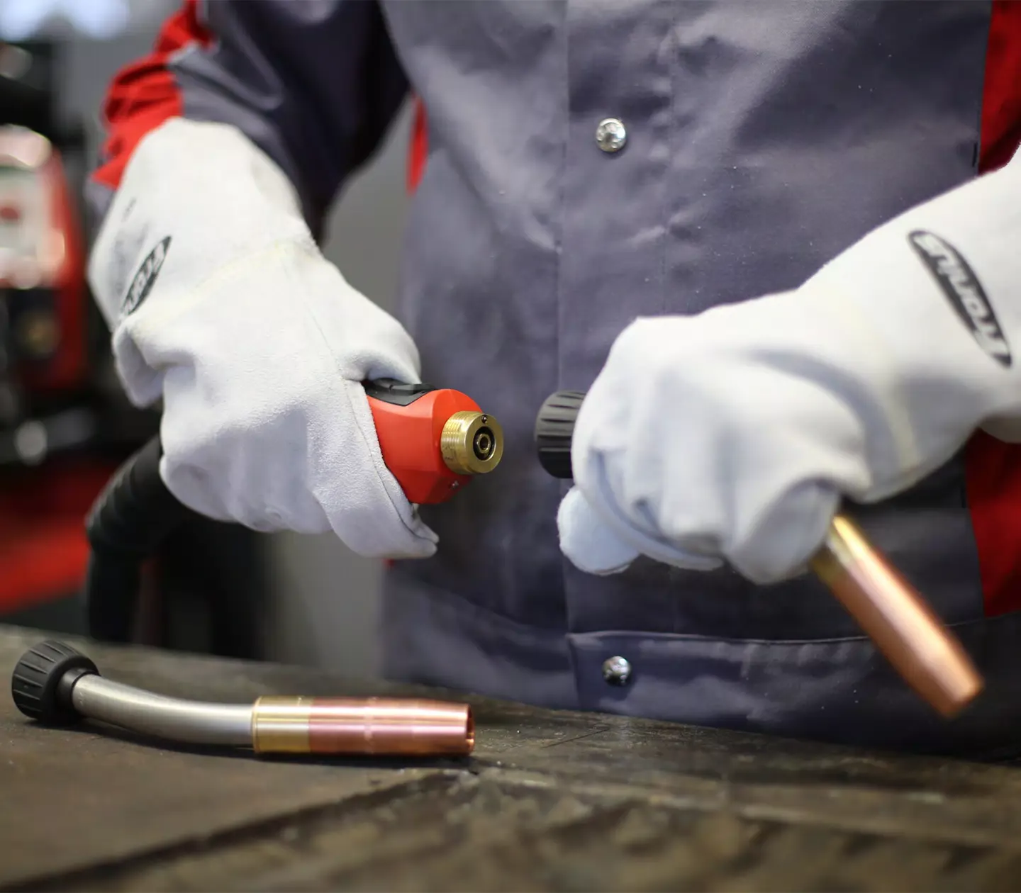

MULTILOCK - PATENTED INTERFACE
The MultiLock system enables the torch body to be changed quickly without having to replace the entire hose package. This enables flexible adaptation to the respective welding challenge.
  • 360° | The torch body can be turned through 360° to permit the greatest possible welding flexibility on components with challenging geometries.
  • | The 0° position is fixed by an antitwist device.
  • Integrated water stop | Prevents water from escaping when the torch body is removed.
