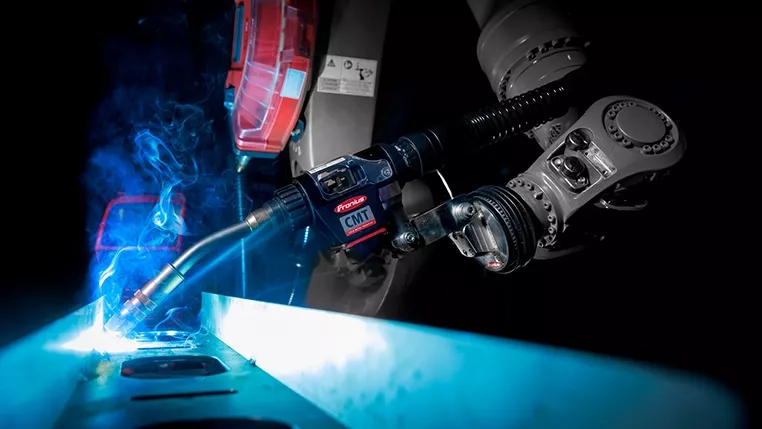

TPS/i PushPull systems These robotic welding systems ensure high process stability, especially for long wirefeeding distances and applications with aluminum alloys or CuSi.
1
WF 60i Robacta Drive CMT This highly dynamic wirefeeder supports all welding processes, from Standard to CMT. It can be used for both hollow-arm robots and conventional robots.
Touchscreen
2
Wirefeeder The wide range allows for individual positioning of the wire drum
3
Welding packages All welding processes possible: Standard, LSC, Pulse, PMC, CMT
