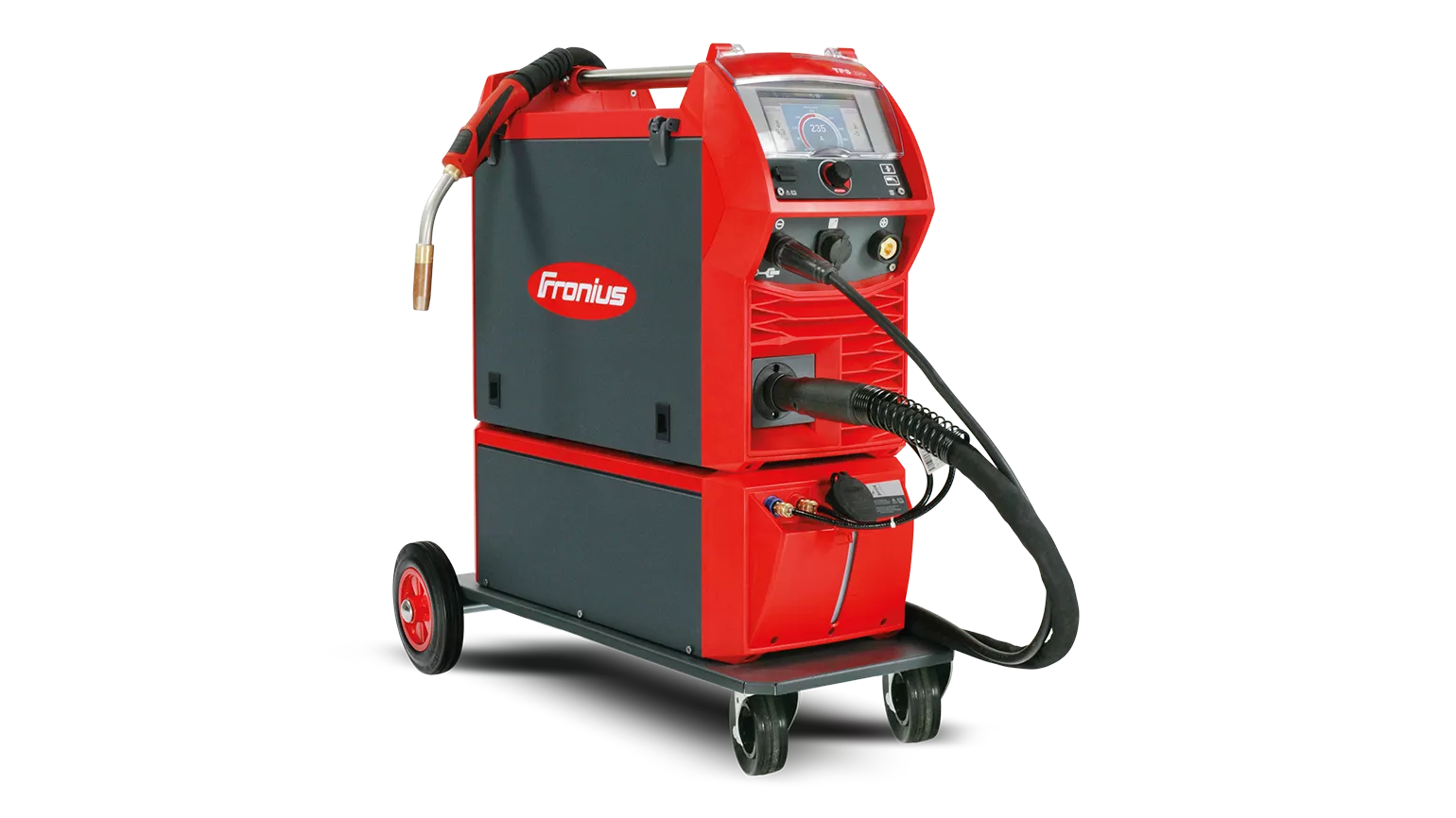

TPS/i Compact
Product details
GENERAL DATA
Mains voltage3 x 400V
Mains frequency50-60Hz
Welding current min.3 A
Welding current max.320 A
Welding current / Duty cycle [10min/40°C]320A / 40%
Welding current / Duty cycle [10min/40°C]260A / 60%
Welding current / Duty cycle [10min/40°C]220A / 100%
Open-circuit voltage71 V
Degree of protectionIP23
Length
706 mm
Width
300 mm
Height
510 mm
Weight35,8 kg
Contact
More information about the features of the TPS/i welding machine
Current firmware and software updates for the TPS/i
The trial license allows you to test all welding packages and options for some arc hours
Function overview
  TPS 270i C TPS 320i C
Mains voltage
3 x 400 V
3 x 380 – 460 V (/nc)
3 x 460 – 575 V (/S/nc)
3 x 200 – 460 V (/MV/nc)
3 x 400 V
Mains frequency 50 – 60 Hz
Cos phi 0,99
MIG/MAG welding currentrange
3 – 270 A 3 – 320 A
10 min/40°C (104°F)40% D.C 270 A 320 A
10 min/40°C (104°F)60% D.C 220 A 260 A
10 min/40°C (104°F)100% D.C 190 A 220 A
Open circuit voltage
66 V 57 V
66 V (/nc)
68 V (/S/nc)
66 V (/MV/nc)
71 V
82 V (/nc)
85 V (/S/nc)
82 V (/MV/nc)
MIG/MAG working voltage 14,2 – 27,5 V 14,2 – 30 V
Protection class IP23
Dimensions l x w x h 687 x 276 x 445 mm  706 x 300 x 510 mm
