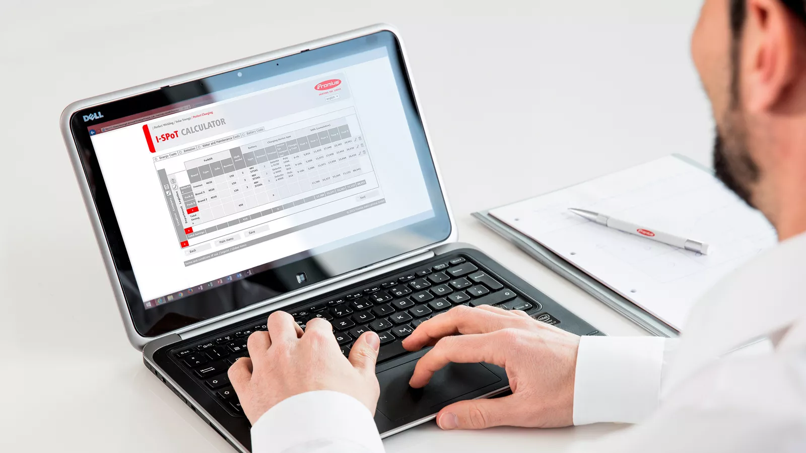

Analysis and energy consultation
Fronius also offers users a free analysis and energy consultation. Using the I-SPoT Calculator software tool, our experts calculate the total operating costs (“costs over lifetime”) and determine ways to minimise energy consumption using the Ri charging process – in detail and tailored to individual company sites and departments. This allows users to pinpoint the improvements that are most suitable for each location and the order in which to implement them.
