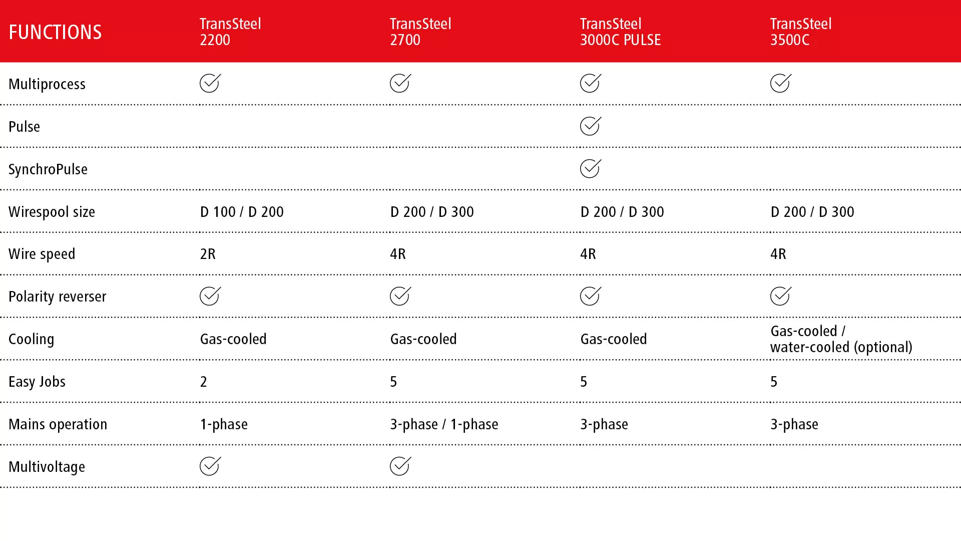

The TransSteel multiprocess series
No compromises. TransSteel Multiprocess.
One device - for all manual welding applications
Combining MIG/MAG, TIG, and electrode welding in one device means you no longer have to purchase any other power sources. There is absolutely no difference in the welding performance of the respective process compared with a dedicated device.
118 characteristics*
/ Steel, CrNi, AlMg, AlSi, Metal Cored, Rutil FCW, Basic FCW, self-shielded wires
/ 0.8 – 1.2 mm wire diameter
/ Eight different gas mixtures
Ready to weld in three steps
The intuitive operating concept enables welders to start work straight away – no prior knowledge of the device is required. All the essential welding parameters can be viewed and adjusted on the front panel. The only parameters that have to be selected before welding begins are the gas, wire diameter and material thickness.
70% less rework, 30% faster welding
The Pulse function of the TransSteel 3000C permits faster welding speeds on thicker materials. The pulsed arc also reduces the amount of rework, as less welding spatter is generated.
* Maximum number of characteristics (TransSteel 3000 C Pulse), will vary depending on the version.
