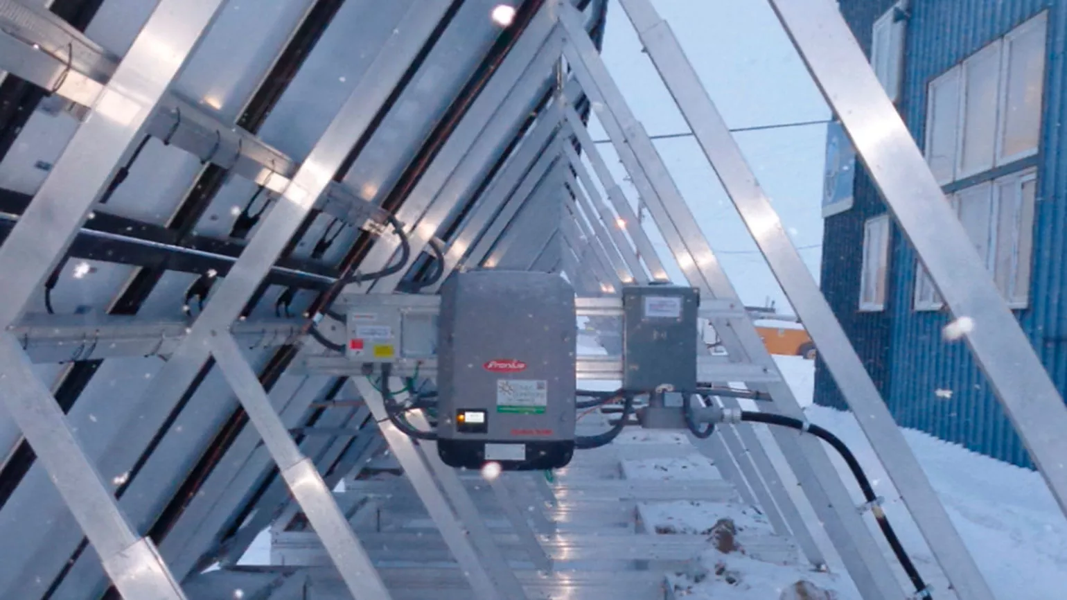

inverter in the harbour
Best PV performance in extreme conditions
Depending on the time of year, temperatures in Sachs Harbour normally range between -18°C and -37°C. Yet the Fronius Primo has once again shown that it thrives in these extreme conditions.
The inverter is designed to withstand ambient temperatures between -40°C and +55°C, meaning that it can be used in extreme conditions ranging from the Canadian Arctic to the Kalahari in Namibia.
About the system:
System size 15 kWp
System type  Free-standing system connected to MicroGrid and generator
Inverter 3 x Fronius Primo 5.0-1
Special feature  Extreme temperatures down to -37°C
