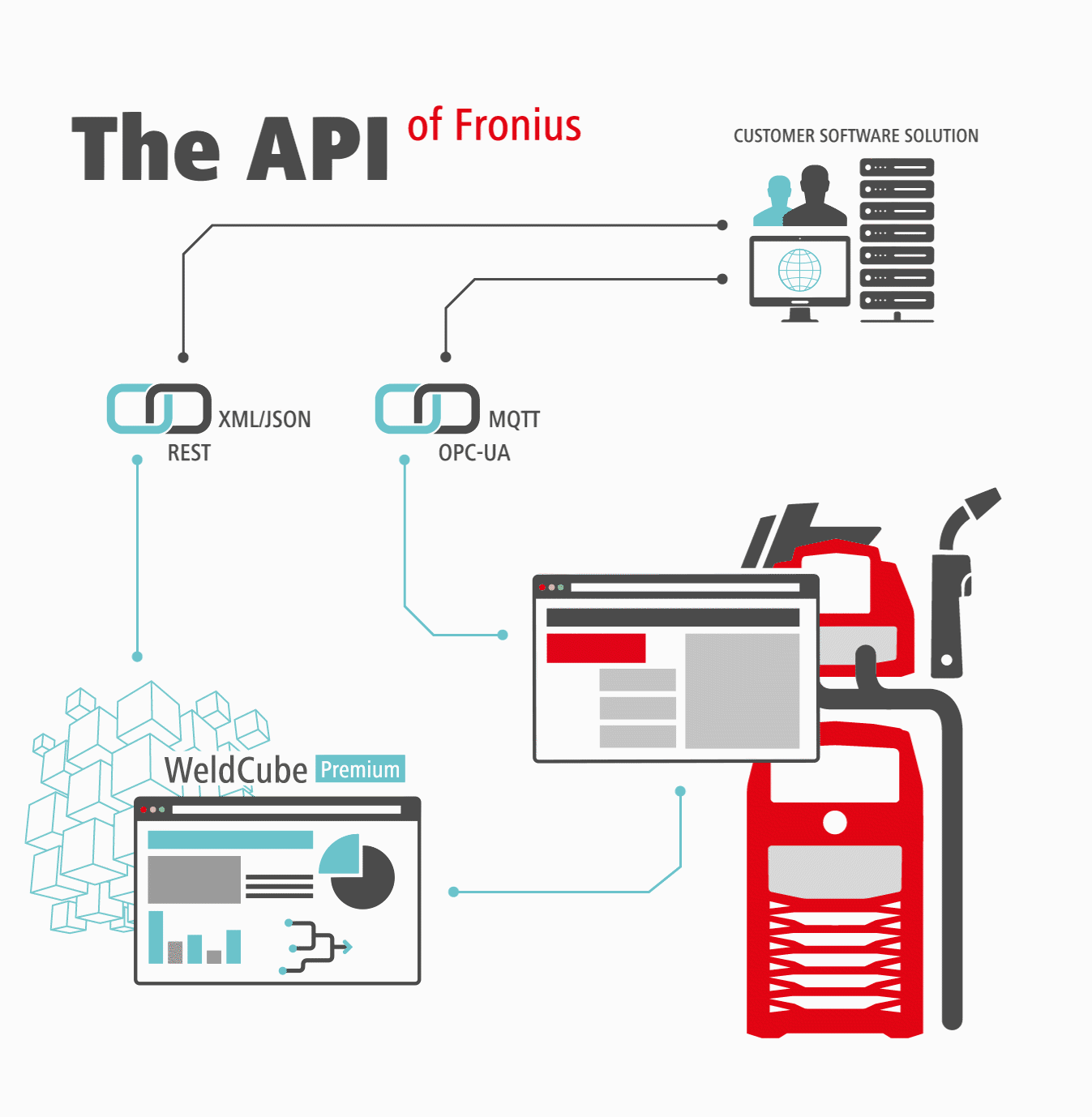

Two possible solutions depending on customer requirements
The way that the various functions of the data interfaces from the WeldCube API portfolio combine enables the fully customizable and flexible integration of Fronius power sources and WeldCube Premium into the system landscape (e.g., MES systems).
TPS/i interface solutions
The interface solutions OPC-UA* and MQTT* enable raw current data and actual states of the welding system to be readout. This makes it possible to transfer data records to thirdparty systems for independent evaluations, analyses, and visualizations. The welding system parameters can also be set via OPC‑UA.
*OPC-UA: Open Platform Communications – Unified Architecture
*MQTT: Message Queuing – Telemetry Transport
Logo MQTT and OPC UA
Interface solution for WeldCube Premium
The REST web interface in WeldCube Premium enables the analysis and transfer of prepared data. In contrast to the interface solutions OPC‑UA and MQTT, historical data can also be accessed here. In addition, this interface solution provides fixed data packets that include information on components, seams, set values, jobs, and machines.
Logo of Rest-API
   MQTT OPC UA REST:API
Read live process parameters  X  X
Write process parameters    X
Read aggregated, collected, historical data      X
