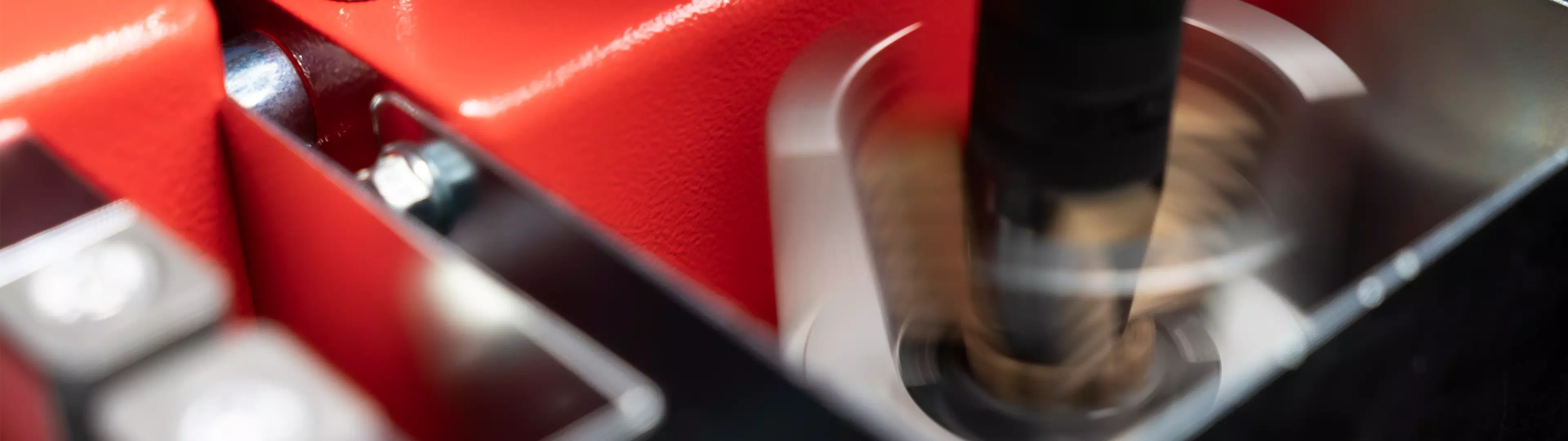

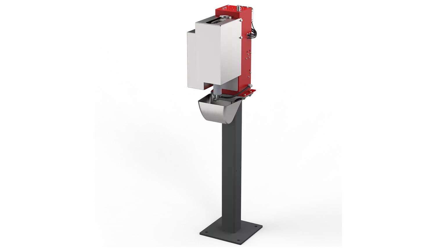

Mechanical cleaning using milling cutter
The mechanical torch cleaner for steel applications is available in three versions: Robacta Reamer V Easy, Robacta Reamer V Comfort, and Robacta Reamer Single/Twin.

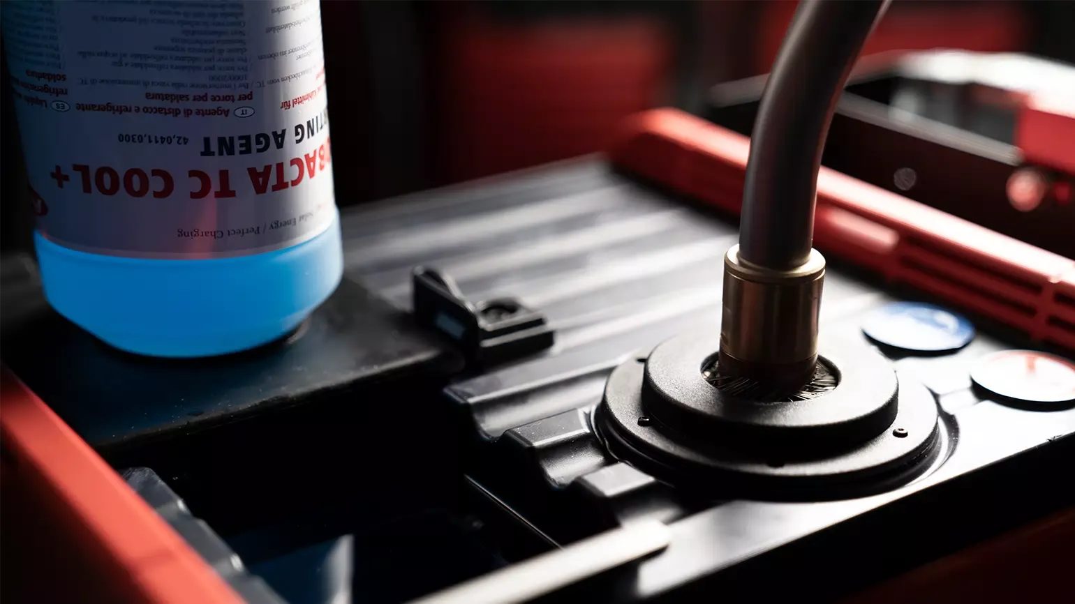

During milling cutter cleaning, the gas nozzle is cleaned of steel spatter on the end face and inside. To increase the service life, a parting agent can be used after milling to protect the gas nozzle from contamination. This supports the cleaning effect by reducing spatter adhesion during welding. As a result, the gas nozzle will be easier to clean in the future.

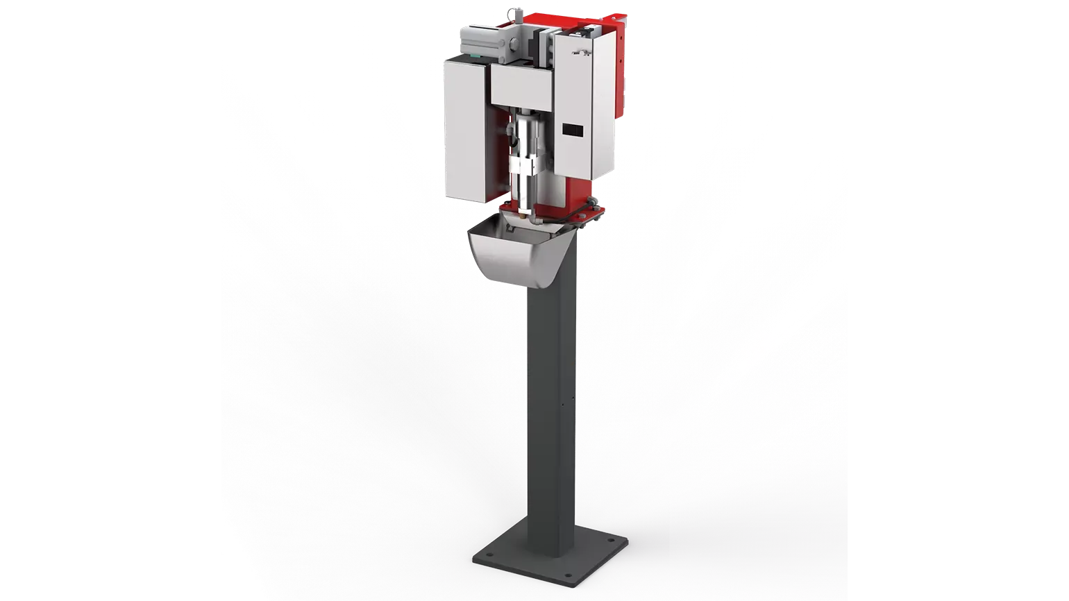

  • Mechanical cleaning using milling cutter
  • Cleaning time of 3–5 seconds
  • Milling cutter specifically targets wear parts when applying parting agent
  • Saves time by cleaning and spraying in one position
  • Dirt discharge into collection vessel
  • Robot probe for checking the TCP
  • Optional: electric wire cutter, various cleaning cutters, gas flow control

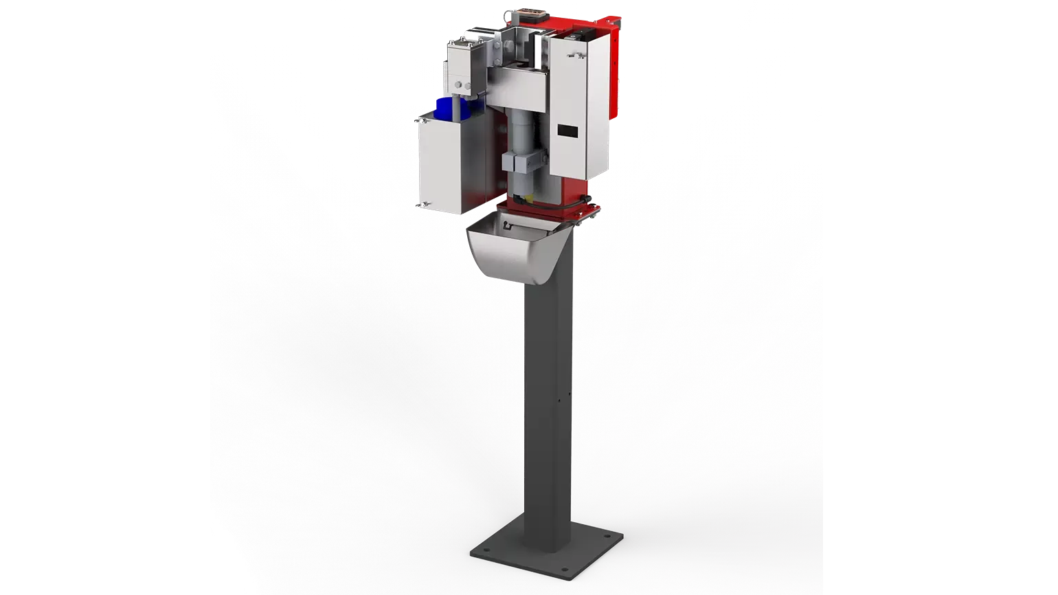

  • Cleaning time of 4.5–6 seconds
  • Parting agent is specifically applied to wear parts via a separate, sealed unit that prevents contamination of the robot cell
  • Level sensor for cleaning fluid
  • Separate collecting container for parting agent residues reduces contamination in the robot cell
  • Integrated TCP check: Detection of TCP displacement and contact tip wear via TCP Touch Sense
  • Optional: electric wire cutter, various cleaning cutters, possibility of additional sensors (e.g., wire end sensor), gas flow control

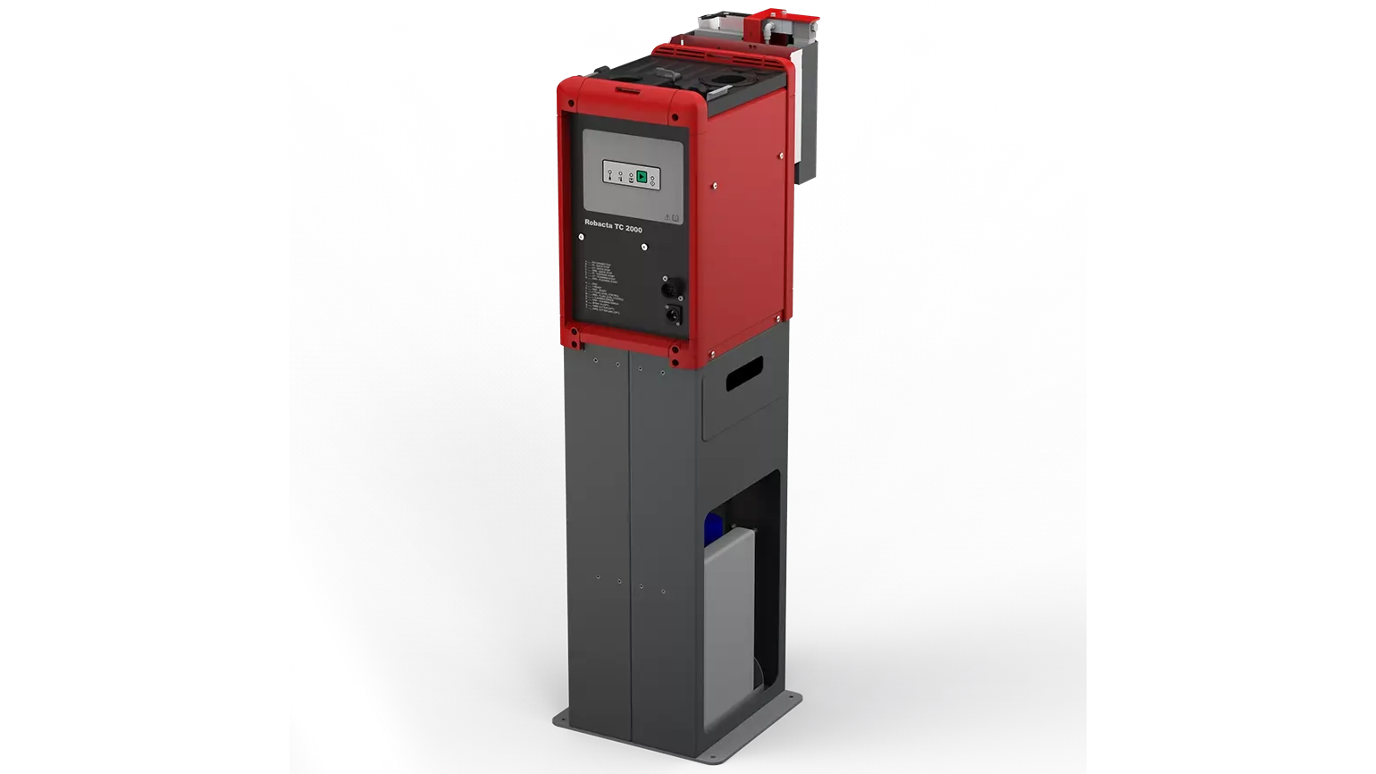

Magnetic cleaning for steel applications
No contact required: During magnetic cleaning, the welding torch is magnetically cleaned without contact. This method does not affect the TCP, ensuring that the welding wire is precisely positioned. Plus, wear part surfaces are not damaged, as any spatter that accumulates is removed electromagnetically.
Robacta TC 2000 / TC 2000 Twin
  • Contactless magnetic cleaning
  • Cleaning time of 0.5 seconds
  • TCP is not affected
  • Service life of gas nozzle is ten times longer compared with mechanical cleaning, since wear part surfaces are not damaged
  • Available for practically all torch geometries and gas nozzle shapes
  • Parting agent vessel with level monitoring and automatic refilling
  • Cleaning possible from 20 seconds charging time
  • 50 seconds charging time until maximum magnetic flux density is available for the cleaning process
  • Collecting container for welding residues
  • ­Four different coils: 30 mm, 35 mm, Twin, LaserHybrid
