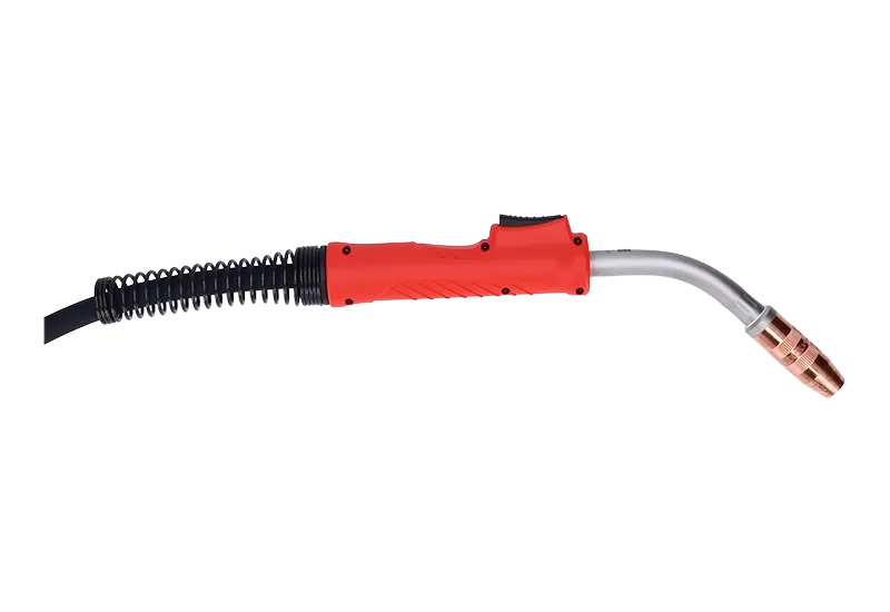

MTG 2500S
Welding current (ArCO2)
  • MIG/MAG 40/100% D.C.: 230/170 A
  • Wire diameter: 0.8–1.2 mm
  • Hosepack length: 3.5/4.5 m

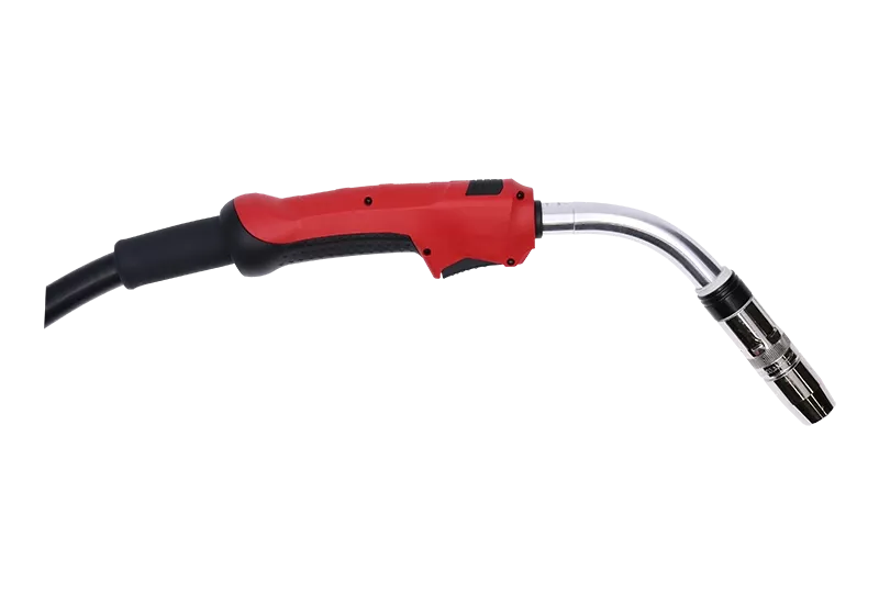

MTG 2100S
  • MIG/MAG 40/100% D.C.: 190/140 A
