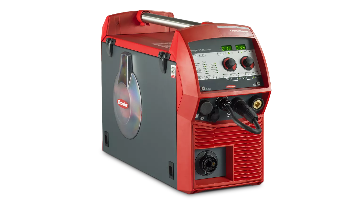

TransSteel Compact
No matter what the welding task - MIG/MAG, TIG and electrode welding with just one device.
Whether a construction site or a workshop, from agricultural enterprises to metalworking companies – for assembly, repair, and maintenance work, the TransSteel Multiprocess series masters the MIG/MAG, TIG, and electrode welding processes to professional levels.
Like all Multiprocess welding systems from Fronius, the TransSteel 2700 is ready for use in just three steps: select the wire, wire diameter and gas and start welding. You can switch between the individual welding processes in 60 seconds. In addition, the TransSteel can be used as a single-phase device up to 220A (TIG).

The TransSteel multiprocess series
No compromises. TransSteel Multiprocess.
One device - for all manual welding applications
Combining MIG/MAG, TIG, and electrode welding in one device means you no longer have to purchase any other power sources. There is absolutely no difference in the welding performance of the respective process compared with a dedicated device.
