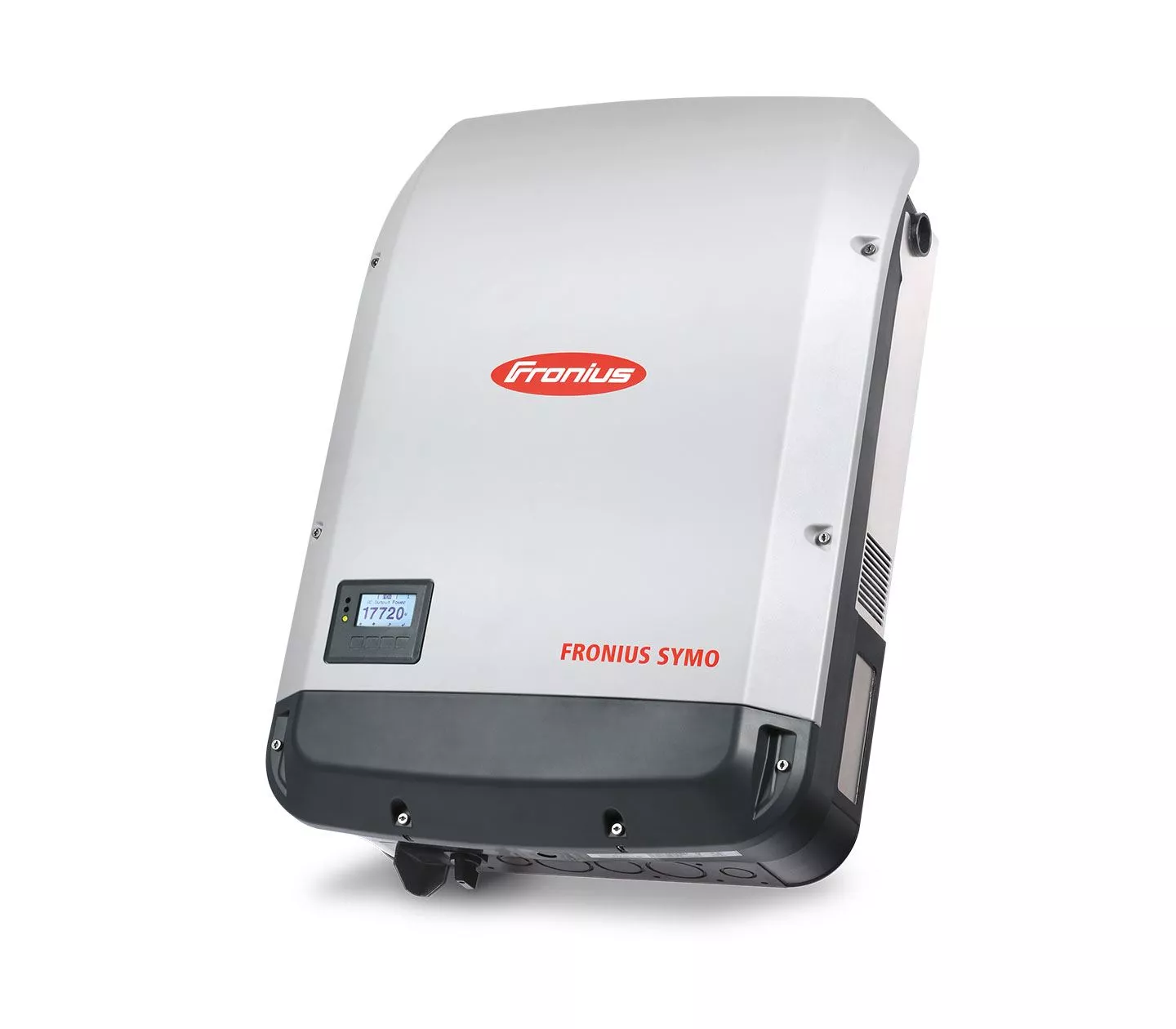

  • The Fronius Symo is a compact and flexible inverter that can be used to implement even complex system plans.
  • The Fronius Eco enables highly cost-optimized, economically viable PV systems to be implemented.
  • Fronius Symo Advanced and Primo UL cover all requirements that arise in countries with special grid configurations.

Fronius Symo Advanced with arc guard technology
Further developed with safety in mind: the Fronius Symo Advanced opens the next chapter in the Fronius SnapINverter portfolio. The inverter stands for maximum safety with integrated arc protection and maximum yield.
As the latest highlight, the Fronius SnapINverter inverter with Fronius Arc Guard technology offers reliable protection against arcs that can cause fires. The integrated arc protection not only ensures energy self-sufficiency, but also protects the investment.
With its comprehensive equipment, the Fronius Symo Advanced exceeds even the highest standards. It is also available in various power categories ranging from 10 to 20 kW and is therefore the future-proof choice for commercial photovoltaic systems of all sizes. Rely on proven performance with new safety technology.
Fronius Symo Advanced. Designed to rely on.
