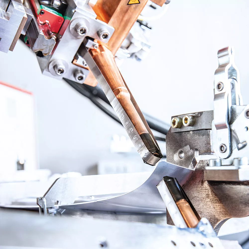

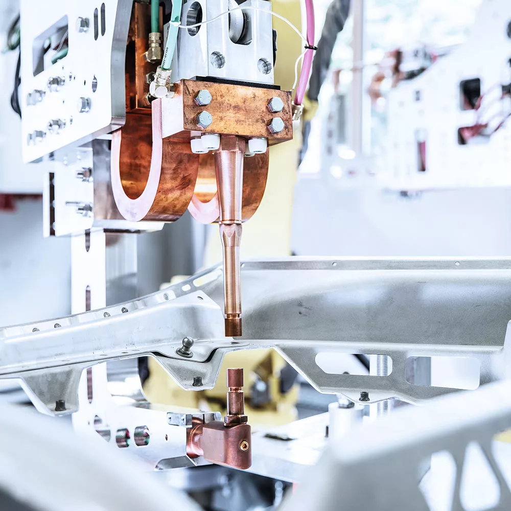

DeltaCon
The gun for conventional spot welding was specially developed to be used with aluminum. In comparison to steel, aluminum has a lower level resistance, which means higher forces and amperages are required to join the materials. Due to the high degree of automation, the system is suitable for every production line.
DeltaSpot
The spot welding system with continuous process tape is a unique global innovation and perfectly suited to joining steel and aluminum, as well as thin sheets and multiple sheets. The system is ideal for workpieces that require a high number of welding spots, as the DeltaSpot can weld up to 7,000 spots without interruption. This has a particularly positive effect on the cycle time.
